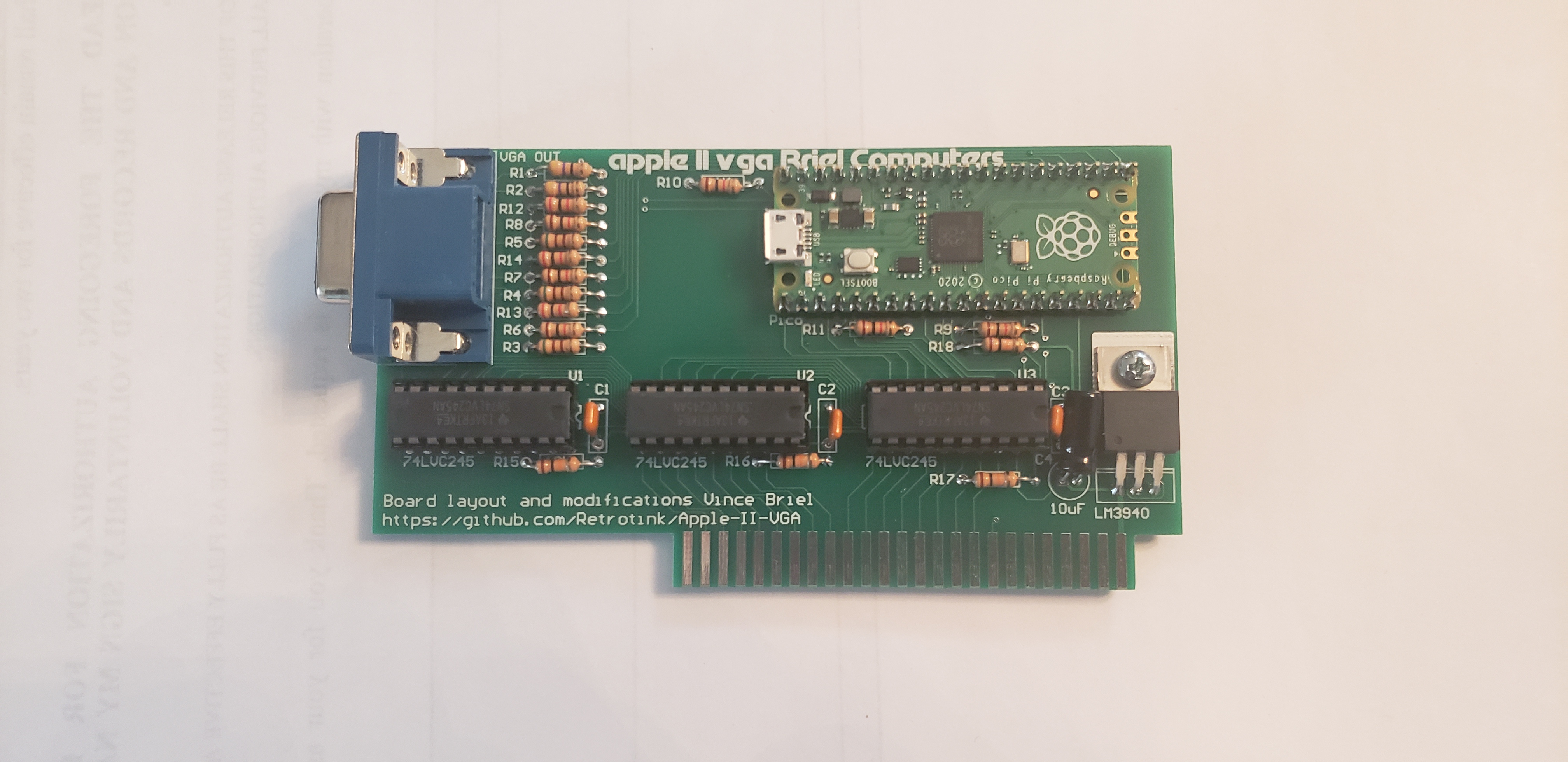

Yes, it is different and it emulates the 65C02 CPU @ ~3.7-MHz but I wouldn't mind checking it out. It looks like a reasonably economical build. I just ordered a set of PCB's (I got a few Pico's at a $2 introductory price from Micro Center when they first came out).
Speaking of RP2040 projects, I also just ordered a couple blank Apple II VGA PCB's.
