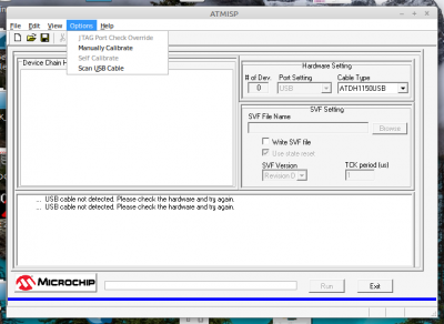

Start ATMISP
Click on "Options", then "JTAG Port check override" (this is supposed to stop ATMISP from checking if their programmer is present)
ATMISP window (port override)

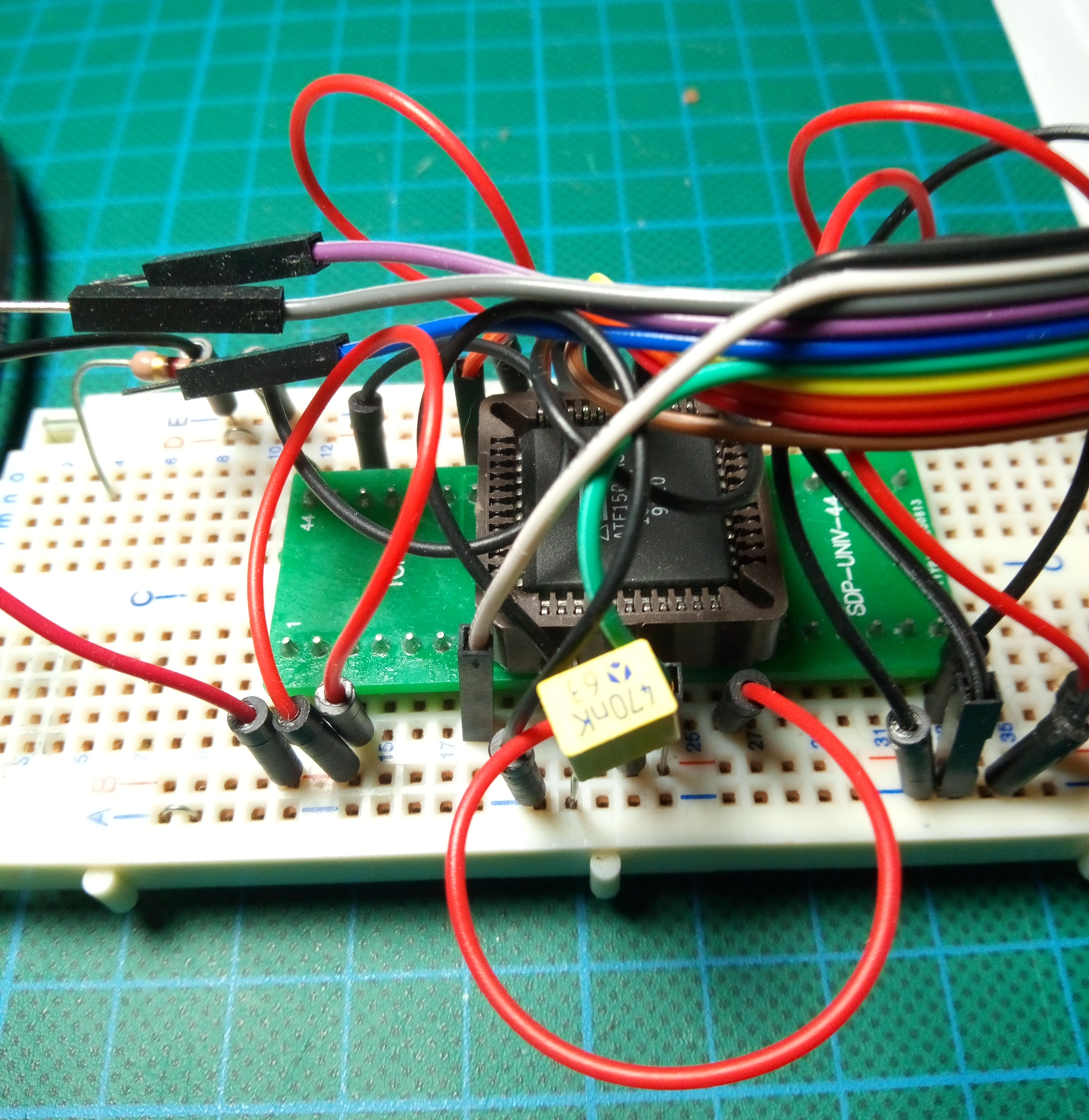

Before going any further, we now need to talk nuts'n'bolts : we need to connect to our device-to-be-programmed...
There are many development CPLD boards out there, many of which are compatible with the Atmel/Microchip devices.
I already have far too many development boards for far too many different architectures, so I just bought a simple 44-pin breakout from the usual chinese supplier. It has to be wired with power supply and the JTAG signals, but it's not too busy for a breadboard ;
Rats nest
Rats nest

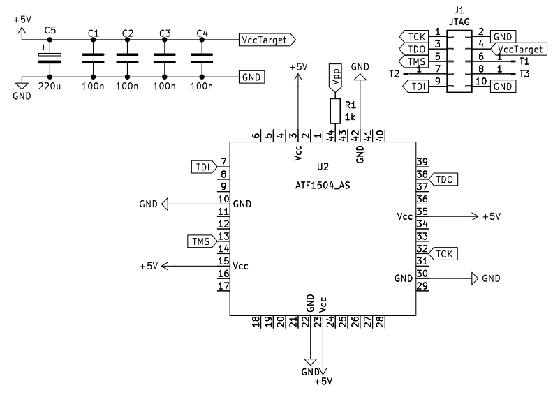

The JTAG signals from/to the USB Blaster are better seen on this schematic :
Connections
Connections
The 10-pin connector is the connection to the USB Blaster.
When wiring your breadboard (or designing your own breakout/dev board), DO :
  • wire ALL of the Vcc and GND pins of the device;
  • add some decoupling capacitors and perhaps a larger filter capacitor;

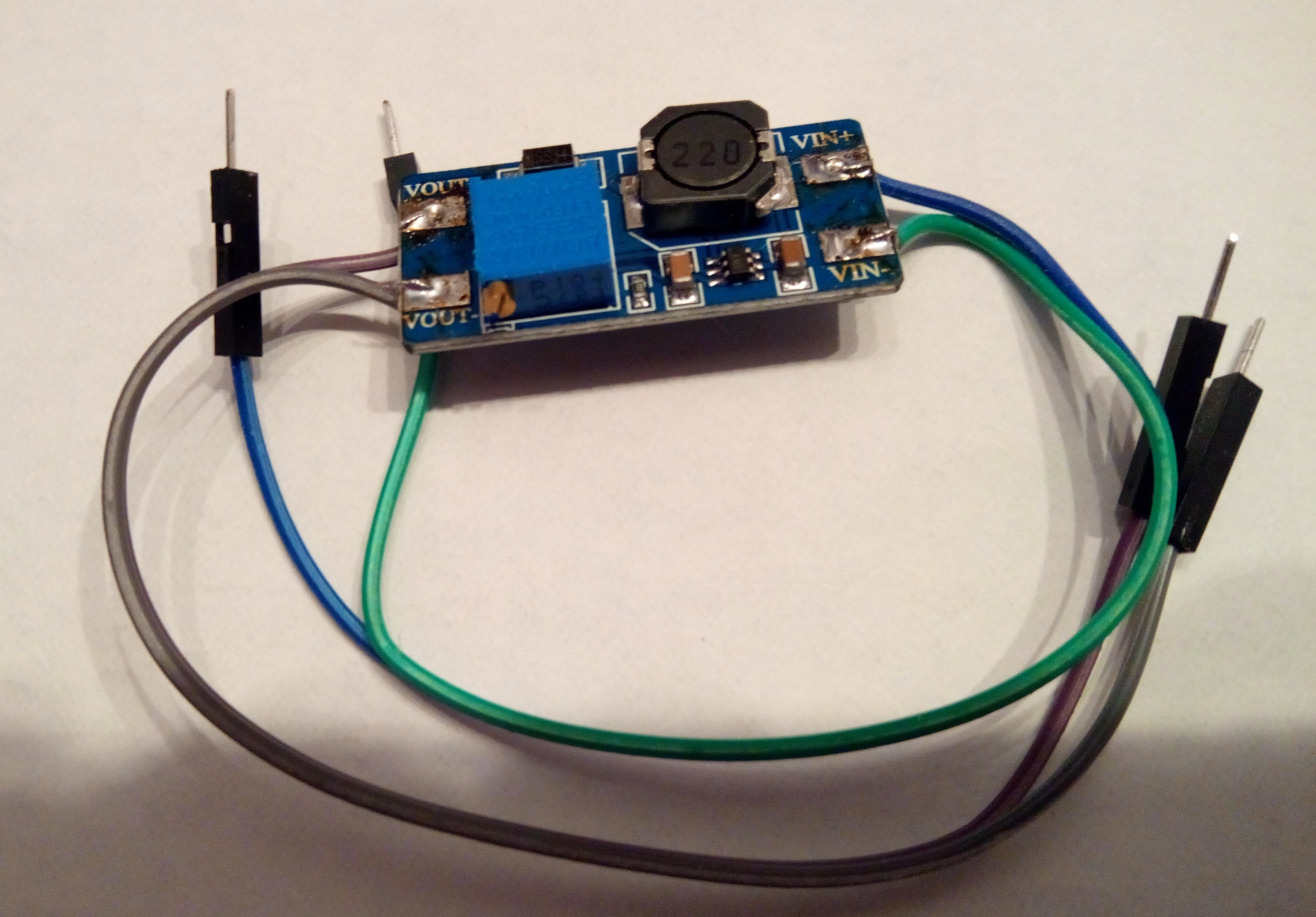

If, like me, you buy your first 'victims' from the same chinese supplier 'cos they're very cheap - you'll invariably find that they refuse to be programmed or even identified. Don't bin them just yet. They are most probably read/write protected (or have the JEDEC pins reprogrammed for 'user' functions). They can be unprotected simply by applying a 'programming' voltage on one special pin. The pin is refernced "Vpp" on the above schematic. For the ATF150n series, the programming voltage is 12v. Be warned, if you apply 12v to ANY OTHER PIN of your device, you'll most probably let the smoke out of the box. Keep the 12v Vpp applied and you should find that the device will be properly identified. Sometimes there's an extra surprise : the device's ID doesn't match the printing on the chip!
A simple way of providing a suitable 12v on your spaghetti-board is to use an MT3608 step-up module, like this :
12v module
12v module
The input is your 5v (Vcc), you adjust the output to be 12v, and you can hot plug/unplug the 12v pin easily on the breadboard.
If your design leaves the JEDEC special pins unattributed, you should only need to unlock the device once.
IMPORTANT NOTES :
  • ALWAYS use a series resistor - any value between 1k and 10k will work;
  • ALWAYS respect the following sequence for applying the 12v :
    Startup : apply 5v power; apply 12v Vpp; do any programming.
    Shutdown : remove 12v Vpp; remove 5v power.

@cbscope
I'm stuck with ATMISP not starting, it says FTD2xx.dll missing.
Did you get past that hurdle? I'm assuming that it's looking for the USB driver, but I'm not sure where you should pick it up from - unless it's the "standard" FTD232 driver? I have so many things running under wine on my system I don't really know where any of the DLLs came from.
Glenn-in-France

No I had no success. I also tried to manually install the FTDI drivers for Windows on ARM. Now the JTAG programmer ATDH1150USB is recognized and the drivers are loaded, but ATMISP still exits with the message FTD2xx.dll missing. I have contacted microchip support and they will look into the issue. It is really the last missing piece in order to be able to migrate everything to my M3 notebook. As a workaround I still have a MacBook Pro with an Intel with bootcamp. I even managed to get W10 running in a emulated i86 VM in UTM on my M3 but it is extremely slow. I‘m also still looking into a command line solution to create svf files, unfortunately the chn file does not allow to save svf as output, so using atmisp as commandline does not work. I let you know when I have an answer from microchip.

@cbscpe, and just for completeness: on a different thread,
akohlbecker said :
I did have some trouble initially with FTDI drivers, but putting the FTD2XX.DLL file found in this archive https://ftdichip.com/wp-content/uploads ... utable.zip inside the ATMISP directory made it work. I did have to use the one from the "x86" folder.
Glenn-in-France

GlennSmith wrote:
@cbscpe
Microchip stated that I should use the standard FTDI drivers and manually install them as it is required for Windows 11 on ARM and described in the document from FTDI. After that the JTAG programmer is recognized as USB device and the drivers are loaded, however ATMISP still refuses to start as it does not find the ftd2xx.dll. Alan from Microchip asked me to make some tests and create some screenshot. I also told him, that the FTDI standard drivers for Windows 11 on ARM do not include the 32 to 64 bit bridge DLL (typically located in c:\windows\SysWOW64) in order to allow 32 bit applications to access USB devices on a 64 bit OS (and Windows 11 on ARM is 64 bit only), he promised to get back, but I haven't heard anything from him since about a week. I will ping him.
Also I will try the project bureau scripts that translate the .JED into a .SVF. These are python scripts. And then I will try to play the SVF file via openecd to program an ATF1504. If this works I would no longer need ATMISP, next week I should find some time to test this.
