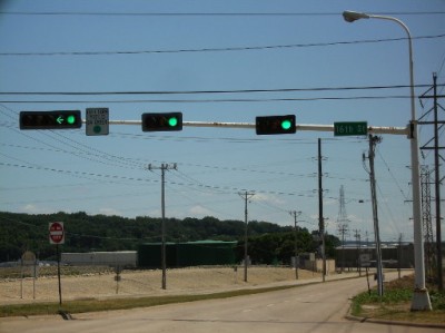

A few years ago I visited extended family in a different state that had a lot of these, and I thought what if someone is red-green colorblind and left-right dyslexic too! (I know almost nothing about dyslexia, but my wife is a teacher and has had kids who had trouble with b and d, and p and q.)

Texas is one of the states which have adopted the horizontal arrangement for traffic signals. Most of the cities have given in to current state DOT standards.
It has been decades since I had to take defensive driving, I should go and do it for a discount on today's high auto insurance rates, but I hate to forfeit that "get out of jail free" card, but I digress...
I suppose a useful mnemonic device is rightmost light means you have the right of way.
The problem I have is the current fetish for flashing yellow arrow instead of a solid green light for left turn permitted but yield to oncoming traffic. A solid yellow light or solid yellow arrow is the warning that the red is coming. It is difficult to tell at a glance whether the yellow is flashing or solid so they install two yellow arrows, one flashing and one solid. But some intersections have a combination of red, flashing yellow and solid green arrow, sometimes more than one of them at the increasing number of intersections with multiple left-turn lanes.
I am just thankful that Texas has banned red-light enforcement cameras. I got dinged once for turning on red because I misjudged which yellow was lit.
