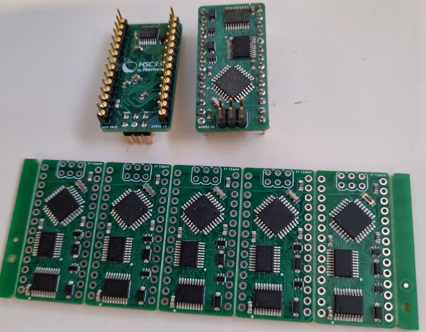

Hi,
a little contribution to this supertech community, my personal solution to ACIA and I2C/SPI with 65C02.
It's a DIL28 stamp circuit, 65C51 pinout compatible with following resources:
- one AtMega328PB microprocessor, running at 18.432 Mhz
- one 8 bit latch written from 65C02 , as data register for TX operation
- one 8 bit latch written from AtMega328 , as data register for RX operation
- some logic to allow 65C02 IRQ or NMI operations or polled operation
- one RS232 port of AtMega328 on native pins of 65C51 (pin 10 and 12)
- one further RS232 port of AtMega328 on pins normaly connected to level traslator as RTS/CTS (pin 8 and 9); alternatively should be used as part of SPI connection
- one I2C port of AtMega328 wired on pins 7 and 11
Local AtMega should be used to process communications service as coprocessor..
Enclosed EAGLE files (compatible with free version) and picture of board.
AVR51_v1-2.pdf [89.08 KiB]
Downloaded 64 times

Very nice! I'll have a look as I am investigating a method to connect an atmel avr to a 6502 bus. We may have had the same ideas.
Can you attach screenshots of the schematics as well? I do have eagle, but not really handy eg on my phone now!

André,
attachment of first post is in pdf format, let me know if you are able to read it.

Thanks I only saw the image not the pdf.
Why are you useing '373 latches?
I either use '273 - which are to my knowledge the only ones with /RES or '374/'574 (IIRC) registers. I know chances are very low but latches like the '373 can change while 'open' which can lead to potentially inconsistent values.
Again, chances are low but I like to look at such details ;-)
Thanks again for sharing!
