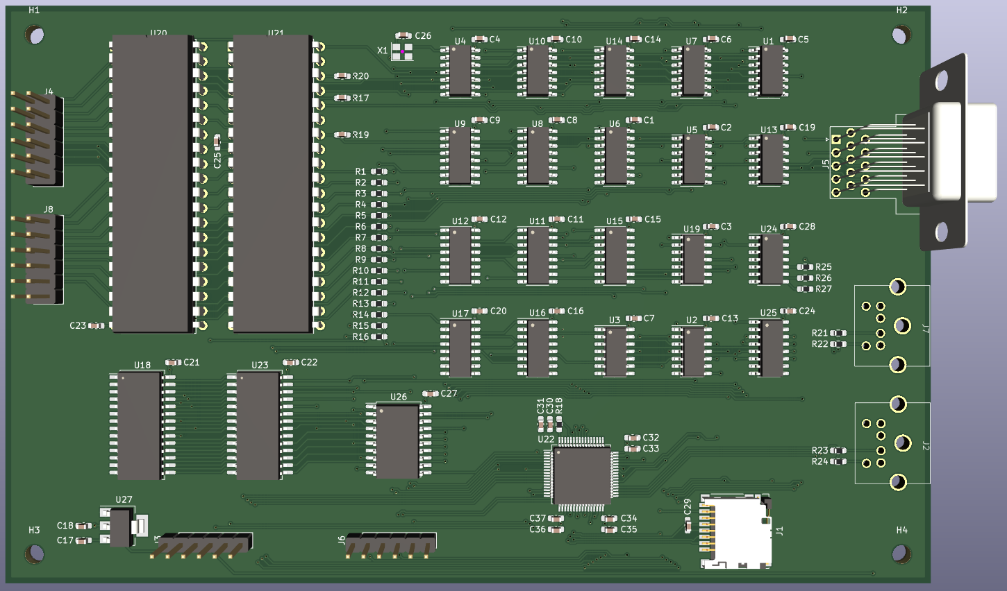

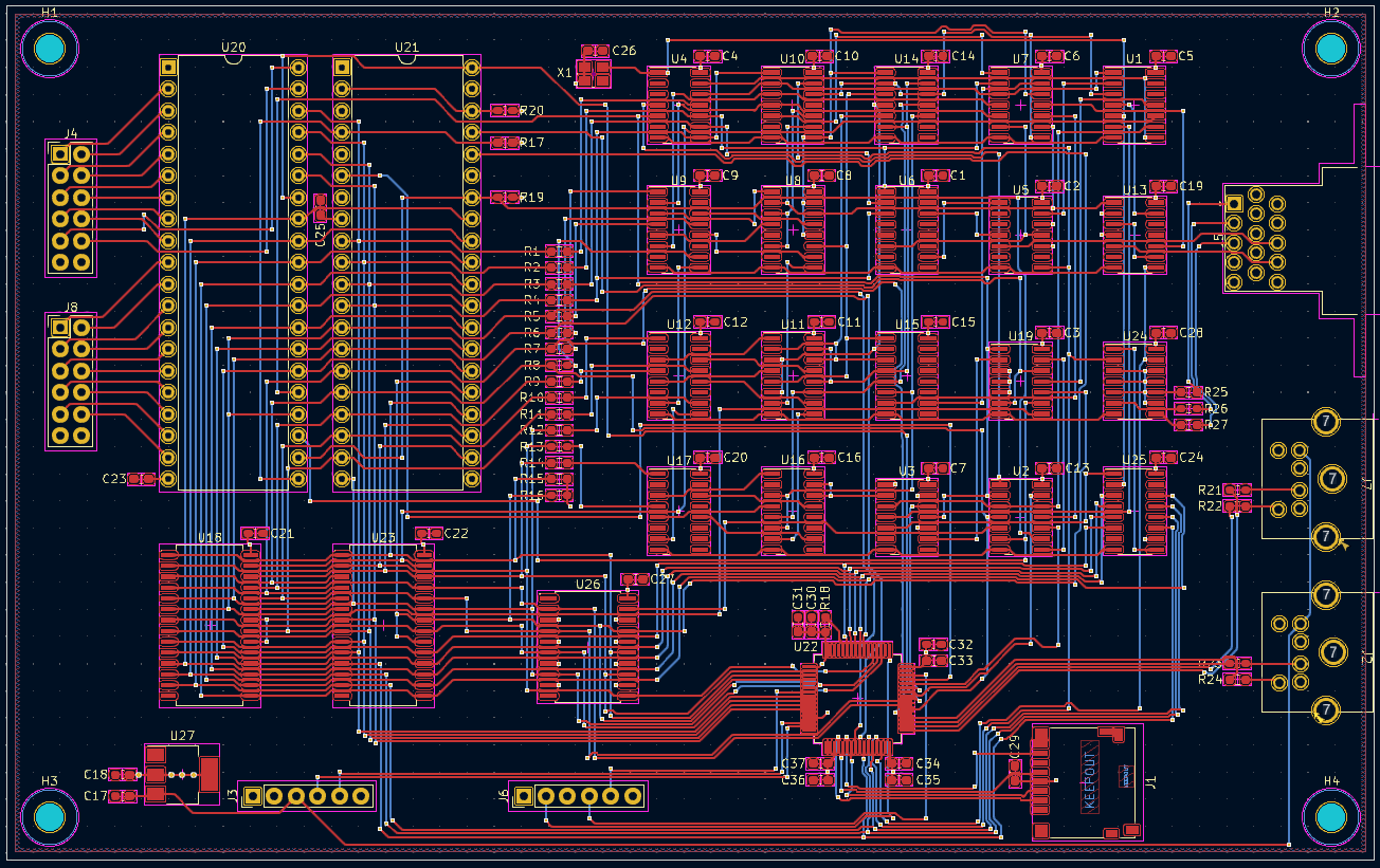

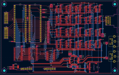

My word, this has turned out to be a busy board: 160x100mm
Same board, looks a bit cleaner in the 3d render when you can't see all the gory details:
This needs some prototype testing before I order the boards; there a lot going on (most detailed in previous posts):
  • 2.5MHz 65c02 + 65c22
  • 64k RAM (except for 128 bytes at 0xff00 for the 65c22)
  • 384 x 300 pixel addressed SVGA video output
  • DMA interface to an STM32L073 providing serial UART, PS/2 mouse and keyboard, and microSD filesystem
Most of this is still wishlist, but I'll start writing software once I have the rest of the system up. Also there's still some work to do labelling things on the PCB, but I'm away from home for a couple of weeks so it'll have to wait.

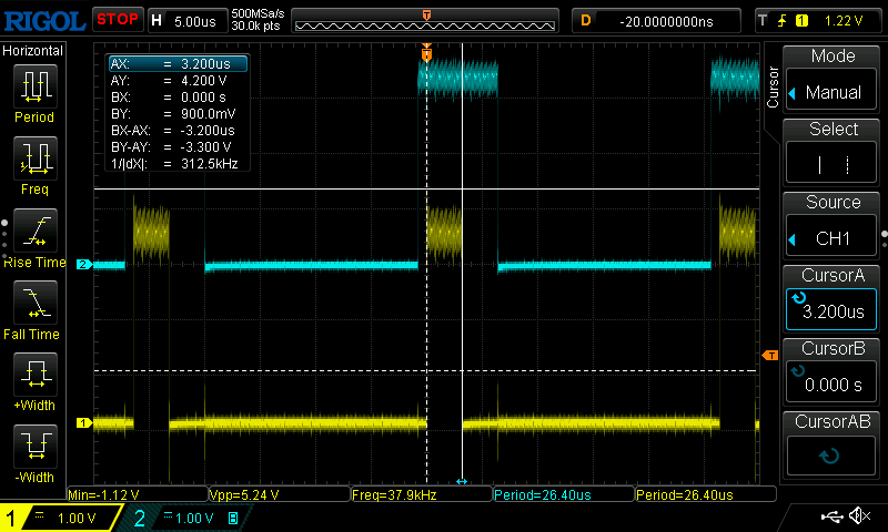

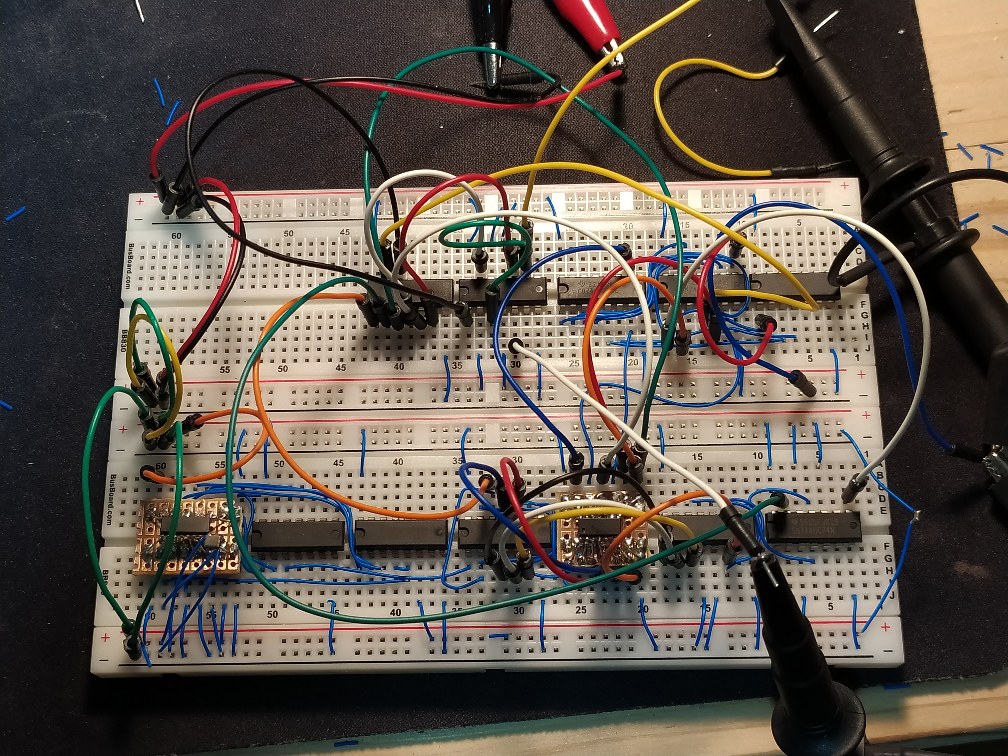

Well, in between painting this, and laying a floor that, and carrying boxes the other... I managed to knock together a little bit of test hardware. And, woohoo, the SVGA line timing works and is spot on... though the circuit looks like it was put together by an inebriated spider...

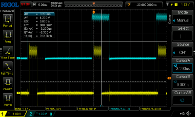

Line sync is 3.2us:

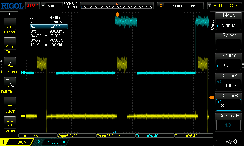

Line blanking is a touch longer than spec; I'm using only 384 of my 400 horizontal pixels:

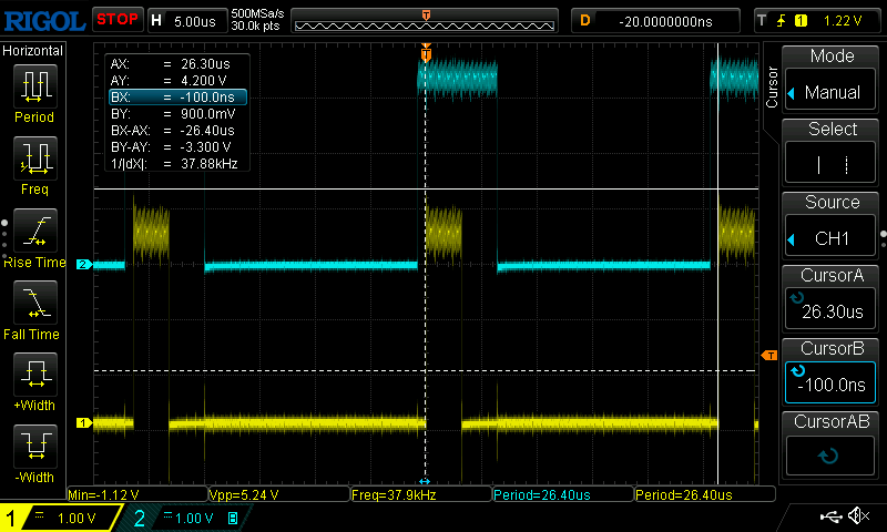

And the line timing is exactly 26.4us:
All this in just six and a bit chips (there's a seventh chip in there to generate the load pulse for the parallel to serial chip, but I didn't count that :) ) and it's perhaps interesting in that it uses - after the initial 20MHz tp 2.5MHz divider - ripple counters and decoders. The count always increments in such a way that there aren't any glitches that affect the outputs.
The field generator works in a similar, but not identical, way, so that's next to check if it fits on the board.

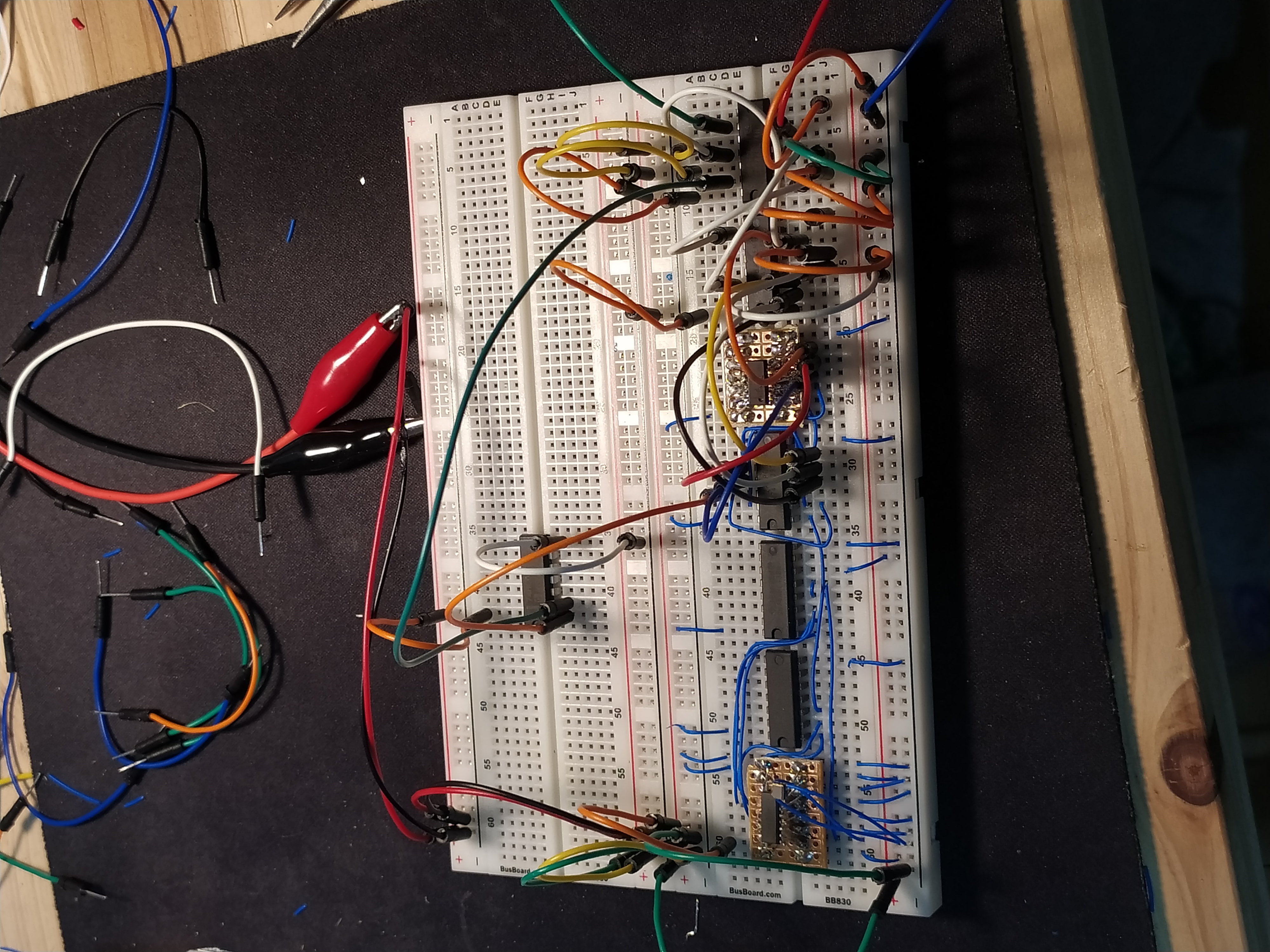

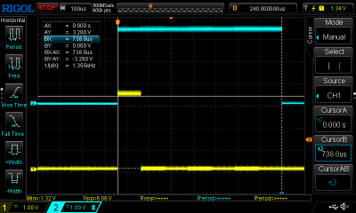

Have I mentioned how much I like prototype boards? Spent half a day yesterday trying to track down what looks like a floating input - signals moving with respect to each other at mains-like frequencies - before giving up in disgust... and today I just turned it on and it's working perfectly... :shock: :evil:
It's not pretty, though...

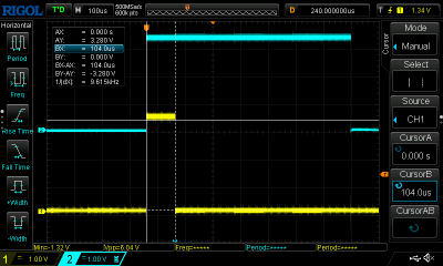

But the field sync and blanking are correct as close as the scope will measure at this resolution, with the exception that the sync pulse occurs one line earlier than it should to simplify the design (there should be one line of front porch after the active field ends).
Next step is to see if this will actually drive a flatscreen that's supposed to accept it. After that - I found a couple of 166's while tidying up to move next door, so I need to confirm to myself whether they latch on the edge. If they do, the circuit gets a lot simpler: I can lose two chips and use the spare second half of a timer. And at present, the board is quite complex enough, thank you; just under five hundred connections in the rat's nest.

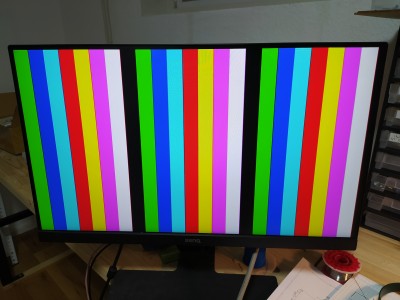

Woohoo!

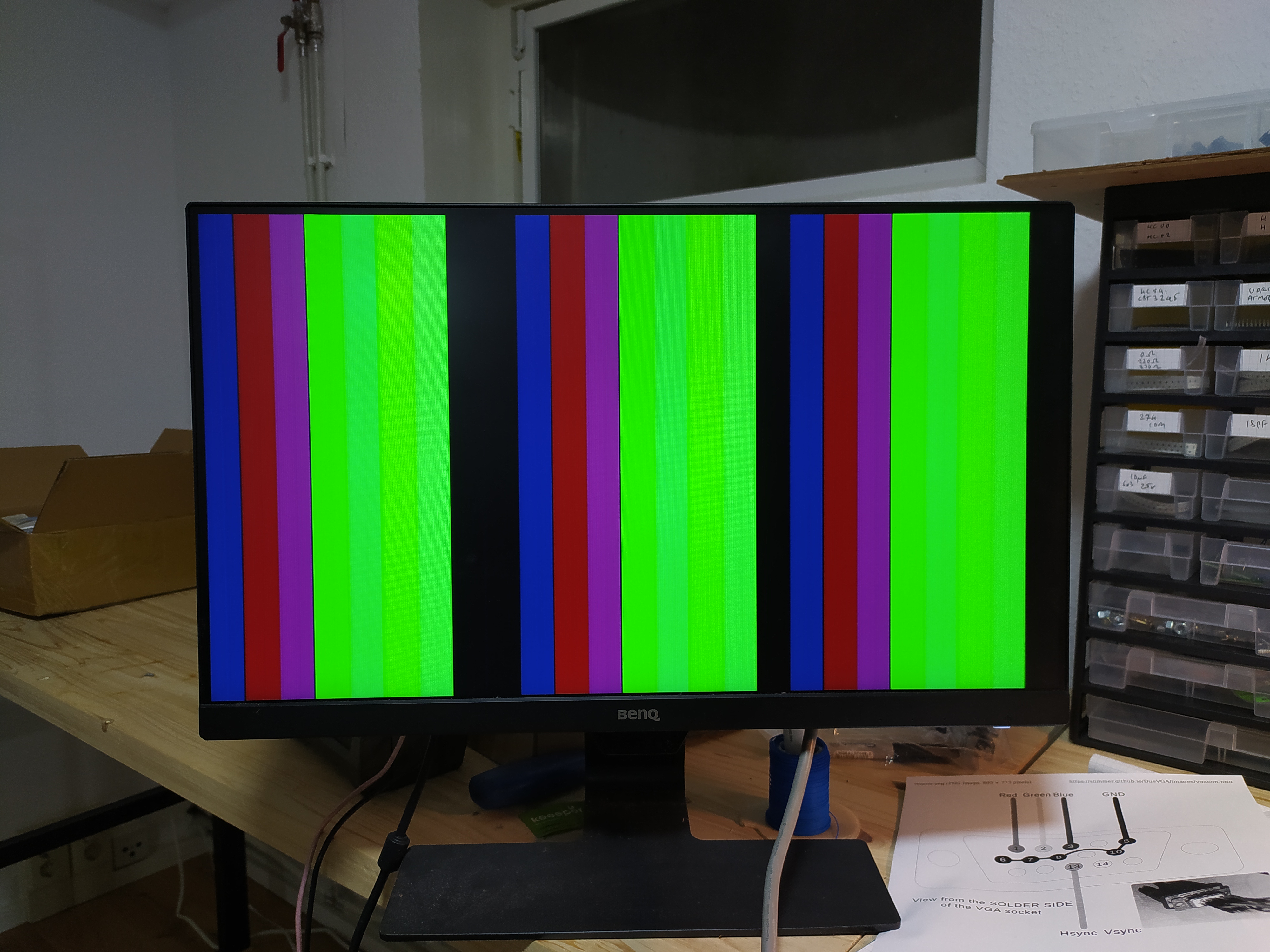

The colours are all over the place but that's not an issue at present; and it looks as if the line sync is at the wrong time (probably I picked line blank instead of line sync) but it's rock steady, no jitter.
The voltages on the output suggest that the monitor isn't terminated (I'm seeing 1.4v instead of the 0.7 I expect, on the cable) and weird things happen when I short out the series resistors: red or blue shorted turn the monitor off, but green shorted sets the green to what I'd expect as the right level. And it's all a bit gloomy... I wonder if (a) the termination is switchable on this monitor and (b) if it can take syncs-on-green.
Aye, something for tomorrow.
p.s. I won't be using colour in the final form, but rather monochrome with R=G=B
p.p.s if the sync is wrong the colours will be as it will be sampling black level at the wrong place...

Sorry if I missed it but I don't think you posted a schematic of the output side of things, so it's hard to guess what's going on there. And as I think you were in broadcasting, I'm sure you know more about this than I do - but from my understanding, ideally you would produce a 0-1.4V signal and then pass it through 75 ohms in series, to the VGA connector. However, it usually works well enough to just pass 5V through about 470 ohms and rely on the monitor having exactly 75 ohms input termination. And make sure you ground all the individual ground return lines at your end, the monitor doesn't necessarily do that AFAIK.
Sometimes I have also passed hsync and vsync through larger resistors e.g. 5K or 10K, I don't know how they are supposed to be terminated.
PostPosted: Mon Jan 01, 2024 9:37 pm
Posts: 988
It's nothing exotic; just a 3.3v output driving through a series 270 ohm resistor. With the expected 75 ohm termination, that should give 3.3*75/(270+75) = 0.72v. Actually, it occurs to me that I'm driving signal - I just picked up a character counter bit - during blanking period. I'll put some blanking on the signal and see what happens. (This proof-of-concept on the proto board is only part of the overall circuit).
hsync and vsync are supposed to be 'TTL' but how close that is to real TTL is not specified in anything I've come across yet. I'm driving them from 3.3v CMOS with nothing in series. TTL is nominally 1.6mA to pull an input low - much less to pull it high.
Yes, normal video amp practice would be to generate a 1.4v signal and feed it through a 75 ohm series resistor, the connecting cable, and then a terminating 75 ohm impedance. That's not necessarily in the display; in the days of analogue video most professional equipment had a selectable high or 75 ohm input impedance so that they can be daisy-chained; only the last is terminated. The purpose of that final termination is to prevent echoes of the signal chasing back along the cable.
edit: a common design of distribution amplifier (DA) would have a low output impedance amplifier section with half a dozen 75 ohm outputs, each through its own resistor. It's a regular need to have the same signal in multiple places.
That would definitely cause the problem, I've seen that first hand - getting different intensities on different lines due to garbage being output during horizontal blanking. I'm not sure whether it's the hsync pulse itself, or a region around one of its edges, but blanking the porches is very much necessary.
I understand why this was the case in the days of composite sync, but for VGA I'm not sure why it can't just go with 0V being black, instead of being adaptive?
I'm sure you guys know this more than I do, but would it make sense to have all the voltage divider stuff up front on the card on the off chance that the monitor doesn't conform to norms?
My brain wants to drift towards using a transistor as a trim so that the current requirements don't need to flow through the ICs.
If I'm way off base let me know, I don't really know much about the analog side of the electronics fence.
PostPosted: Tue Jan 02, 2024 5:51 am
Posts: 988
Effectively that's what's happening, Yuri. Because the terminating resistor is (should be) built into the monitor input to avoid line reflections, you have two choices.
Number one is the canonical best approach: generate the signal, provide a low output impedance amplifier output at twice the required voltage (e.g. an emitter follower), and use a series 75 ohm resistor to match the termination. The voltage division is then between that 75 ohm and the 75 ohms to ground at the input, and so should provide the requisite 0.7v of signal at the monitor.
Number two is the lazy way, and based on the observation that for short cable runs, reflections are *probably* not an issue. In that case, the low output impedance amplifier is a TTL or CMOS gate, and the series resistor is calculated to give the desired voltage when it's part of a divider with the 75 ohm termination - in this case, with a 3v3 supply, 270 ohms is close enough.
Ideally, in either case, the video driver should be a separate chip - which I haven't done so far - and should certainly ensure that the video is black during video blanking - which I also didn't do. So that's a task for today.

Well, now we're getting somewhere.
This is with the addition of line and field blanking. There should be an initial black band on the left hand side; I suspect that the 'auto' function on the monitor (for some reason I initially typed 'minotaur'; something weird in my head no doubt!) has observed the lack of pixels there and decided to display only the visible portion of the line.
Still got 1.4v video signal, though.
