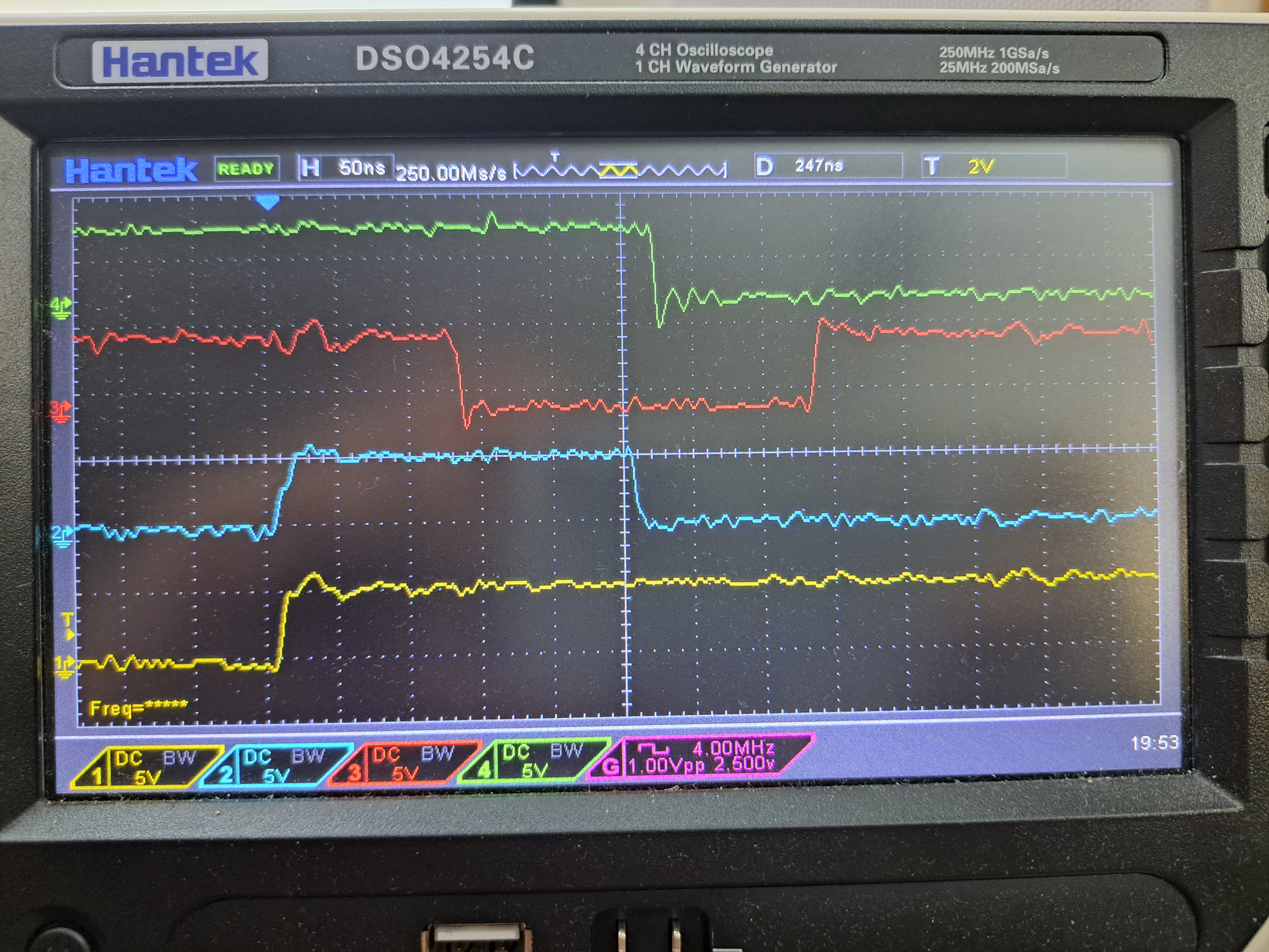

Here's an oscilloscope trace showing the transition from supervisor mode to user mode:
The bottom, yellow trace is a VIA pin that's changing state during the CPU operation that triggers user mode (writing to VIA_PORTA, with pulse output on CA2 enabled). The blue trace is the CPU's SYNC pin, showing when instructions start and how long the clock cycle is. The red trace is CA2, the asynchronous reset input to the first D flipflop, which holds the pending mode change until the end of the next SYNC. The green trace on the top is the second D flipflop that outputs the user/supervisor state, and this is the signal that changes all the address decoding.
It's interesting to note that the handshake pulse from the VIA is maintained over the falling edge of SYNC. This means that I could probably have not used the first D flipflop here - I could probably have just used an AND gate to make the second D flipflop blend its current state with the CA2 state, so that it would stay high only if CA2 was not low, and after going low, it would stay low until forced high again.
In the traces above we can see that the system is going into user mode, and then executing a series of 6-cycle instructions. I am not sure what these were exactly, nothing was driving the bus but evidently it floated to, or persisted at, a level that corresponded with a stable state. To check this better, I added a pull-down resistor network to the data bus, so that it would give a BRK opcode if no device was driving it, and this made it easier to confirm things were working as they should:
I moved the red probe (second from top) to the CPU's VPB pin this time. Now we can see the user mode state starting at the falling edge of the SYNC for the RTI instruction, and then another instruction starting which will be a BRK due to the pull-down resistor, and then VPB goes low for two cycles, forcing the system back into supervisor mode. After that a couple of instructions execute - this is my IRQ handler which just loads X with a specific value, writes it to port A, and issues a STP instruction. The write to port A brought the yellow line low again and STP meant no more sync cycles occured after that point.
So clearly the address decoding has responded to the transition to user mode, and the ROM is no longer mapped; but also, on VPB, we do return correctly to supervisor mode in time for the IRQ vector to be read from the ROM.
Finally I wanted to test the ROMDIS signal, which is used to disable the ROM and have high-bit-set operations read from the pagetable/private supervisor RAM instead. Again that RAM is not present, but my pull-down resistor network will cause BRKs in its place:
The yellow line at the bottom is now the ROMDIS signal, which is just an output pin on the VIA - when high, ROM is disabled. It's transitioning right at the end of an instruction, in time for the instruction fetch during the next SYNC to occur from pagetable RAM instead. We get a BRK, and see VPB (red trace, second from top) go low as expected a few cycles later. The system stays in supervisor mode (green trace, top) as intended.
So I think everything in this part of the circuit is working well. This evening if I get time I will wire up the RAM and the transceivers, and hopefully be able to bootstrap a minimal kernel. The strategy for that is probably to have the boot ROM run some system tests and then stream the kernel code from the ACIA into the private RAM, then disable the ROM.

gfoot wrote:
I decided to prototype it, so yesterday I went ahead with that.
Lotta chips!  Reminds me of the Basic Four minis I worked with in the previous millennium.  :D
The waveforms don’t look too atrocious for being on breadboard.  Usually, square waves on a breadboard are so rounded you can hardly tell where logic zero ends and logic one starts.
I am used to the traces being more noisy than this, for sure. I wasn't very careful with the construction or probing technique, so can't put it down to that. The ground grid always helps though and is worth doing up front before building everything else on top. I didn't put any decoupling capacitors on this, either, so I expected worse quality signals than I got.
I have wired up the RAM as well, at least as a first pass, and it appears to work so far - the only bug was in my test code (thanks to hoglet's decoder it was very easy to pinpoint) so now I can try to develop a bit more software.

That you are using (IIRC) HCT logic helps—HCT has relatively sedate edges (and relatively slow timing compared to AC & AHC).  When you add ROM, that’s probably when the fun will start.  ROM tends to generate large transients on the power and ground buses as /CS and /OE are switched.  I have a white paper somewhere in the vast refuse pile on one of my servers that goes into some detail on noise problems caused by ROMs, especially the 45ns OTP parts sold by Atmel (Microchip).

I did some more testing yesterday - I'd already made the ROM test that it could map a page of RAM (which requires the U8C AND gate hack I did to allow writes to ROM to also write the pagetable) and also test that that 4K page of RAM is working correctly, as the boot code's zero page and stack live there. So that then allows the boot code to use subroutines, making the code more comfortable to write.
The memory map at that point is roughly that the bottom 4K of address space is mapped to physical RAM page 0 (out of 8 in this cut-down system), and the top half of the address space maps reads to come from ROM, and writes to go to the private/pagetable RAM. The bits in-between ($1000-$7FFF) are more paged RAM, but the pagetable hasn't been initialised yet so they could point anywhere.
To speed up development, I pasted into the ROM my load-from-serial code from my last system, with minor changes, and was able to get some code loaded into the page of RAM that way. The interface allows the PC-side server software to choose which code gets loaded, to what address, and where execution begins, so this means no more changes are needed to the ROM for now - I can load code or data anywhere I like, with the caveat that it has to be done 256 bytes at a time.
Loading a short "hello world" program to the valid page of RAM worked fine (loading at $0200). The main missing piece then was getting code loaded into the private RAM that's masked by the ROM at boot time. In the long term it might make sense for the ROM to just copy itself into the private RAM and then disable itself, with execution flowing on seamlessly from the private RAM instead. But to avoid having to iterate on the ROM itself, I used the serial server to tell the ROM to load code into the private RAM, at $8800, and then made it load and execute a stub in paged RAM at $0200 that can itself disable the ROM then chain to the loaded code in private RAM. The ROM should be able to do this through the same hack that allows pagetable writes to work even when the ROM is enabled.
This didn't work very well though, and was hard to diagnose. My main tools were the logic analyser, hoglet's decoder, and an oscilloscope, setting VIA output pins at key moments to trigger the oscilloscope. I found quite a few issues this way, the main one being that the hack to let the ROM write-through to the pagetable RAM doesn't seem to be working very well. It does seem to be good enough to let it write that initial pagetable entry, it seems, but I don't know why, and it is certainly not reliable at all later on. I need to do a lot more diagnosis on this, but it will involve iterating on ROM content, so I'm going to defer it for later - I do want to fix it though before getting any PCBs made.
I did find that the way I am switching the buses back and forth in these writes is putting a lot of stress on things - I am seeing evidence of bus contention, such as downward spikes in the power rail, and noise on the pagetable data bus. I think the bus transceiver between the CPU's data bus and the pagetable RAM's data bus is having a particularly hard time.
As above though, I won't investigate this in detail yet, because it seems to work very well so long as I disable the ROM before loading data into the private RAM. This is why I think the issue is something to do with my hacky AND gate that is meant to open the transceiver during writes to ROM address space. So I wrote a program that runs in paged RAM (at $0200) which disables the ROM, and writes a distinctive pattern into private RAM at $8800, then reads the pattern back. This worked well to highlight that I had misconnected one of the address lines to the private RAM, which was easily fixed.
I wrote a more thorough test of the private RAM, which would fill all 32K of it with a distinctive pattern and check it could be read back properly - skipping, of course, the two bytes that are defining the page mapping for the RAM where the code is running from! And as that passed, I pasted the bootloader code in again, so that this code running in paged RAM can query the serial server again for more commands, and load some proper code into the private RAM area from $8000-$FFFF. It sends a different query string to the serial server, so that it knows to supply stage 2 rather than stage 1 this time.
This in turn allows running code located in the private RAM, which is where the kernel code is meant to be - this is always visible when in supervisor mode, and provides the NMI, reset, and IRQ vectors, so that's important too. The code I put there at the moment is just a more thorough test of the functionality of the paged RAM. It first checks the paging system by using a combination of mappings of logical pages 1 and 2 to check that different physical pages can be mapped, that two logical pages can be mapped to the same physical page, and that asymmetric read/write mappings work (which are required for read-only pages to work).
After checking the paging system, it measures the amount of physical RAM it can see by setting location $FFF in physical page zero to a non-zero value, then looping through the other physical pages, mapping them in and writing location $FFF in each, until it finds one that either can't retain data, or causes $FFF in physical page zero to get overwritten (wrapping). Either way, that's the amount of physical RAM in the system.
Then it performs a more thorough test of this RAM, filling all of it with a pattern and making sure it all reads back and that writes to one page haven't corrupted another. It's an important test, as it is sometimes not obvious when writing to one bit of RAM is corrupting another - a bit like those phony USB drives that are sold with one capacity but actually have a much smaller capacity, and the user doesn't notice until it's been used for a while!
Anyway that all seems good, the memory is working fine. I can do more tests of user mode now, which is dependent on the pagetable and paged RAM working correctly because that's all it's got access to. If that works then I will swap in the larger memory modules, as with only 32K of paged RAM the system only has room for 8x4K pages, which is not a lot.
