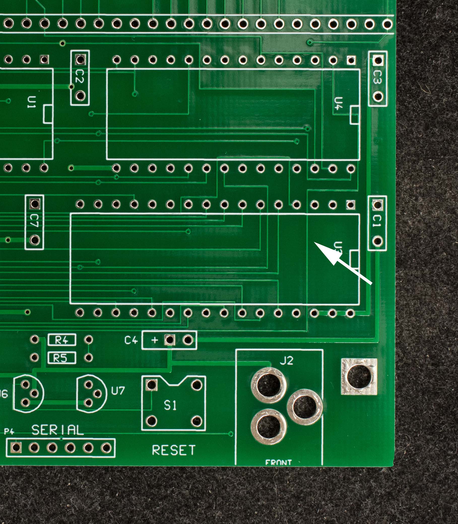

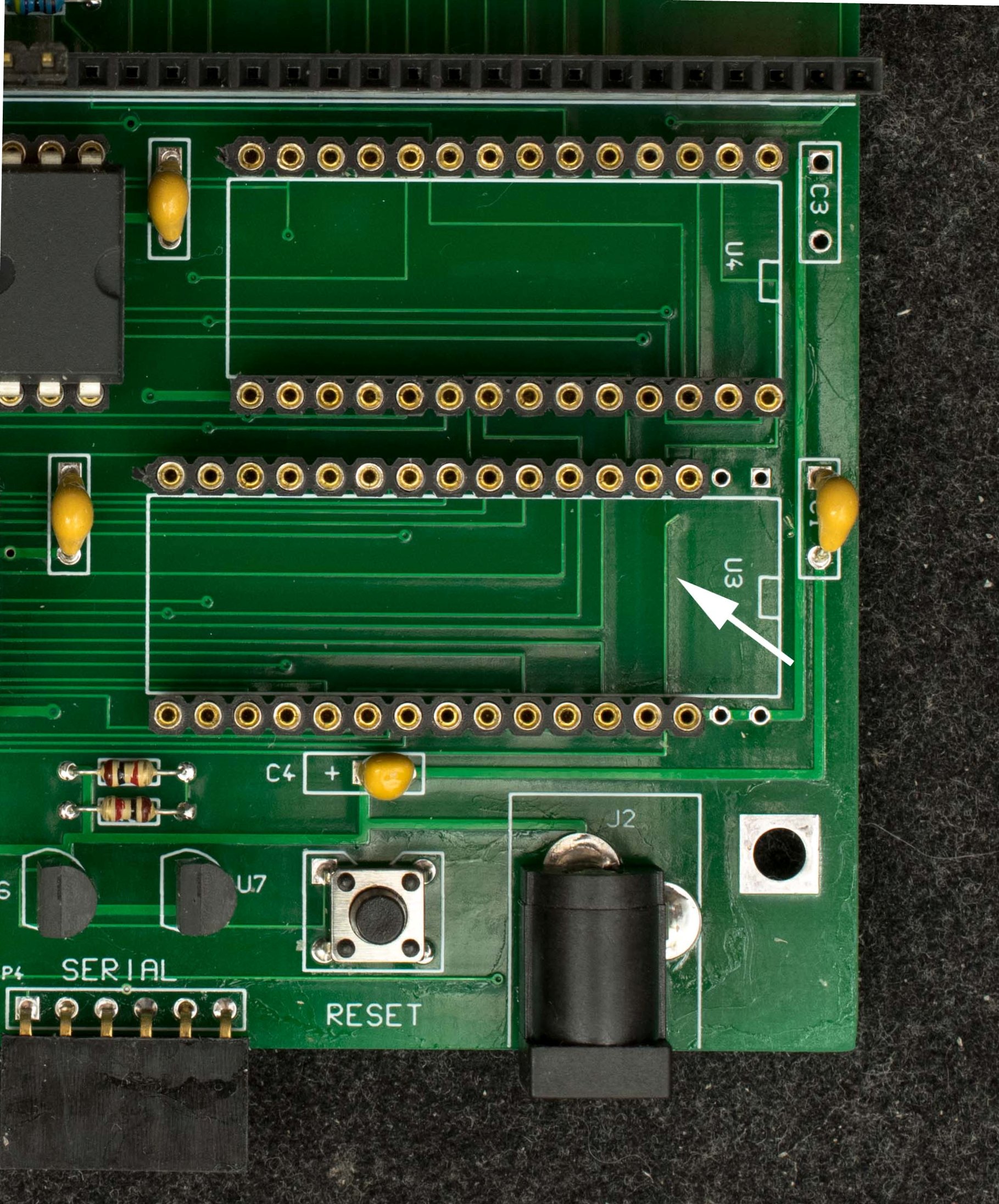

I built up another ZG6502 as a testbed to check out a number of used 6502 and 6551 that I purchased a while ago. ZG6502 design is proven, but the new board won't work, even when populated with working parts from a working board. After a good bit of inspection and troubleshooting, I finally discovered two broken traces on the problematic board. These broken traces were under the solder mask, so they were broken during the manufacturing process. Here are side-by-side comparison of the assembled board vs bare pc board. The broken trace is the one pointed with the white arrow. The trace should pass through pins 3 & 4 of U3 as shown in the bare pc board, but you can see the trace was broken and pushed off at a 45 degree angle in the assembled board. There is another broken trace but it is under the socket and hard to photograph.
PCB defects are quite unusual with JLCPCB, but it can happen. It is something to keep in mind when troubleshooting.
Edit, Inspected other pc boards from the same batch and found no problem. Build up another board and it is working fine.

I thought JLCPCB did 100% flying probe test on each board.
Greg
PostPosted: Sat Dec 02, 2023 8:02 pm
Posts: 964
I believe they do, but that I think has to happen before the solder resist and silk screen. So e.g. a probe catching a thin trace before moving might indeed have checked good, and then broken before further processing.
PostPosted: Sat Dec 02, 2023 8:23 pm
Posts: 8483
Yes, this is an unusual thing. So far, all my JLCPCB orders have been flawless.  The appearance of the break suggests it happened before the solder mask was applied.  As Neil notes, the flying probe test had to be done first.  It could be a malfunction of the test rig dragged a probe over the trace and cut it.
If it were me, I’d bring this to the attention of JLCPCB.  I’m sure their QC people would want to know about it.
PostPosted: Sat Dec 02, 2023 8:27 pm
Posts: 1114
I had the same thought that the trace breakage occurred after electrical test. The trace was pushed aside, so it was caused by some kind of mechanical tool.
