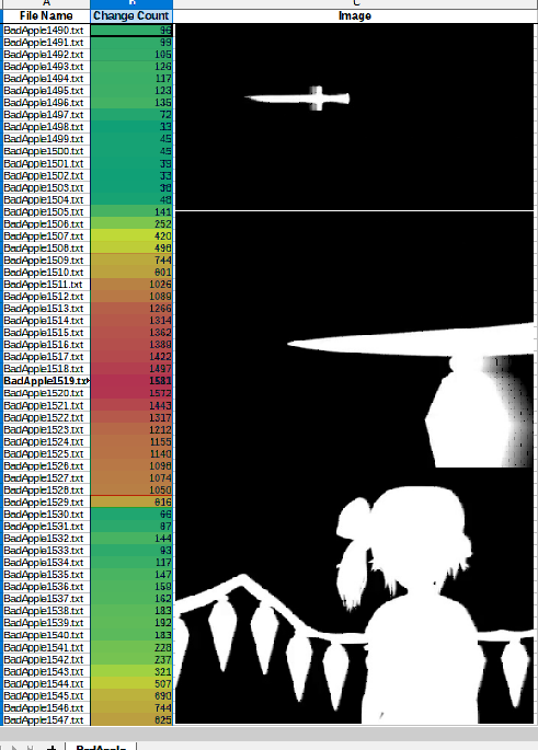

gfoot wrote:
Excellent! It certainly looks good in the video. Scenes like Fran's appearance are probably the hardest to keep up with, that one was ridiculously expensive in my version.
Is that the girl with the dangling shapes on her wings?
If so that one scene is what inspired me to tackle adding a 3 pixel dictionary to my Run Length routine. I realized that the transitions between black and white is usually a combination of 3 grey pixels and a run of black or grey.
It helped A LOT... But it still lags a bit.
It is just a lot of pixels to move no matter what. I might 'cheat' and store the first few frames of that scene and a couple others in RAM and add logic for grabbing these 'key frames' from ram instead of streaming off the sd card.

Nice idea. I think cmorley's one used the hardware palette to deal with the cases where most of the screen changed colour. Another trick is to not faithfully update the entire frame, if it's going to take too long - update alternate lines first, then the other lines in the next frame. The Python script could detect when the delta for a frame is too large and switch to this mode. You could also deprioritise pixels that are going to change yet again in the very next frame...
Ohhhh... I super like that idea!
I can think of a way I can manually stitch together an even/odd line encode in the problem areas...
But I really like the idea of detecting when there is a lot going on and deprioritizing pixels that are about to change again anyway.
Now that I think about it.... If I just dropped the grey colors or maybe alternate between dropping light grey and dark grey on the bad frames that might be enough in itself. It would reduce the load a lot and with the Bad Apple source I'm using and I bet it would have almost the same effect as deprioritizing pixels that are about to change since the grey colors are transitions between black and white usually.
Though, shadows might suffer if they get deprioritized.
Maybe manual frame tweaking and interlacing in a couple spots might be the quicker choice?
For instance, with greyscale when the apple is thrown at the beginning there is a trail of grey left behind as the sleeve moves with the arm. It looks good in motion but it really lags because a lot of pixels change from black to dark grey, then light grey, then white. I've noticed that even with this super fast SD read throwing the apple is still less smooth than it should be.
If I just manually reduce the motion blur shadows on the source I can keep the grey trail but reduce the size of it until it plays at full speed I would think?

I'm really zeroing in on the last optimizations needed to get a true 30FPS lock on this demo.
When I first started I kept using the 30FPS encode as an aspirational thing and never really thought I would end up getting a 37 FPS average!
Wow!
Thanks to all the 6502 people who contributed directly with help and indirectly with your old comments and articles!
With my current encoder/decoder I get a pretty even and good looking 30fps on average. Just a couple 'edge cases' that are a bit to fast or slow.
But with the frame locked music I added the uneven slowdown and speed up 'rubber banding' is very, very obvious.
Yes, I will disconnect the music routine from the video and key off the Vsync NMI.
That fixes the audio issue well enough.
But the video......
I just know it can be improved!!
Here is how:
As gfoot recommended I looked into treating each bit more individually instead of always reading a whole byte.
I was surprised that my existing encoding was as good as it was without taking that into account.
But yes indeed!
There are many, many bytes I was leaving on the table by 'byte encoding' instead of 'bit encoding'
It looks like if I go that route I'll save at least 20% on the encode otherwise as-is.
If I drop the ability to display arbitrary colors that gets me another 10% or so. This is a surprise to me that it looks like it is that low, but on the flip side it increases the decode speed a decent amount since it is a conditional branch on every 'change' or currently half the bytes read that I get to skip.
Either way this will be a good uplift on the problem frames.
Though I now have to find a good way to deal with the 10 mandatory CRC bytes that SD cards barf out every 512 bytes. I count every 2 bytes read currently so I can do a 8 bit counter and then do a unrolled read of 10 bytes when it rolls over to zero.. That's bad enough.
I don't want to count every bit.... Ouch... I'll have to think on how to handle that....

File comment: 1 encoded change = 1.22 bytes on average
But I think there is still a way!
Back ground:
The screen is 100x64 bytes. It has 28 bytes 'wasted' on the right side that are off screen.
Meaning that a line on screen is 128 bytes long, but you can't see the last 28 bytes.
I need the Screen address to roll-over to the start address ($2000) once it gets to the end of the possible screen address space.
That roll-over happens at $3F34 or $4000 depending on how you want to look at it/code it.
Right now I skip these 28 bytes on the side of the screen by encoding 2 bytes as 'skip' bytes on the edge of the screen with my encoder.
That routine simply adds the skip length to the Screen Address and moves on.
If I can find a efficient way to skip over the 28 wasted bytes on the edge of the screen then I can also often avoid encoding these skip bytes.
Since I encode as one long line I sometimes am already in 'skip mode' at the edge of the screen so I get to just continue the skip so there are no saved bytes in that case.
It takes 47 cycles to read a byte from the SD card. So anytime I can skip these bytes encoding off screen skips in less than 94 cycles a line I'm ahead. It also allows a better RLE encode since I get to ignore the skips on the edge. It could also mean reducing the average bytes per frame from ~500 to ~400.
This will reduce the bytes per frame by around 20% and free up time for decoding, drawing, and reading more bytes.
Also, I want to find a way to better optimize the Run Length draw code as it just seems too pokey to me.
The below code takes something between 37 and 43 cycles a pixel/byte to fill the screen and I must encode the skips on the edge of the screen.
I'm sure there must be a faster way to do this:
