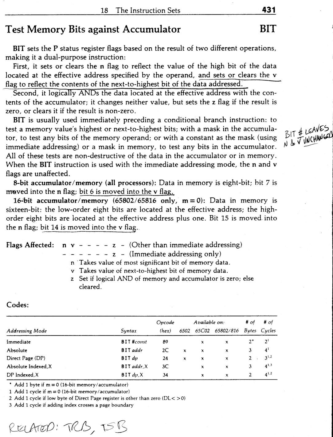

I really need to get my head around just how the bit instruction works... I don't think I've *ever* used it.
It is used like a regular
AND #
here to test for bits, however without loosing the value of A. This mode is not available with the NMOS 6502.
I hope it's ok to attach this.  It's a page scanned from my paper copy of "Programming the 65816—Including the 6502, 65C02 and 65802" 6502/65816 programmer's manual by David Eyes and Ron Lichty, which I bought in the 1990's.  Even though WDC is charging for it again, they had it for free download for many years.  I'm justifying the post by thinking maybe it will encourage more people to get the whole manual. :D
From my links page:
This is definitely the best 65xx programming manual available, and a must-have for every 65xx programmer!  It starts with the basics, followed by architecture, the CMOS 65c02's many improvements over the original NMOS 6502 including added instructions and addressing modes and fixing the NMOS's bugs and quirks, and then the natural progression to the 65816; a thorough tutorial, writing applications, then very detailed and diagrammed information on all 34 addressing modes, at least a page of very detailed description for each instruction, with info on every addressing mode available for that instruction, then instruction lists, tables, and groups, of all 255 active op codes, plus more.  469 pages.  From Western Design Center.  (.pdf)  Note: There were many problems with the earlier .pdf version that were not in the original paper manual; but in late March 2015, WDC scanned and OCR'ed the paper manual and posted the new, repaired .pdf.

Ah, thanks. So it can test any bit(s) including 6 and 7 that get transferred anyway... I had it for some reason that it could _only_ read those bits... I should read the docs better.
PostPosted: Wed Nov 22, 2023 1:15 pm
"When the BIT instruction is used with the immediate addressing mode, the n and v flags are unaffected."
Whoa! -- probably I used to know that, but it's good to have a reminder.
One would hardly expect the presence or absence of a flag update to vary according to which address mode an instruction is using. :shock: Still, I think I understand the decision to have BIT immediate behave anomalously.
One would hardly expect the presence or absence of a flag update to vary according to which address mode an instruction is using. :shock: Still, I think I understand the decision to have BIT immediate behave anomalously. ...
Yes, since the state of the N and V flags would be determined by the immediate operand, setting those flags is never going to give new information. So if it ever might be convenient to leave them untouched for some BIT operations, may as well make "BIT #u" the one that leaves them untouched.
