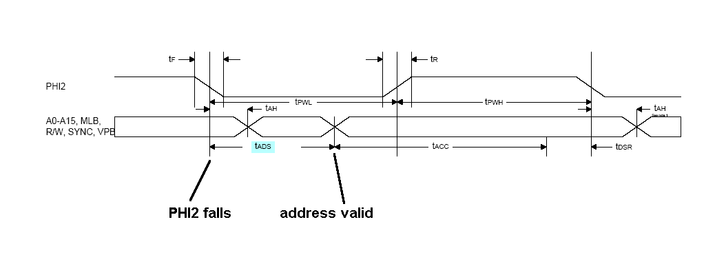

Yes, I agree this needs to be stressed. For example, the address changes as a result of Phi2 falling. (And the data sheet refers to the associated delay as tADS.)
I believe AndrewP understands this, but his wording is perhaps ambiguous when he says the address "should have settled by the time you use it (when PHI2 rises or later)." Better to say, the rise of Phi2 should be -- needs to be -- sufficiently delayed after the fall of Phi2.
If it's true that we have delayed the rise of Phi2 sufficiently after the fall of Phi2, then tADS will have have elapsed before we bring Phi2 high.
timing diagram excerpt.png (9.73 KiB) Viewed 314245 times

AndrewP wrote:
Yup, that’s exactly it:
Sigh!  Can’t read your attachment due to color.  Parts of it are invisible.
Just a reminder that you control when PHI2 rises and falls (by selecting a clock frequency) so if your clock is too fast the address lines will not yet be valid when PHI2 rises.  That only starts becoming a problem around 40MHz* so probably not a worry.
In other words, overclock at your own risk.
At any given set of operating conditions, i.e., voltage and temperature  there is a maximum Ø2 where the MPU’s internal propagation times cause a loss of synchronicity, for lack of a better term, in the MPU’s circuits.  When that threshold is reached, either no bus activity will be seen or bus activity will be nonsensical.
Further affecting the Ø2 “ceiling” is bus reactance.  Excessive bus reactance, specifically parasitic capacitance, will cause edge rounding, which will be seen by devices as excessively-slow input transitions.  Also possible is signal skew, which may introduce obdurate timing problems in some cases.
That also means you can start doing address decoding as soon as PHI2 falls and it should have settled by the time you use it (when PHI2 rises or later).
Implied by that is address decoding logic should not be qualified by Ø2, with rare exceptions.  One such exception would be using a 28L92 DUART in Motorola bus-compatibility mode.
Posts: 9426
Re: It begins! (Wren Prototype build log)
I think I'd say that the address lines are generally, usually, probably, valid at the time phi2 rises.
The address bus and control signals (RWB, VPB, etc.) are always valid before the rise of the clock.  Such behavior is required by 65xx peripheral devices, which explains why qualifying 65xx device chip selects with Ø2 will fail.
It’s important to note, as Jeff shows above, that all 65xx timing starts with the fall of the clock, not the rise.  Understanding this characteristic of the 65xx bus cycle is especially important with the 65C816 when considering the latching of the bank bits.
Speaking of the Ø2 clock, clock signal quality with the WDC devices is paramount.  WDC’s specs require the clock transition rate be no slower than 5ns peak-to-peak, and the signal must swing to a minimum of 80 percent rail-to-rail.  Clock symmetry can also get you if your machine is running sufficiently fast.  If you are running into stability issues at high Ø2 rates, be sure to scope your clock signal.  You might be in for an unpleasant surprise.

Yeah, clocking the CPU too fast won't be an issue for me - I was more asking to make sure the code on the AVR can talk to the bus properly. I'll have the AVR control the clock, so I can step it as fast or slow as I like (at least, as fast as I can toggle a GPIO pin), as well as get single-cycle and single-instruction operation without the need for extra stuff on the board.
It feels a little like cheating to use an AVR, but I don't really have anything else that can do the same job.
