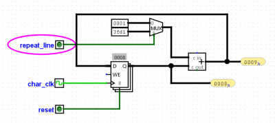

PostPosted: Tue Nov 14, 2023 8:43 pm
Posts: 741
Yes, double-scanning with a non-power-of-two stride requires being able to reset the counters at the start of each scanline - unless you do something like storing the whole row in a FIFO to replay it several times.
I've thought about this before but not come up with anything particularly simple. One option is to capture the counter values at the start of a scanline and reload them at the start of the next one if it is a duplicate. Another is to use adders to advance vertically, and another set of adders to add on the values of horizontal counters over the course of the scanline to form the address. I guess you could also have two sets of counters with a different initial value and use one set on even lines and another set on odd lines.
I haven't thought of anything particularly simple or elegant. But a side advantage of these schemes is that it's pretty much the same hardware you need to support scrolling, so maybe it is worth the investment.

Here's a first thought on a line doubling system.
If repeat_line is high, the count subtracts 0x0030, otherwise it adds 0x0001. Still need to think about the logic of ensuring that repeat_line only holds for one clock every second line, but the concept is there.
About 10 chips so far: two 8-bit latches, four 8-bit buffers (or maybe just two and some resistors), and four adders.

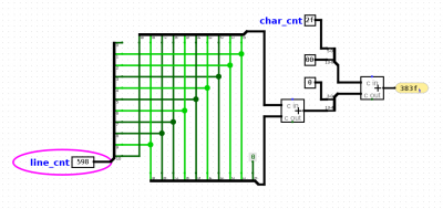

Posts: 983
Here's another thought: it takes six four-bit adders, though, and the line counter on top of that (both it at the one above still need character counters) but it's perhaps conceptually a bit simpler if less flexible: the left hand adder multiplies the line count divided by 2, by 3; effectively by 0x30 because the lower four bits are zeroed. The four lowest bits of the count can be supplied directly since they can't affect the higher bits, but sadly the next two bits can, hence the need for two 12-bit adders (aka six 4-bit).
The big advantage is that it doesn't need synchronous counters so I can fit eight bits in a chip.

PostPosted: Wed Nov 15, 2023 9:44 pm
Posts: 983
Yeah, that was my first thought, but non-contiguous ram - 64 characters albeit on a 66 cell line would be *easy* - wastes loads of ram, and it's all in tiny chunks that are basically neither use nor ornament.
But I think a 393 for the line counter, a tiny amount of decode for the active line and sync, and a couple more 393s for the line counter, plus half a dozen adders ought to do the trick...
Unless... what if I use the extra 16 bytes on each line for the font table? I'd have room for three hundred characters... but addressing them would be less than quick. Maybe not.
