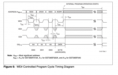

Anyone actually try programming an SST39SF010 with a 6502?
The whole "magic byte dance" on the address bus looks like it's going to give me a headache.. By demanding $5555 and $2AAA are in ROM address space.

I haven't programmed this device, but it sounds like it has similar requirements to a locked AT28C256 EEPROM. Here's example code to deal with that for the Pi Pico in case it helps: https://github.com/gfoot/picoprom/blob/ ... prom.c#L67
In your 6502 case, you don't need those addresses to actually be in the ROM's address space from the CPU's perspective - what you need is to work out what addresses to use from the CPU to cause those bit patterns to appear on the ROM's address lines. So if your ROM region is filling the upper half of the memory map, then you'd write to $D555 and $AAAA instead, i.e. the same addresses but with the top bit set - the top bit triggers the address decoding to select the ROM, and the rest of the bits are passed through to the ROM, giving the desired addresses.
The only challenge of this byte dance, at least for full-page writes on the AT28C256, is that you need to be careful with the timing and also mustn't read from the chip during the operation (so your code needs to be located elsewhere). If you pause too long between writes, or try to execute reads, it truncates the page write operation and returns garbage to the CPU for a while, as the operation is taking place in the background. So you need to execute the dance and supply all the data with the right timing in one operation, then be prepared to sit and wait for a while running code from elsewhere (e.g. RAM) as the chip performs the full page write.

Yes, I'm doing it right now, as we speak.
I'm programming the SST39SF010 EEPROM in the WDC65C134-SXB board directly from 6502 code. (From TinyBasic, but that not relevant) It's working very well (now, anyway, it wasn't easy to get going for many reasons not directly connected to the SST39SF010).
You need to copy code into RAM and run it from RAM to program the EEPROM. You can't program it from code running inside the EEPROM - because code access gets in the way of the "magic byte dance" routine.
So that's what I do - I have a version of my TinyBasic that I download into RAM to run from there - it's a handy tool to write a programmable device flasher in than anything else and call some specific built-ins to do sector erase and programming from RAM images..

You can ignore the JSRs at the start - that's to do with getting data from the Basic environment into the ASM world and also setting up the SXB hardware for the right thing (it treats the 128KB EEPROM as 4 banks of 32KB and there is further shenanigans to do with the built-in ROM).
Remember to disable all interrupts before you start the operations too.
This is what I'm doing for "bulk" re-flashes of my new OS and TB for the '134 - once my TB in is ROM, then to do the flashing for program saves, it copies a little stub into a small reserved area of RAM and calls that to do the actual load/save of Basic programs.
Hope this helps..

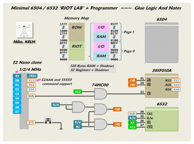

When I was fleshing out the idea of using a $2 Nano uC for in-circuit programming on a variation of your 65uino design I realized I would have to force writes to ROM in the decoded $1XXX block or its shadows and manipulate the ROM A12, A13, and A14 address lines to spoof the $2AAA and $5555 addresses required for ROM command and control sequences. If it helps, here are some notes for a uC wrByte() function (below). It's fast enough to program bytes between incoming characters at 115,200 baud. I would need a similar function to erase the 4K sector. A simple set of functions could present as Erase (about 50-msecs), Program (from hex file, about 2 seconds), Display (memory), and Run commands to the host PC running terminal software or a custom program.
Good luck. Have fun. Mike
       ~  wrByte() in Flash ROM on Neil's 65uino (erase 4k sector first)  ~
       ~  force ROM writes to the decoded $1XXX block and setup the A12,  ~
       ~  A13, and A14 address lines to spoof a $2AAA or $5555 address.   ~
       ~  the uPush() clock function disables ROM (RUN pin = 0) and the   ~
       ~  uPull() clock function enables ROM (RUN pin = 1).               ~
       ~  set the 6507 'PC' to $1000 to avoid running the 'PC' into the   ~
       ~  I/O area during programming operations.                         ~
    /*     uReset();                  //  reset 6507 (sync' uC to cpu)    ~
           uPush(0x4C);               //  jmp $1000  reset PC             ~
           uPush(lo(0x1000));         //   "         abs address lo       ~
           uPush(hi(0x1000));         //   "         abs address hi       ~
    // ~~~ wrMEM(0x5555,0xAA) ~~~~~~~~~~~~~~~~~~~~~~~~~~~~~~~~~~~~~~~~~~~~~
           set(x12);                  //  rom A12 = 1                     ~
           clr(x13);                  //  rom A13 = 0                     ~
           set(x14);                  //  rom A14 = 1                     ~
           uPush(0xA9);               //  lda #$AA                        ~
           uPush(0xAA);               //   "                              ~
           uPush(0x8D);               //  sta $1555 (spoof rom $5555)     ~
           uPush(lo(0x1555));         //   "         address lo           ~
           uPush(hi(0x1555));         //   "         address hi           ~
           uPull();                   //   "         6507 write cycle     ~
    // ~~~ wrMEM(0x2AAA,0x55) ~~~~~~~~~~~~~~~~~~~~~~~~~~~~~~~~~~~~~~~~~~~~~
           clr(x12);                  //  rom A12 = 0                     ~
           set(x13);                  //  rom A13 = 1                     ~
           clr(x14);                  //  rom A14 = 0                     ~
           uPush(0xA9);               //  lda #$55                        ~
           uPush(0x55);               //   "                              ~
           uPush(0x8D);               //  sta $1AAA (spoof rom $2AAA)     ~
           uPush(lo(0x1AAA));         //   "         address lo           ~
           uPush(hi(0x1AAA));         //   "         address hi           ~
    // ~~~ wrMEM(0x5555,0xA0) ~~~~~~~~~~~~~~~~~~~~~~~~~~~~~~~~~~~~~~~~~~~~~
           uPush(0xA9);               //  lda #$A0                        ~
           uPush(0xA0);               //   "                              ~
    // ~~~ wrMEM(addr,data) ~~~~~~~~~~~~~~~~~~~~~~~~~~~~~~~~~~~~~~~~~~~~~~~
           uPush(0xA9);               //  lda #data                       ~
           uPush(data);               //   "                              ~
           uPush(0x8D);               //  sta addr  ($1000..$1FFF)        ~
           uPush(lo(addr));           //   "         address lo           ~
           uPush(hi(addr));           //   "         address hi           ~
           _delay_us(20);             //  required write delay            ~
Oh now I get it! Thanks for the detailed feedback! :)
I'm thinking the X12-14 aren't needed since A14 == A12 and A13 is the inverted A12 and that's the inversion we already have as ~OE on the 65uino.
On this revision I have ROM-A12 grounded(easy trace to cut) but instead I could just connect it to A12 and offset ROM data.
From there I guess the issue is ~OE is active @ $5555 - so instead of just inverting A12 for ~OE it could be A12 NAND ~RW.. But then we'd be missing the inverted A12 for A13.
So unless gating ROM ~RW with PHI2 is strictly necessary a single extra NAND gate would do the trick - but obviously not being able to program the whole ROM... Even though it would make it self-programmable.
I think when we write AA and A0 to address 2AAA we'll also be writing to Output Register B on the 6532.. And that's not ideal, but maybe not a dealbreaker.

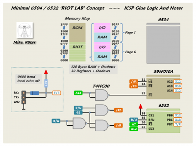

Thought you might enjoy this. I was wondering if it's possible to fit an ICSP (In-Circuit-Serial-Programming) program into the 128 bytes of RIOT RAM on modified 65uino hardware. The attached file contains clumsy, untested, and probably buggy code, and while the ICSP process has a few limitations and caveats, I'm kinda' geeked to see what you can fit in 128 bytes.
Regards, Mike
