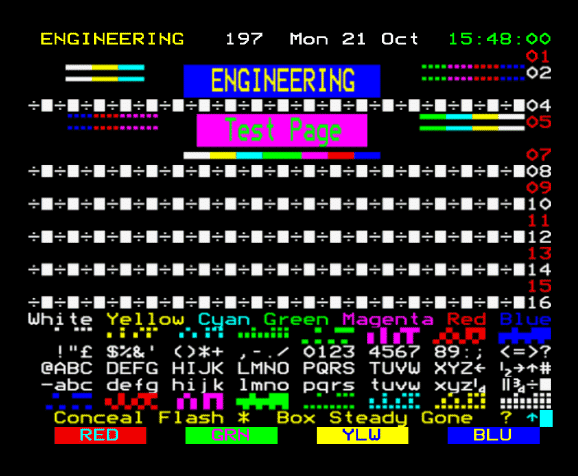

The default Ceefax chips didn't include a pound sign '£' ...
Yes they do:
JGH - http://mdfs.net
PostPosted: Sun Nov 19, 2023 6:02 am
Posts: 986
Yes they do:
That one maybe. Not the one the boys at Designs Dept chose :mrgreen:
