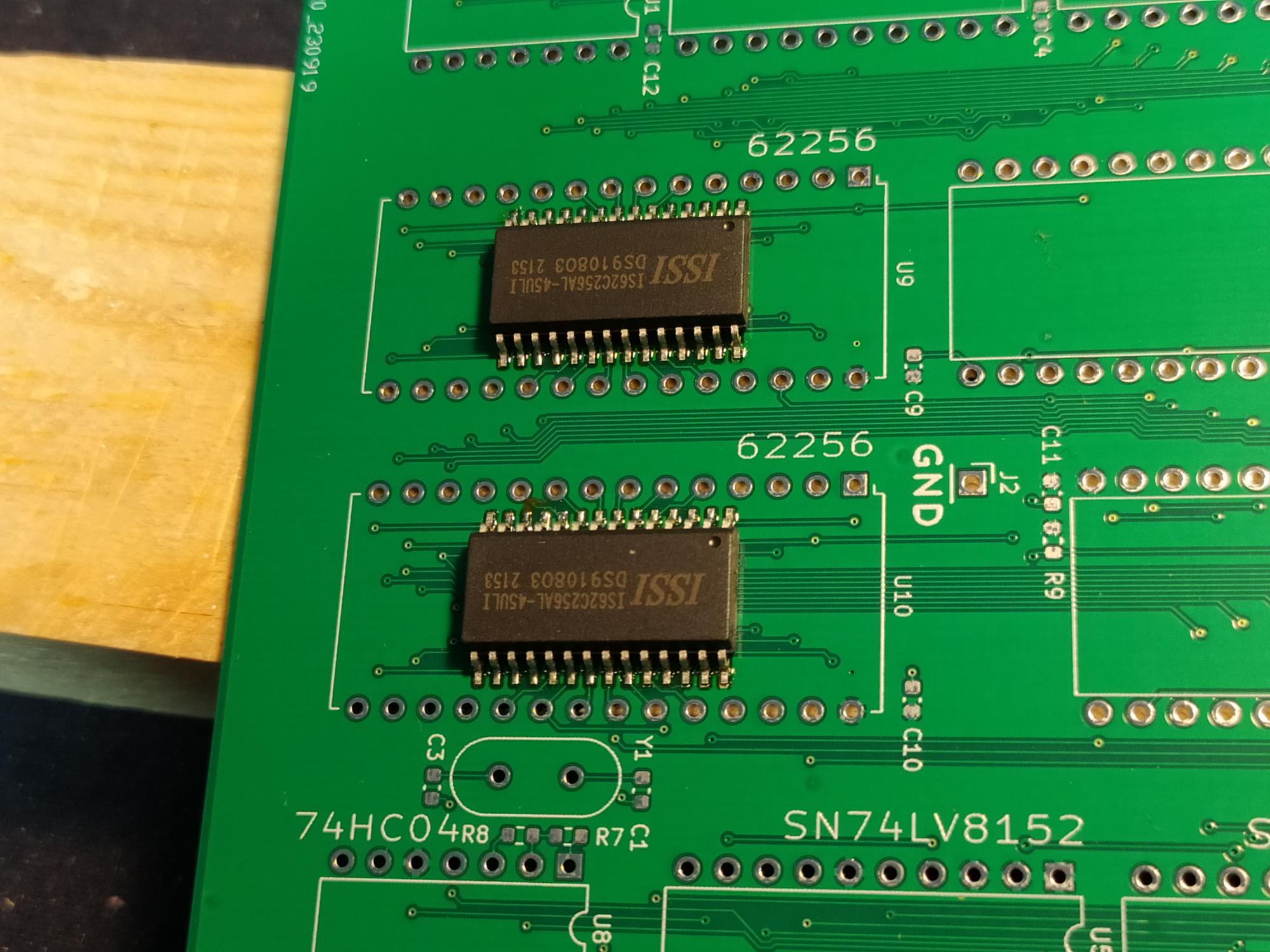

Got the two ram chips on the board. The dual DIP/SOIC footprint is really handy and I happened to have some soic parts around. This courtesy of a few minutes in a second hand toaster oven and a syringe of solder paste; no template for this one. Just had one short (too much solder) and one open circuit (not enough), both easily fixed with the soldering iron.

Now with added sockets. No, I didn't have any 20-pin sockets... never mind. The other SM parts added with a hot air pencil (should have done them in the oven with the ram but I didn't think).
The reset resets and the oscillator oscles. So now it's waiting on me to finish the code to convert an intel hex file into a binary blob.
