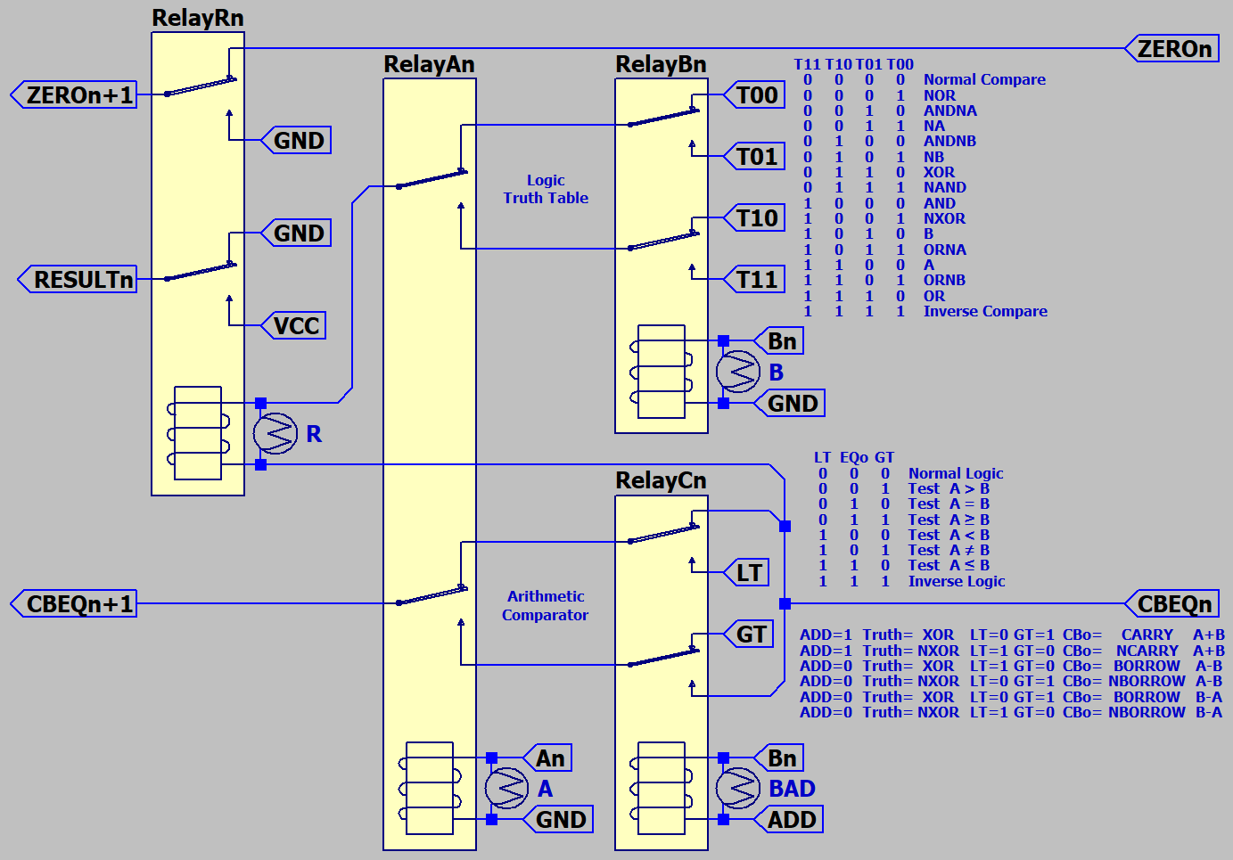

Then lets talk Zero for a moment, cause we need an eight (or nine?) input NOR of the result.
Is 100000000 with CarryOut a Zero? Open collector or drain provides a solution, but not fast.
Fast might be a series circuit in parallel with the final XOR operation (CBT3253 could do both),
but still 6nS+250ps*8+elmo. I got no drawing ready in CBT, only in relays of an old drawing.
Coils and lamps give sneaky free differential XOR, don't go looking for gates or throws.
Magnitude comparator chain could compare for equality to zero, but would need to save a
copy of the last testable result for that purpose. Thinking an extra cycle only when Zero is
checked might be less wasteful of time than always compute Zero we may never look at.
Saying a wastefully tested Zero flag replaced by a byte saved for deferred test on branch.
That byte along with saved C4 might be useful for decimal adjusts too.

Depends style of magnitude comparator. Mine was intended to borrow, just happens to also check magnitude.
Doesn't output < = > flags. Instead tests a combo of < = > rules each pass. The three rule selects are inputs.
Equality to Zero tests just as fast as borrow because they are the same circuit.
Success can be forced backward (rightward) into W output, to simultaneously readout at rule input pins.
At low speed that might actually work. But backflowing logic lows are unterminated open stubs, not GND.
Normal leftward propagation leaves nothing floating open, but can test only one combo rule at a time.
Could use three such chains in parallel if you want to throw parts at not combining or choosing.
