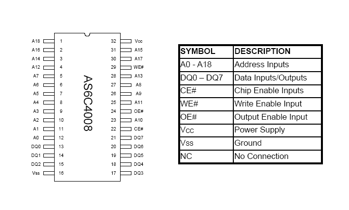

Hello,
I would make a ''homebrew computer'' based on 65c816
What is a good MMU easily purchasable, which allows you to connect to the cpu :
1 rom 8MB
1 ram 256KB (another cpu (cpu 2) must be able to read in this ram)
1 ram 256KB (another cpu (cpu 3) must be able to read in this ram)
Thanks

Something simpler would perhaps be (missing the "audio part") :
https://i.postimg.cc/hPQF9G4V/schema2.png
1 cpu
1 rom 16MB (15mo used) (is the soft)
1 rom 256KB (is for fonctionnement)
1 ram 512KB
- "inputs" it's 2pads with 2octets by pad
- a dac will receive the 300KB stocked in ram for the image 320x240 pixels
I would use if possible the addresses:
000000-EFFFFF (15MB) for rom1
F00000-F7FFFF (512KB) for ram1
F80000-F87FFF (256KB) for rom2
What do you think ?

I think a bigger problem here is the DMA, not the MMU.
In your setup, all the MMU needs to do is to decode address lines into chip selection signals, which for 3 chips is likely going to take just a few NAND gates (or a single PLD).
DMA (direct memory access) to your RAM - i. e. reading/writing RAM by some other controller without involving your primary CPU - is a tricky thing, and it's been practiced a lot by people on these forums who want to add video output to their computers. Personally I didn't have enough guts nor experience for that..
I'm not too familiar with '816, so here are some of my personal thoughts as from someone who comes from '02:
Easiest way to go would probably be to use a dual-ported RAM - you don't need to worry about bus sharing, timings and signal propagation delays. Unfortunately, dual-ported RAM chips don't seem to be popular nowadays, which is a problem unless you're fine with using parts that have reached end-of-life and aren't manufactured anymore.
Slightly more complex method is sharing the bus by doing DMA while CPU Ф2 signal is low (this is easier to do with 65C02, since 65C816 will still drive the data bus during low phase of Ф2 to present address lines 16..23)/
Most complex method (although, in case of '816, it might be easier than previous one) is stalling the CPU, doing the DMA, and then resuming the CPU. The problem with this approach is that you cannot stall the CPU whenever you want: you must synchronize this with Ф2 signal to make sure CPU has time to finish what it's doing and release the buses for your DMA to take place. If your secondary controller is very timing-specific - e. g. if it needs to access RAM at very precise times to generate real-time video signal.

Here's a possible implementation of address decoder for your memory map using 3 74x00 chips (I'm sure some guys on this forum can take the gate count even lower):
I'm using a tool named "Digital" for simulating logic circuits such as the one above. It has lots of components (including many 7400 drivers/flip-flops, RAMs and even PLDs), and it's free and open source. Here's the circuit file that you can use to run the simulation locally: Alternatively, if you're OK with using PLDs (e. g. GAL16V8 or newer ATF16V8 - I like them because they come in standard DIP packages) - you could have a reprogrammable address decoder in a single chip. Equations for your current memory map would then look something like this:
GAL16V8
AddrDec
NC A18 A19 A20 A21 A22 A23 NC NC GND
/OE ROM1 RAM1 ROM2 NC NC NC NC NC VCC
ROM1 = A23 * A22 * A21 * A20 ; 000000..EFFFFF
/RAM1 = ROM1 * /A19 ; F00000..F7FFFF: ROM1 = 1, A19 = 0
/ROM2 = ROM1 * A19 * /A18 ; F80000..F87FFF: ROM1 = 1, A19 = 1, A18 = 0
