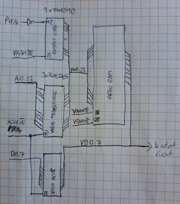

Thinking a bit about the other end of the interface, there is still a metastability concern there, as although the FIFO decouples things from the CPU clock, it doesn't really synchronise them with the video clock. It seems to be less of a problem though, and I think this can still work at full video clock speed, at least for 25MHz VGA.
My video circuits typically look something like this - this is based on my most recent one, but may not exactly match the schematics as I drew it from memory:
File comment: Typical video interface circuit
At the top left is an array of tristate counters that scan through the video memory to generate the output signal. The video address bus that they feed is also driven by an array of bus transceivers, passing addresses through from the CPU. There's another bus transceiver to pass the CPU's data bus through to the video data bus during write operations, and the video address and data buses also of course go to some video RAM, with the video data bus also going out to some output circuitry that separates pixels from the bytes of data, decodes colours, etc. I tend to output four pixels per byte, and put multiple RAM chips in parallel to get more width on the video data bus to increase the number of colours.
The video RAM has /VRAMOE and /VRAMWE signals, the counters have a /OE signal that's linked to the VRAM's, and the transceivers also have a /XCVROE signal. These used to be generated by separate logic parts, but I moved them to a simple PLD when upgrading to SVGA resolution.

For the asynchronous version, that decision needs to be based on whether the FIFO has data or not. The 40105 provides DOR ("data-out ready") that is driven high when data is available, and /SO ("shift-out") that causes the data to be removed from the FIFO on its falling edge. But I can't just use DOR directly to drive whether the write signals are active on a particular cycle, because its changes are not synchronised to the video clock - it could change at around the same time as the video clock and violate the setup or hold requirements of the filpflops. So it will be necessary to buffer it through a flipflop to guard a bit against metastability:
File comment: Metastability protection for DOR
Here we AND together the DOR signals from two 4-bit FIFOs, so that we only react when both are ready, and gate it with a clock signal that needs to rise at an appropriate time. DORS is a "synchronised" version of DOR that can drive the rest of the circuit.
DORCLK could be driven by the rising edge of PIX/4, giving two pixels' worth of time for any metastability to sort itself out before the DORS output is used - that's about 80ns at VGA resolution, or 55ns at SVGA resolution. Here's what that might look like, including the rest of the derived signals:
File comment: Video timing signals with FIFO
/SO needs to go low as soon as we decide we're consuming the data, as it's on the critical timing path - it causes DOR to then go low, and if there's another word of data waiting it could take DOR 60ns to go high again according to the worst case figures in the datasheet. We should hold /SO low for at least 30ns, but the exact timing of when it rises again isn't important and I didn't show it.
So long as DOR does turn itself around within two pixels' time, then if there's data in the FIFO, the video circuit can process another write operation on the very next cycle. This is much better than the best case in my current system, due to the increased possible CPU speed with this new system. The typical stats in the datasheet are easily good enough to do this in SVGA resolution, though the worst case stats are not; in that case, the next word just wouldn't be processed until the cycle afterwards.
As we are asserting /SO right at the start of the write cycle, we need to latch the data from the FIFO at that point, as it's going to change it - so a further 8-bit (or more) register is needed for that. This is adding back some of the complexity I thought the FIFO would save, but I think it's still efficient and beneficial to use the FIFO here.

I think I'm seeing some basic needs. On my separate video cards, the input clock speed is significantly lower than the video clock speed of 25.175 MHz. Thus a (shift) register setup makes sense: Send one byte, send another byte, send a third byte, then have it all go at once, etc. I don't need to store any additional information because by the time I'm ready to do it all over again, the video circuit has processed that LONG AGO. So, no need for a FIFO.
But your input speed is faster than the video circuit, so it is possible for the computer to outrun the video circuit. Thus the need for the FIFOs.
Nathan (Paganini) mentioned dual-port RAM. I know the size of those are far too small to be useful in a larger 'graphical' setting, especially anticipating colors, but could it itself act kind of like a FIFO? Or replace it. Just an idea here, but if you were to write to the dual-port RAM address data, color data, commands, sprite data, etc, the video circuit could pull from that like it would from a FIFO. You'd probably not use all of the dual-port RAM, but it might be within your speed capabilities and reduce chip count significantly.
Ultimately you know what is best. I learned all of my video circuitry from you George, and I am very grateful for that. Everybody has a particular favorite focus, and mine is video, and so I have you to thank for what I am now capable of doing. So, thank you. :)

sburrow wrote:
gfoot wrote:
I want this to work with my fast PDIP system, without needing clock stretching, so a clock speed of about 35MHz.
Oof, that's fast! I probably aught to read that topic also :)
If you prefer, I made a hackaday.io page about it, as more of a summary of where it's got to, without the history and discussions along the way: https://hackaday.io/project/192630-fast ... 2-computer
I think it varies quite a bit. For streaming simple data, the rates seem to be about the same - the video circuit can read at about 6MHz, and the CPU can send at about that speed, given its overheads. But usually the CPU needs to do quite a bit more work before it has the data to send - e.g. loading it from somewhere in memory - and so the CPU will be the bottleneck. But then, if/when I upgrade the GPU so that the CPU sends fewer, more complex operations, the GPU will then be the bottleneck as it will take many cycles to complete those operations. So I envisage quite a bit of back and forth on this point, and being able to use the FIFOs at full speed will probably be less important in the future.
I think the more capable FIFOs that Jeff, Proxy etc have been suggesting - IDT720x series - are essentially that - a small amount of dual-port RAM with built-in address counters, and one port being write-only and the other read-only. They look like a good solution in general, I just don't like the price :)
Thanks Chad. It's also been great to see your journey, and especially the results with software you're writing - it's something I'm not sure I'll ever get around to, as it's too close to my day-job, and electronics is meant to be kind of an escape from that!
