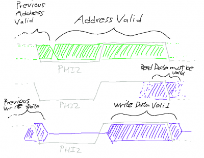

My current goal is to give the computer a way to talk to the outside world. I was gonna use the MAX3100 for this, but it seems to have disappeared during the move. In lieu of it, I'm going to use an atmega88, which will also serve as a monitor and control thing. I'll probably have it log the bus state and then also pretend to be a simple memory mapped UART.
Just to check, the address lines are valid when phi2 comes up, and the data is latched when it goes down, right?
Yup, that's exactly it:
Just a reminder that you control when PHI2 rises and falls (by selecting a clock frequency) so if your clock is too fast the address lines will not yet be valid when PHI2 rises. That only starts becoming a problem around 40MHz* so probably not a worry.
That also means you can start doing address decoding as soon as PHI2 falls and it should have settled by the time you use it (when PHI2 rises or later).

Posts: 10938
I think I'd say that the address lines are generally, usually, probably, valid at the time phi2 rises. In fact they are usually valid some time before, as the diagram indicates, and that's often useful. For example a write enable is often derived from phi2, so that writes are not directed to the wrong chip or the wrong address. In that case, phi2 is used because it's convenient - it probably won't be optimal.
(I'm not sure if I'm merely being pedantic, or if in fact confusion about Phi2's rising edge might lead to some mistake, or to further confusion down the line.)
The best timing diagrams, I think, have little arrows to show causality - not just that this thing happens after this other thing, which might otherwise be coincidence, but that it is caused by it.
