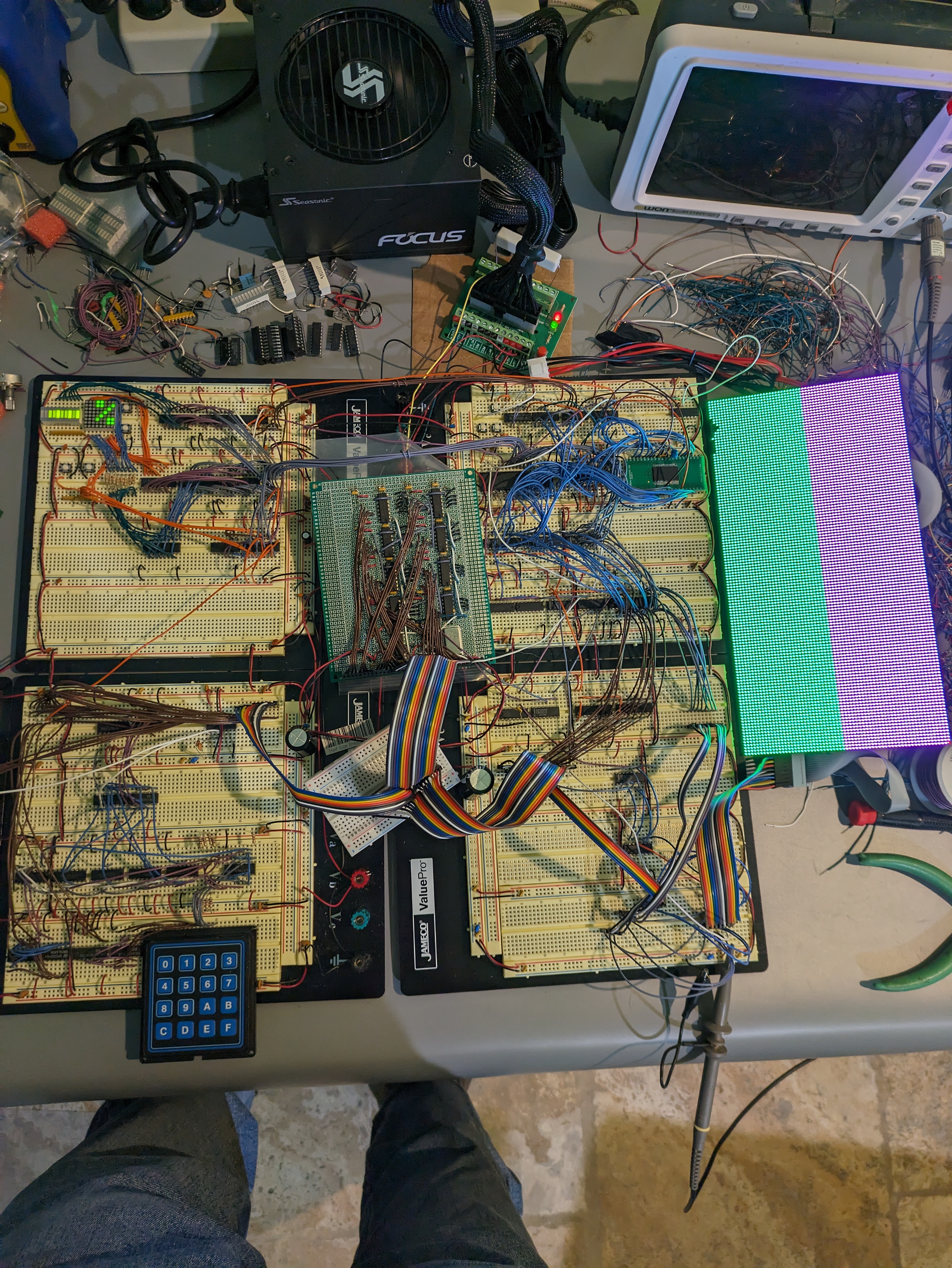

barnacle
Posts: 1831
Joined: 19 Jan 2004
Re: Locked room challenge -- bootstrapping a design and buil
Post by barnacle »
A couple of unexpected pixels: the first few leftmost of the red block, and the bottom right pixel. Are they the ones you mentioned as damaged?

Update as of 2023-09–01: Video framebuffer working, surgery on CPU module
First, for future upgrades:
Wow, evidently there are multiple much finer pitch (1.25mm / pixel) LED panel modules at reasonable prices. Do a Google search for [HAIHUANG P1.25 Indoor Led Matrix Module, (Size: 320x160mm) RGB Full Color Display Screen, 1/64 Scan, Pixel Pitch P1.25 MM, 256* 128 Pixel Dots, Perfect Solution for Indoor Advertising Use] and see what comes up. One on Amazon that I got that search from is $380, but has a long lead time and for some reason oddly lists the voltage as 240v (this seems like a mistake?). It is a 256x128 pixel display with 1.25mm pixel pitch – this would be amazing!

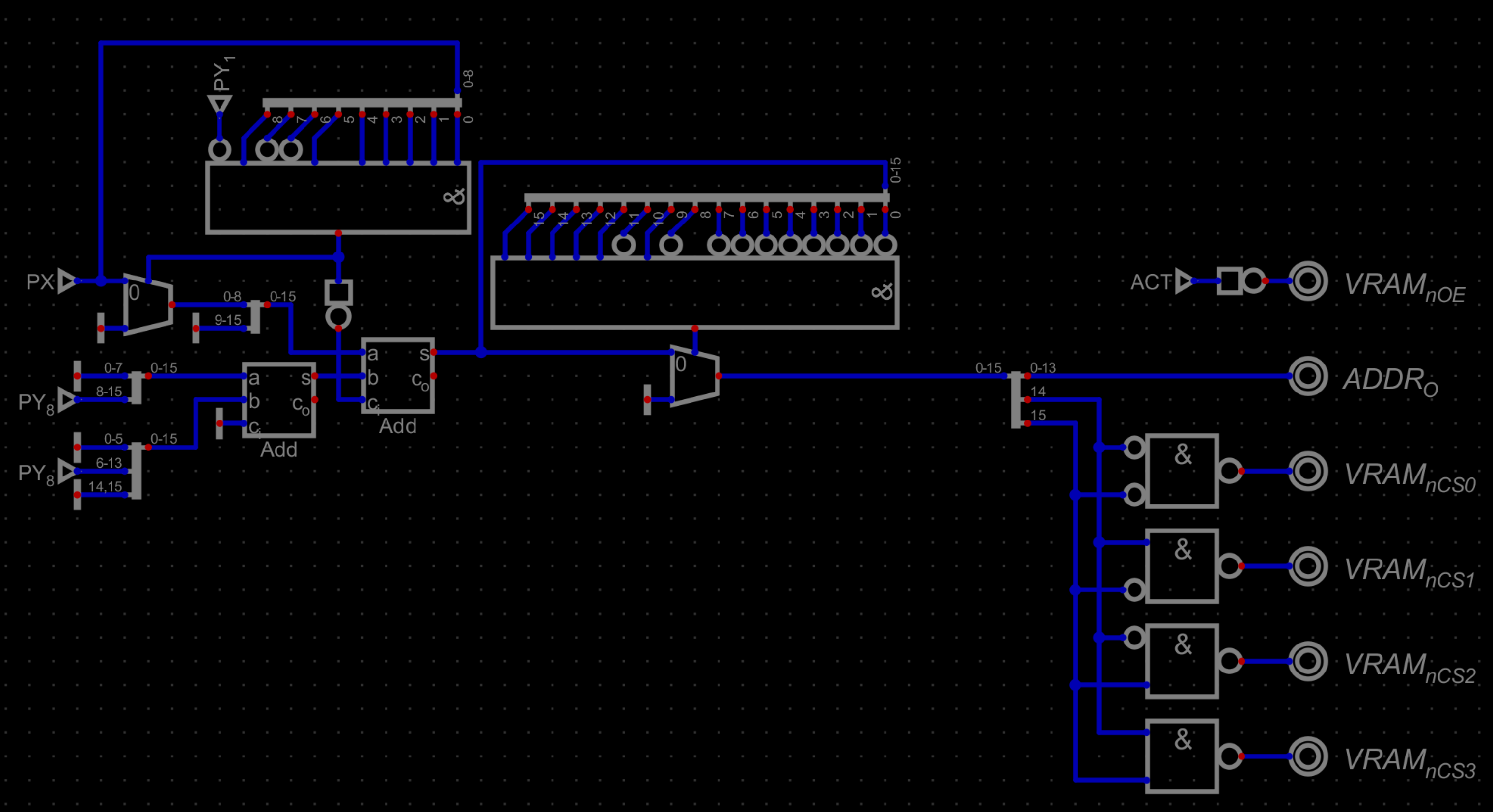

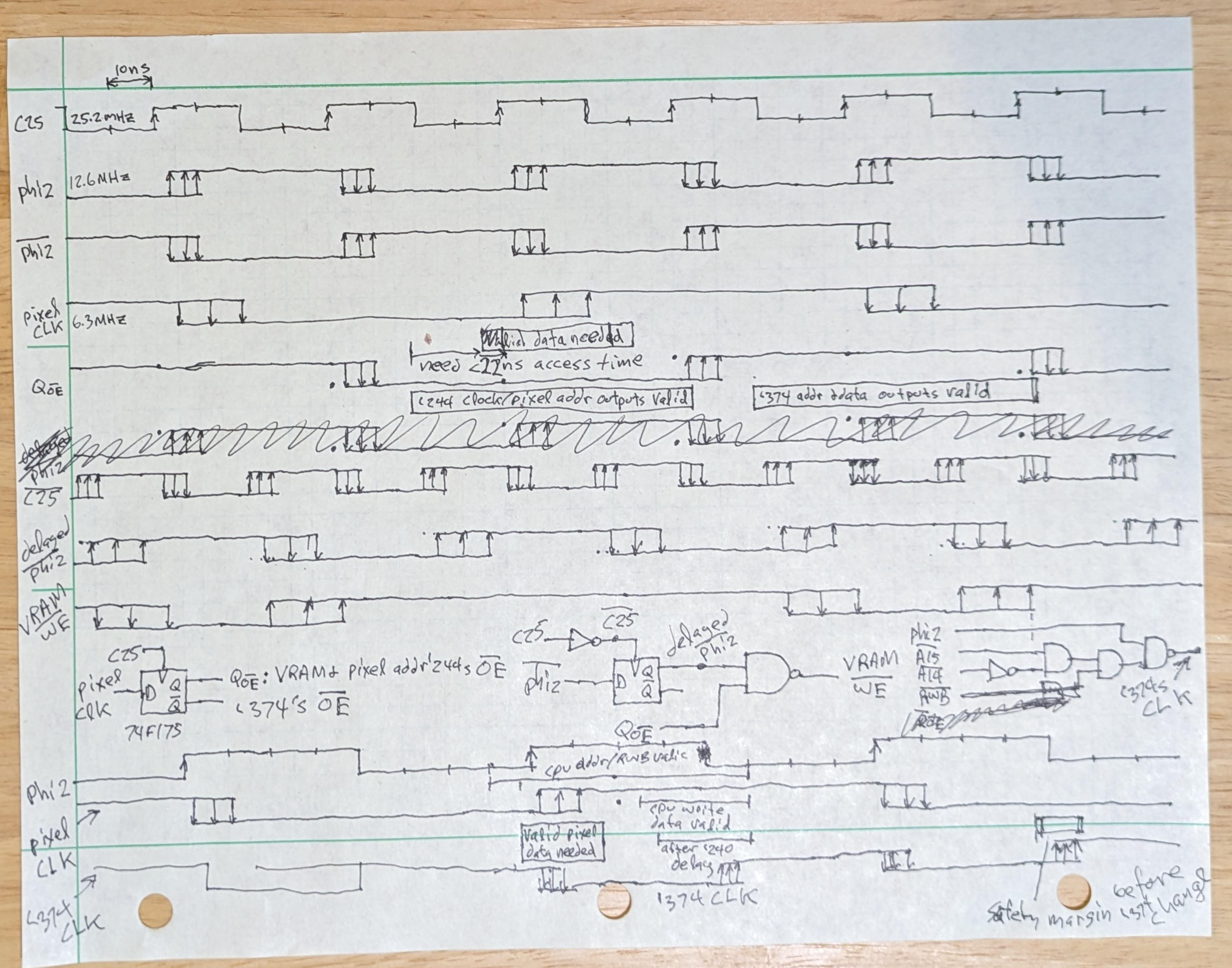

It took me a good chunk of a day to work out the timing and logic for the video frame buffer circuitry video SRAM. Even though it is separate from the CPU SRAM, it needs to alternate reading video data to pipe into the LED display and writing data that has been latched from the CPU (I am latching the CPU address and data lines, 24 bits total, into three 74F374 latches when the CPU writes anywhere in $4000-$7FFF). Here is what I eventually came up with (it is quite a busy drawing to get everything on one place – I can break this down into pieces if anyone requests it):
Timing diagrams and circuit schematics for LED module's frame buffer
The frame buffer video SRAM must have valid read data from a bit before to a bit after the LED panel pixel data-in clock low-to-high transition. In between, and not when the CPU is writing to the latches, the latch address/data lines must be used to write the video SRAM. I use some 74F175s to get suitable phase shifts of appropriate clock signals. I took into account the min/max propagation delays of all the parts I am using, which makes the timing diagrams a bit messier. It is tricky sometimes to decide from which signal’s point of view we should be showing the propagation delays. The top 2/3rds of the timing signals have the propagation delays shown from the POV of the highest frequency 25.175 MHz clock. The lower ones are shown relative to phi2. At the end of the day I did not need a lot of 74F parts to generate all the signals needed, just two 74F175s, one 74F04, one 74F00, and one 74F08.

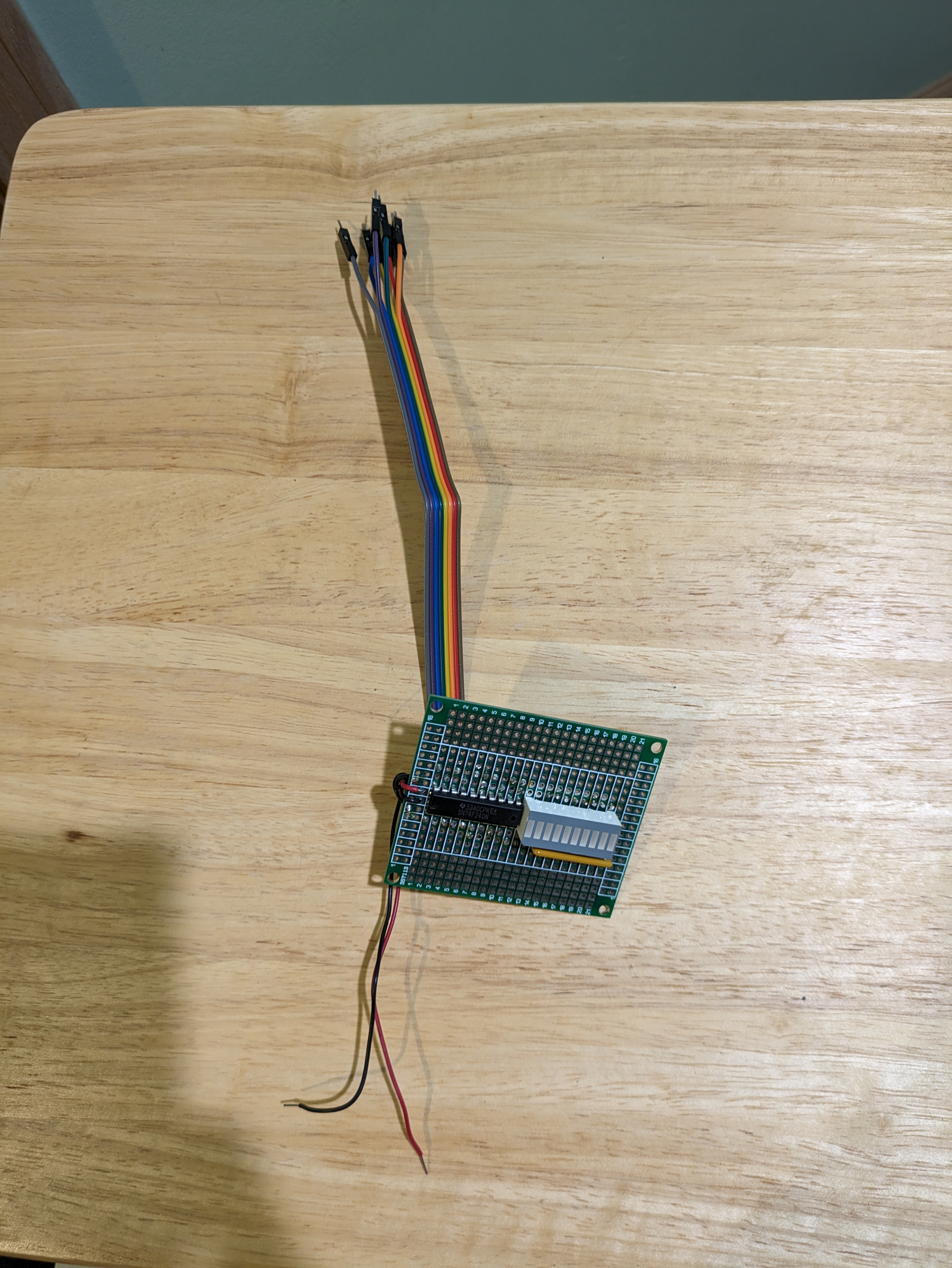

Note that I removed the CPU address/data/control line visualization section of the CPU module and put the video RAM writing/reading logic there. I did this to get better signal integrity – I was seeing some glitches when I tried to latch the CPU address/data from the LED drivers instead of directly from the CPU address/data lines. I was not using the visualization LEDs that much in any case at this point, and felt having separate byte visualization mini modules that could be plugged in anywhere as needed would be more flexible and useful:
Mini module for visualizing one byte of address/data that can plug in wherever needed

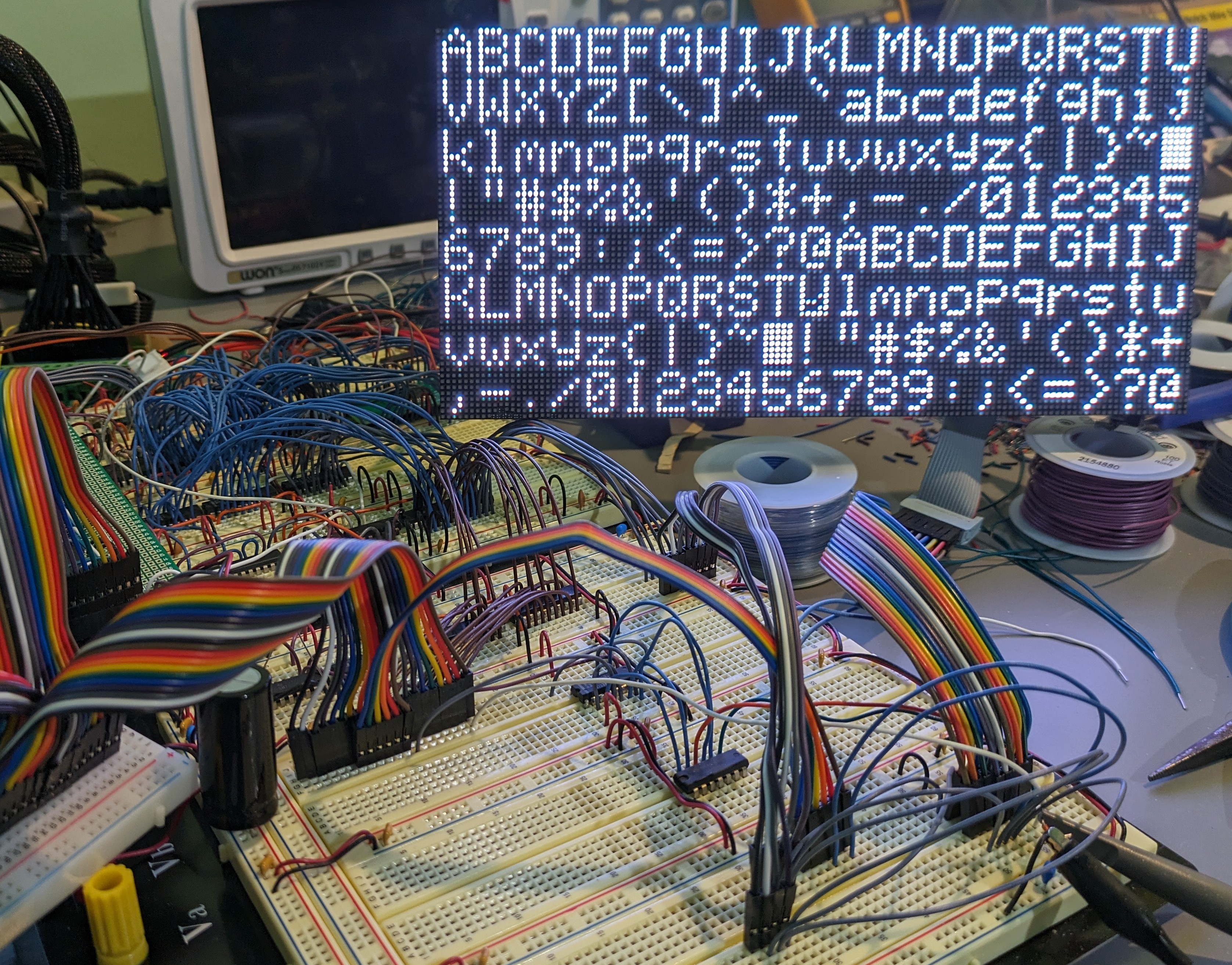

Update 2023-09-06: First font demo on LED display panel
Okay, turns out I had time this week. The frame buffer is working great, and adding that did not compromise the CPU’s 12.5875 MHz clock speed. I’ve put together some font drawing routines and made a little demo showing the 5x7 printable characters (this just loops over the screen while cycling through the printable characters):
LED panel, first demo showing 5x7 font
One little gotcha I should have anticipated: the frame buffer rows in memory are off by one relative to the physical position on the LED panel. That is because I’m loading the pixels for a row while displaying the previous row, but I use the loading row’s address as the display address. I would need to add an extra chip to fix this, for example a latch that delays the use of the row address for the display by one row. For now I just fixed this in software, which involved adding one DEC instruction.
With the 5x7 font, I get 8 rows of 21 characters each on this 128x64 LED panel. This will be really cramped to try and do assembly language programming. I could go with a tiny, barely legible 3x5 font, which would give 10 rows of 32 characters each. That would be a usable number of characters for 6502 assembly. I could also combine multiple panels, as these are meant to tile without seams into larger displays. Or I could buy a larger 256x128 panel with the finer 1.25mm pixel spacing.
