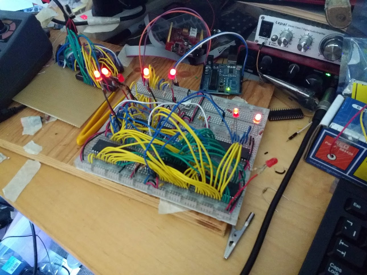

PostPosted: Sat Sep 02, 2023 4:58 pm
Joined: Mon Mar 06, 2023 9:26 am
Posts: 88
Location: UK
IT'S ALIVE!
Pictured is the Wren Prototype running my sanity check program at full 1mhz speed. The program consists of loading from the VIA's port A (inserted for low speed test runs to make sure the VIA was working), then writing 1 to DRRA and port A, followed by an endless loop. As can clearly be seen here, it's working.
The LEDs are (in order, left to right) read/write, a15, /ROM select, /IO select, /VIA select, SYNC, VIA PA0, and a testing LED that I was poking the buses with on single-cycled runs.
