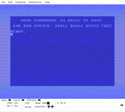

Onno Kortman has taken semu (https://github.com/sysprog21/semu), a minimal RISC-V emulator, and cross-compiled it with llvm-mos (https://llvm-mos.org/wiki/Welcome), an LLVM port to the MOS 6502 processor, in order to run Linux on the Commodore 64 with REU. Kortman writes: "The screenshots took VICE a couple hours in 'warp mode' to generate. So, as is, a real C64 should be able to boot Linux within a week or so."
https://github.com/onnokort/semu-c64
Click the image for animation.
File comment: Animation of an emulated Commodore 64 with REU loading Linux
