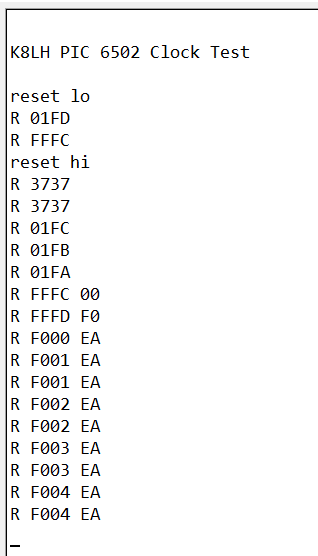

Is there a cycle by cycle guide to the reset sequence of the wdc65c02? The datasheet merely indicates that the reset pin must be held low (active) for at least two clock cycles after the clock is stable, and that there is a reset sequence lasting seven clocks.
Is it a fair assumption that on the eighth clock the processor is about to execute an instruction read?

I'm not sure if it was ever documented, but it's basically running an interrupt sequence at that point, except that in the WDC 65C02 the stack writes are turned into reads for some reason. So you should see two cycles fetching junk from memory (in the interrupt context, these would be an ignored opcode and the byte after it, I believe); then three cycles reading from consecutive stack locations (pushing the return address and flags, except they'll show as reads rather than writes); then two cycles reading the reset vector from $FFFC and $FFFD, followed by the first instruction fetch.

The 65816 does document the reset sequence, and that is exactly what it says (except there's an extra write for PBR in 65816 mode).
I looked at BRK on an NMOS 6502 many years ago, and that was the same. I'm as certain as I can be without getting the logic analyser out that reset, IRQ, and NMI on a 65C02 will be the same too.

It's just as gfoot described. Here's what I've used for WDC and Rockwell 65C02 devices. Note that the uPull() function waits 500-nS, takes the CLK pin lo, waits another 500-nS, then takes the CLK pin hi.
The eighth clock cycle is an instruction 'fetch' from the address that you 'pushed' to the 6502 during clocks 6 & 7.

For some reason it takes eight clock cycles for the reset sequence instead of seven clock cycles if the clock pin is low when you raise the reset pin.
In the datasheet RESB is classed as a "processor control" signal along with IRQB, RDY, etc, and the timing diagram shows them being sampled near the falling edge of the clock, so I think it does make sense that if the clock is already low you need to wait for the end of the cycle before the processor will react to RESB going high.
