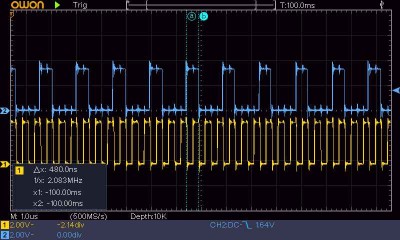

Aside from that I actually had a huge win today! What I did was, wired up a Raspberry Pi Pico and programmed it to be a big ROM (for the moment, RAM is the next step which should be pretty trivial) and am making the W65C02 run directly from that, with no additional components. Even the clock is supplied by the Pico.
For me, I think this will be an invaluable setup initially, as I will be able to prototype things faster (in theory :lol: ). No flashing of ROM's etc, just drop the 6502 code on to the Pico and off you go.
With some very tight coding I have this setup running next to me right now at 2 MHz! Again, the actual 6502 is very basic right now as I haven't created write functionality yet.
