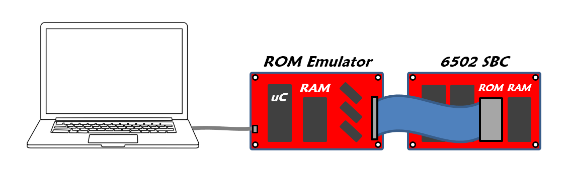

Curiousity question, please? Are you thinking about eliminating the ROM in favor of a 64K RAM system design?
Have you thought about a ROM Emulator where the ROM on the SBC is substituted with RAM from the Emulator?

Michael, no I hadn't but its interesting. Partly though I'm trying to get away from having to wire or route a wide address bus beyond the RAM. So something like your suggestion could be good for rapid development of the boot code but I'd probably not make it emulate parallel ROM, I'd probably make it just provide the right bytes in sequence like the SPI EEPROMs do.
