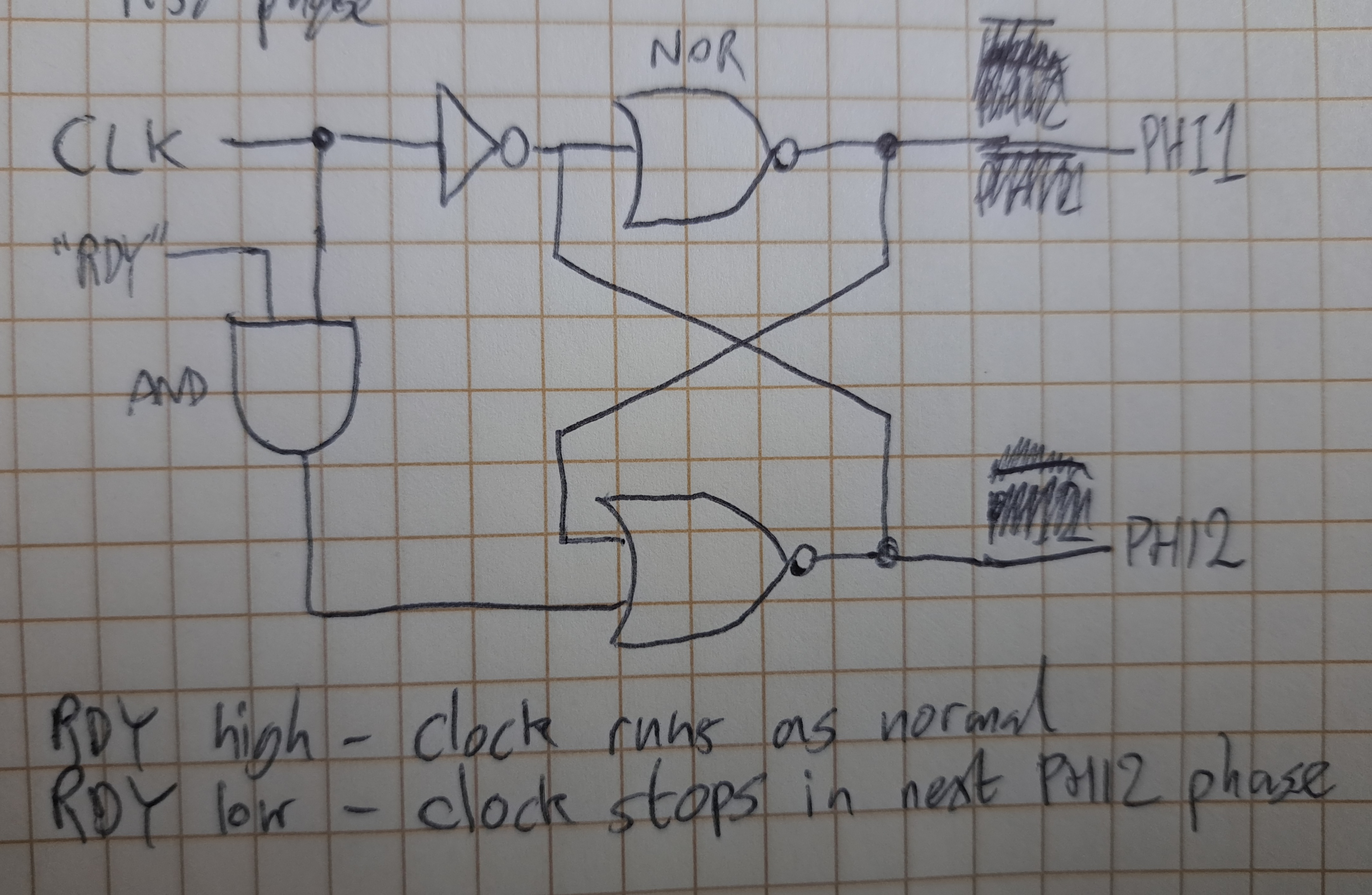

I just turned the computer off and then had another thought - is some variation of the standard two-phase non-overlapping clock circuit useful here?

Some examples of letting a RDY-like signal stop the clock:

File comment: RDY via AND gate stops in next phase 2

PostPosted: Fri Aug 04, 2023 2:40 pm

I've looked into the NOR circuit in more details, and built a timing diagram for it. Considering the use of an AHC02 and our pseudo-RDY changing during the low phase of the input clock, we get this:

It looks like it works well for stretching. Timing is a bit tricky because if it happens to go low when the source clock is already low, a partial PHI2 low is generated (see fourth cycle above).
So, it needs to only change during the high phase of the source clock. Presumably up to right before the edge. I'm not sure if two logic inputs could have different propagations, ie should RDY be setup some nanoseconds before CLK or is 0ns acceptable :?:
Assuming 0ns is, this is what it looks like from the point of view of Q/PHI2

So it would need to be stable from 17ns before the falling edge of PHI2, until 2ns before the rising edge of PHI2.
Note that this assumes a very worst case of everything taking either the maximum time to propagate, or the minimum, depending on which edge we're at. In the real world there wouldn't be these massive swings on two consecutive edges for the same IC... But the result is still the same, it needs to be stable a bit before and during PHI2 low.
Ah yes, it is not as effective as I thought - I think it handles one transition direction well but not the other.
I have experienced problems due to this in a video circuit where I was ORing together two adjacent counter outputs, and when they changed together in opposite directions (quite common of course for a counter!) it caused small dips in the OR gate output, randomly updating some dependent things that were edge-triggered.
Since then I've been more careful to not rely on that - I use a flipflop after the OR gate, or similar methods, to only sample the state of the OR at a time when its inputs aren't in flux, or create overlap between the signals that I'm ORing. I'm probably overcautious about this now.
