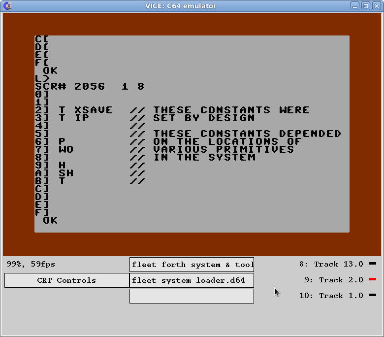

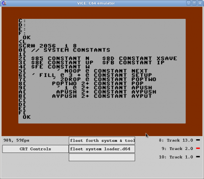

I kept putting it off, until now. Here is my initial attempt.
First, I should mention that Fleet Forth's EXPECT uses the Commodore 64's screen editor. This means that I can cursor up to a line of text on the screen and press the return key. The line of text will be received by EXPECT just as if it had been typed.
SCR is a variable in the EDITOR vocabulary. It is set by LIST and used by all the editor words for the current block to edit.
The words 0: through F: in the EDITOR vocabulary are the child words of XED . 0: reads the entire text input buffer and copies the first 64 bytes (after 0: and a space) to line zero of the current block.
There are some new versions of LIST in the FORTH vocabulary and L in the EDITOR vocabulary.
LIST and L display the entire screen.
<LIST and <L display the first 36 characters of each line.
LIST> and L> display the last 36 characters of each line.
Each version of L fetches the current screen (for editing) from the variable SCR and calls its respective version of LIST .
: L   SCR @ LIST ;
: <L   SCR @ <LIST ;
: L>   SCR @ LIST> ;
I added more comments to one screen for the assembler. This is what each version of LIST shows.

<L
SCR# 2056  1 8
0[ // SYSTEM CONSTANTS
1[
2[ $85 CONSTANT N   $8D CONSTANT XSAVE
3[ $8E CONSTANT UP  $FB CONSTANT IP
4[ $FE CONSTANT W
5[       ' NOOP @ CONSTANT NEXT
6[ ' FILL @ 3 + @ CONSTANT SETUP
7[      ' 2DROP @ CONSTANT POPTWO
8[      POPTWO 2+ CONSTANT POP
9[       ' 1 @ 2+ CONSTANT APUSH
A[       APUSH 2+ CONSTANT AYPUSH
B[      AYPUSH 2+ CONSTANT AYPUT
C[
D[
E[
F[
 OK
L>
SCR# 2056  1 8
0]
1]
2] T XSAVE  // THESE CONSTANTS WERE
3] T IP     // SET BY DESIGN
4]          //
5]          // THESE CONSTANTS DEPENDED
6] P        // ON THE LOCATIONS OF
7] WO       // VARIOUS PRIMITIVES
8]          // IN THE SYSTEM
9] H        //
A] SH       //
B] T        //
C]
D]
E]
F]
 OK
This is what it looks like on the Commodore 64.
Notice each version of LIST appends a different character to the line number. This is to support the new screen editing words.
The words 0[ through F[ only alter the first 36 characters of a line and the words 0] through F] only alter the last 36 characters of a line.
The original version of LIST which shows everything on each line is acceptable and the version which shows the first 36 characters of each line is acceptable. The version which shows the last 36 characters on a line doesn't show enough of the beginning of each line. It's almost like editing the end of the line blind. The block could initially be displayed with the original LIST and the source typed in using the screen editing words 0: through F: . The other versions of LIST and the screen editing words 0[ through F[ and 0] through F] could be used to edit the existing source.

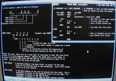

I've only used code page 437, which clearly the C64 doesn't use.  I haven't thought about how I'd use the C64 character set (including function keys), but CP437 is sure nice for the special characters, drawing boxes, and the Greek letters we use all the time in engineering (since that's what I'm always using Forth for).  The Epson dot-matrix impact printers, which Epson is still making about nine models of, use the same character set, so I use it with the workbench computer too, although they don't display correctly in its small LCD unless I make custom characters in the LCD, which I've done before but is kind of a lot of overhead.  My exception to the 437-only use is my HP-71B hand-held computer which defaults to the ROMAN8 set which is kind of similar but has different byte values for the special characters; but after the HP Thinkjet printer I was using with it went down and I started using the Epson printer, I loaded the CP437 character set into the HP71 computer so things would display correctly in its LCD.  Here are a couple of examples of my uses of the box-drawing characters:
(although that last one was for a PIC16 project, not 6502).  CP437 also lets me have Forth word names like ±½°C or 10KΩ or put Φ2 in the comments.
