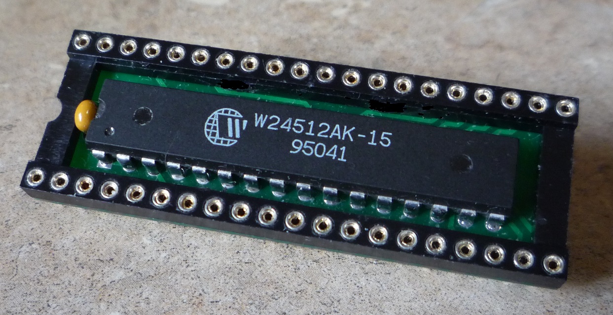

To run at 25.175MHz, I need fast RAM. My existing DIP RAM is 55nS and I need 20nS RAM which I do have but it is in 32pin SOJ package.
Might these relatively inexpensive 10/15/20-nS skinny 64K RAM chips be useful? I suspect they're 'pulls' but they're very clean and I haven't had any problems with them, so far.
The RAM chips are inexpensive enough at ~68¢ each that I don't mind soldering them directly onto a PCB underneath the CPU.

BTW, I also made a small 0.8-mm thick PCB with a 64K RAM chip that fits onto the shoulder of the pins on a 40-pin machined pin socket intended for a 6502 CPU that might be used to simplify PCB routing and reduce board space. You could solder the socket with integrated RAM directly onto a PCB or place it in-between a CPU and existing CPU socket (I'd be happy to send you a PCB, if you'd like).

I think the fast skinny DIP RAM is very nice and cheap. It can be tucked under flash or CPU as you’ve done. I’ve a roll of SMT 128K RAM, that’s why I used it extensively. I’ve made an DIP-SMT adapter (https://www.retrobrewcomputers.org/doku ... rds:no-ps2) but I’m out of the adapter that’s why I manually wired one for this experiment.

Just thought I'd mention it as a simple low-profile solution. I thought about using the method for a mini' SBC by stacking sockets (see below).
BTW, that AliExpress vendor also sells 15-nS skinny 128K RAM chips for the same price (about 68¢ each).
