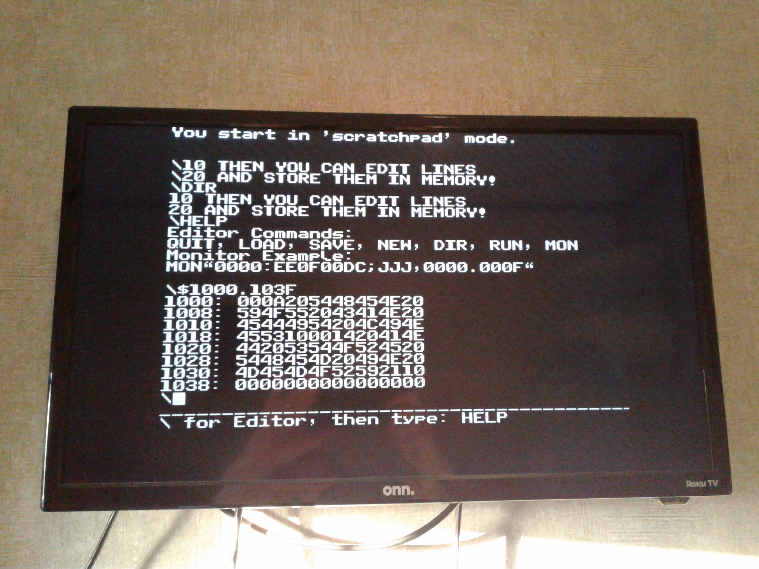

Coming from my SMD soldering topic, here:
viewtopic.php?f=1&t=7629&start=30#p101467
It works! And the first time! :)
I've done some modifying to the code and structure since the last posts, so here is a refresher/update:
This is an Arduino "shield" that displays characters through VGA, has access to a PS/2 Keyboard, and uses an SD card module for storage. I have a fully populated W65C02 assembly code emulator/simulator inside of the Arduino's ROM (well, minus the RMB, BBR, TSB, and TRB codes). I also put a line editor in there, so that I can eventually run BASIC or some such on it.
Right now it has a flavor of Wozmon inside the line editor. That means you can type out, modify, run, save, and reload a number of monitor commands. Or you can directly access the monitor commands with the $ symbol.
The memory map has changed a bit. $0000-$01FF (duplicated to $0FFF) uses the Arduino's internal RAM which is very fast. $1000-$1FFF (duplicated to $FFFF) uses the display RAM which is very very very slow in comparison since I'm accessing it serially. The 512 bytes on the Arduino's RAM can be saved and reloaded from it's own internal EEPROM, while the rest of the memory gets sent to the SD card for storage.
This module can also be used as a 'dumb terminal', connected serially to a different 6502 unit, or even the PC. You type on the PS/2 keyboard and it sends ASCII commands. You send it ASCII commands, and it displays the results on the screen. The vertical scrolling is software based, but because it also uses the internal RAM, it is quite fast and responsive.
I plan on adding BASIC to this, as well as Tetris.
And that's it for now! Thanks everyone!
Chad
