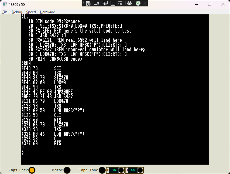

Re: A truly self-modifying JSR
Post by dominicbeesley »
Gratified to find that my unfinished Electron emulator passed! TBF I cribbed the pseudo-mico-code for the cpu from MAME.
