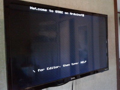

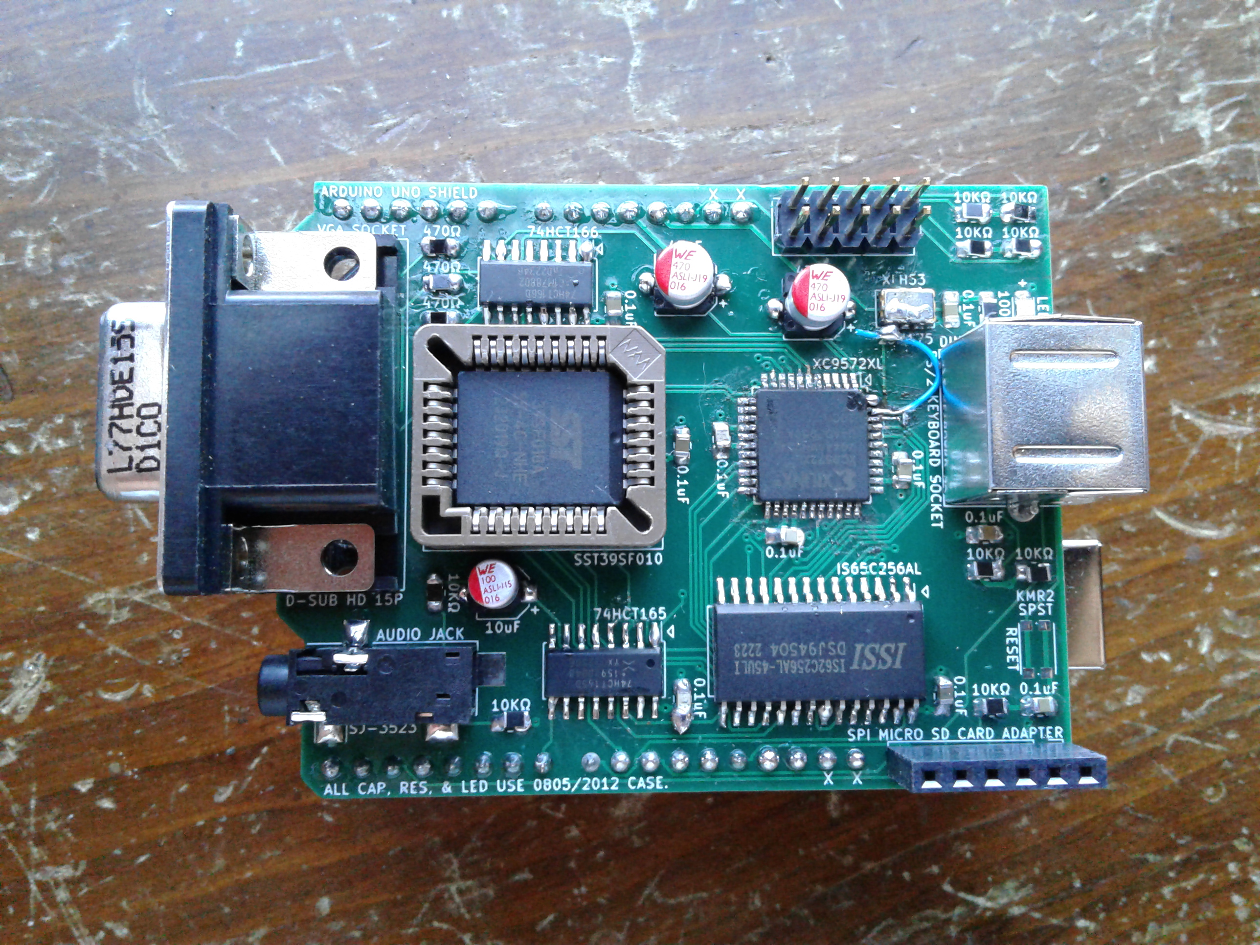

Attached are some pictures. I have learned so much about solder SMT stuff! Here's a small list:
1) Those 0805/2012 resistors and capacitors are WAY TINY! I'll be going with bigger ones in the future.
2) Film resistors are really flat! I like them standing up higher.
3) SOIC chips are a piece of cake. I had some solder bridges here and there, but it was easily fixed with either a super hot soldering iron or some solder wick.
4) Less solder is more effective. You only need a *tiny* amount for each pin. I wasn't used to that.
5) The special tweezers I got for this were bent within a half hour. I don't know if I'm just not used to them, or if they were not great quality or something, but yeah, I'll have to figure something else out in the future.
6) I had a little headlamp+magnifier, and wow, that was super important for that CPLD. I used that nearly the entire time, until I got to the through-hole stuff of course.
7) The SRAM chip had a wider spec than what KiCad supplied, and I am thankful I made those pads longer! It barely fit even after I doubled each pad's width!
8 ) Those SMD oscillators seem easy enough, and they are, but the pads from KiCad were basically meant for stencil + paste. Oh that was so annoying! Things you just don't think about, I guess.
9) That TQFP-44 CPLD was a PAIN!!! I would bridge the pins almost automatically. The solder wick helped a lot, and that was my main method of removing it. BUT, before I got wise, I was stupid, and ripped off one of the corner pins, as well as break a trace on the board. Oh, SO annoying! That tiny bodge was a 1 hour ordeal. I actually *threw* the board once because it was just so difficult. But then I picked it up and kept going :) I want to practice more on those and get better with the solder wick method. I was hoping my soldering iron was hot enough to just melt the access away, drip it off using gravity. That was NOT the case, my soldering iron apparently just doesn't get hot enough for that, or maybe I need an even more fine-tip soldering iron tip. [ You can see my tiny blue bodge wire in the top-down picture. ]
10) I had fun learning. And that's important!
So, this tiny little board took 4 hours, mainly on the CPLD and those tiny resistors and capacitors. Every through-hole component was like a reward for all the pain I had with everything else.
My future in SMT land is just beginning, but I'm definitely going to consider a bake/skillet method for that CPLD. It would save a lot of time and issues. The rest are totally doable by hand as long as you get the right parts and pads.
I'll be posting more about my 6502 code monitor/editor on it's original post, here:
viewtopic.php?f=4&t=7642
It worked the first time!!! Thanks everyone! :)
Chad

First of all, congratulations on diving right in and coming out the other side with a working board! As you've already discovered, most mistakes you might make are fixable and you now have an appreciation and understanding of some of the techniques used to fix these issues so they won't be as scary on your next board.
I do see one component that may not be fully soldered - if you haven't found it already, you should check the 10K right over the "KMR2 SPST" RESET switch (not populated). I don't see a meniscus up to the left end resistor.
0805 is the "larger" size in my work, but I make circuits that need to fit in very small spaces. By all means, order a size that you are comfortable with.
Yes, it's tiny solder for tiny parts. Using a stencil helps with that as it puts the right amount for each pin. I use 0.015" solder for most of my SMD work when hand soldering.
The most important thing is to never push, prod, or pry with them with any kind of force. When you are used to working with pliers, where you do all of those things, it can take some getting used to. If it's going to bend a piece of thin wire, it's too much force. I recommend getting a cheap set of stainless steel picks (eg. dental picks) for all of your poking, scratching, and prying needs.
You don't need to stop using magnification for through hole work (assuming your setup is comfortable and your focal range is reasonable so you don't have to hunch over) - it makes that work much easier as well because you can watch the solder flow and get a perfect joint every time. If you see yourself doing a lot of this, I would recommend you at least consider a stereo inspection microscope. It's way better than the head mounted magnifiers, but it's also an order of magnitude more expensive.
When using parts I've never used before, I will often print (on paper) a 1:1 copy of my board and physically place the parts on the paper to make sure I haven't missed anything. Of course, that only works if you have the parts already. Also, it is possible to put "wide" SOIC parts on narrow SOIC pads with a bit of extra work:
File comment: Wide SOIC soldered to narrow SOIC pads at an angle
These will simply take practice, and you've already completed practice session #1. After a while, this pitch will be easy and you'll be cursing at even finer pitch parts with even more legs to get solder bridges on. Also, it may be comforting to know that even those of us who do this work for a living have all of these exact same issues. It's more important to know how to fix a solder bridge so that, when it inevitably happens, you don't worry about it and just fix it.
Your bodge looks reasonable. For hobby work, you just need to get the things that should be touching to be touching and keep the things that shouldn't be touching from touching.
Once you get to that stage, you'll find its faster to just place all of the passives while the board is already pasted and then after reflow it's all done*
* after you fix the shorts and the parts that shifted wrong and the parts that tombstoned....
Your adventures up to this point will still be worth the hassle, as you are still going to have to fix shorts and open circuits - you just will have less of them to deal with if your reflow process goes well. I do recommend getting a good flux and using it when battling shorts - it will help the solder flow back to the places it's supposed to be.
I use SMD291 from ChipQuik (not sponsored) because you can dispense to just a single IC leg (it comes in a syringe), it stays where you put it, it cleans up with isopropyl alcohol (not all fluxes react well to IPA), and it lasts for over 2 years without refridgeration so you can just leave it on your bench next to your iron. I give the syringe a tiny squeeze until a little comes out the tip, and then a dab it where I want it. For SMD work, you don't need much but you should have some flux if you are reheating a joint (will help prevent that "solder icicle" you get when you pull the iron away).
Unless you go gung-ho, even the smaller 5cc syringe (part# SMD291NL) should last a long time and might be a good start (if you don't already have flux) to see if you like it. Also, check your desoldering wick and make sure it has flux in it. If it doesn't say something like "Rosin" or "No-Clean" on it, then you should be adding flux when you use it.

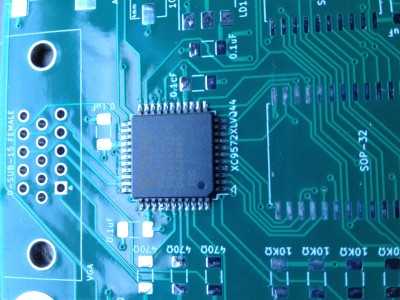

PostPosted: Fri Aug 04, 2023 12:44 am
Posts: 718
SamCoVT wrote:
... remove skillet from heat and (patiently) let it cool and it will look like it was soldered by a pro. You may still need to fix a solder bridge or a connection that didn't flow properly, but you'll usually have a lot less of those than you would get by hand soldering.
Yep! Perfect, just like you said, thank you Sam. I was re-playing your post in my mind while doing the whole procedure, and attached is a picture of the outcome! Here are the steps in brief, just so others will know:
1) I got a thin steel stencil for the QFP-44 10x10mm part matching my Xilinx CPLD XC9572XL part. I also got "no clean" leaded solder paste with a melting point of around 360 degrees Fahrenheit. I put the solder paste in the refrigerator until I was ready to use it.
2) I taped the stencil down to the board with painters tape, made sure it would be easy to remove without shifting things.
3) I applied a tiny amount of paste on all of the stencil holes, then wiped it around with an old plastic card. I think I didn't apply enough, so I did more and made sure it was all filled in as much as it could hold. It didn't *look* filled in completely, but it was fine. Some paste got on the board itself, so I wiped it off with a paper towel. Also, the stencil had extra long pad holes, but my KiCad pads were shorter. So basically I had paste on the soldermask, but apparently that didn't matter in the end.
4) I removed the stencil by removing one side of the tape, then rotated the stencil up away from the board. It either shifted some or the paste melted a bit, because it looked like it was generally one big blob with indents, kind of.
5) I took fine tweezers and put the CPLD where it should be. I got it almost right on the first try, but I did have to shift it a tiny bit. Again, it looked like it was just sitting in a blob of paste, I don't think I was looking at soldermask between pins at this point.
6) I put an unfolded piece of aluminum foil on a single burner on our glass-top stove. I had tested temperatures beforehand with a cooking thermometer directly on the burner surface, and so I knew where to turn the knob before hand. I was wanting it to reach the 360 degrees and then just past, and that was about half-way for me.
7) The board was heating up pretty quickly, so I slightly adjusted the knob for the burner. Then I cranked it up to my preset position (half-way), and watched it while keeping the cooking thermometer nearby. I was wondering if the board wasn't sitting fully on the burner, so I went to get a butter knife to press on the board. When I came back, the solder was already melting. Within literally 3 to 5 seconds or so it looked perfect.
8 ) I pulled the foil+board from the burner, and turned it off. I let the board sit for a bit. I noticed that there was a *tiny* bridge between two pins. After cooling for a minute, I tested it with the multimeter and yes it was a bridge.
9) I heated up the soldering iron to the hottest I could get it. I then touched the soldering iron tip to the pins that had the bridge and... poof it was gone! Yep, I didn't even use solderwick, it just disappeared :)
10) I thought I saw one pin that didn't have enough solder (unlikely, but whatever), so I touched it with the soldering iron too and it seemed to be fine, I think.
So! The hardest part for me to hand solder is no longer the hardest part at all! Golly, if I did this for ALL of my SMD parts, that would make things super fast and super easy! I used hardly any solder paste while doing this, it was all done in less than 5 minutes, and it looks professional.
Tomorrow I'm going to solder everything else by hand. Will make a topic about the board itself soon.
Thank you everyone, and thank you Sam in particular. That went so well, I am very pleased by the results! :)

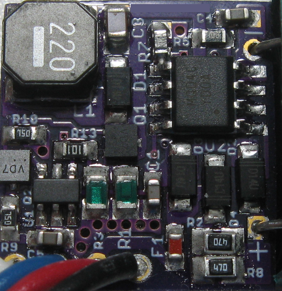

A little more practice Chad and you'll be doing things like this in your sleep... U2 is 2mm square, has eight concealed pins and a required ninth pad underneath. It was a stinker the first few times, but solder paste with flux and cautious hot air sorted it. It throws out half an amp at 3.3v from up to 17v input :mrgreen:
