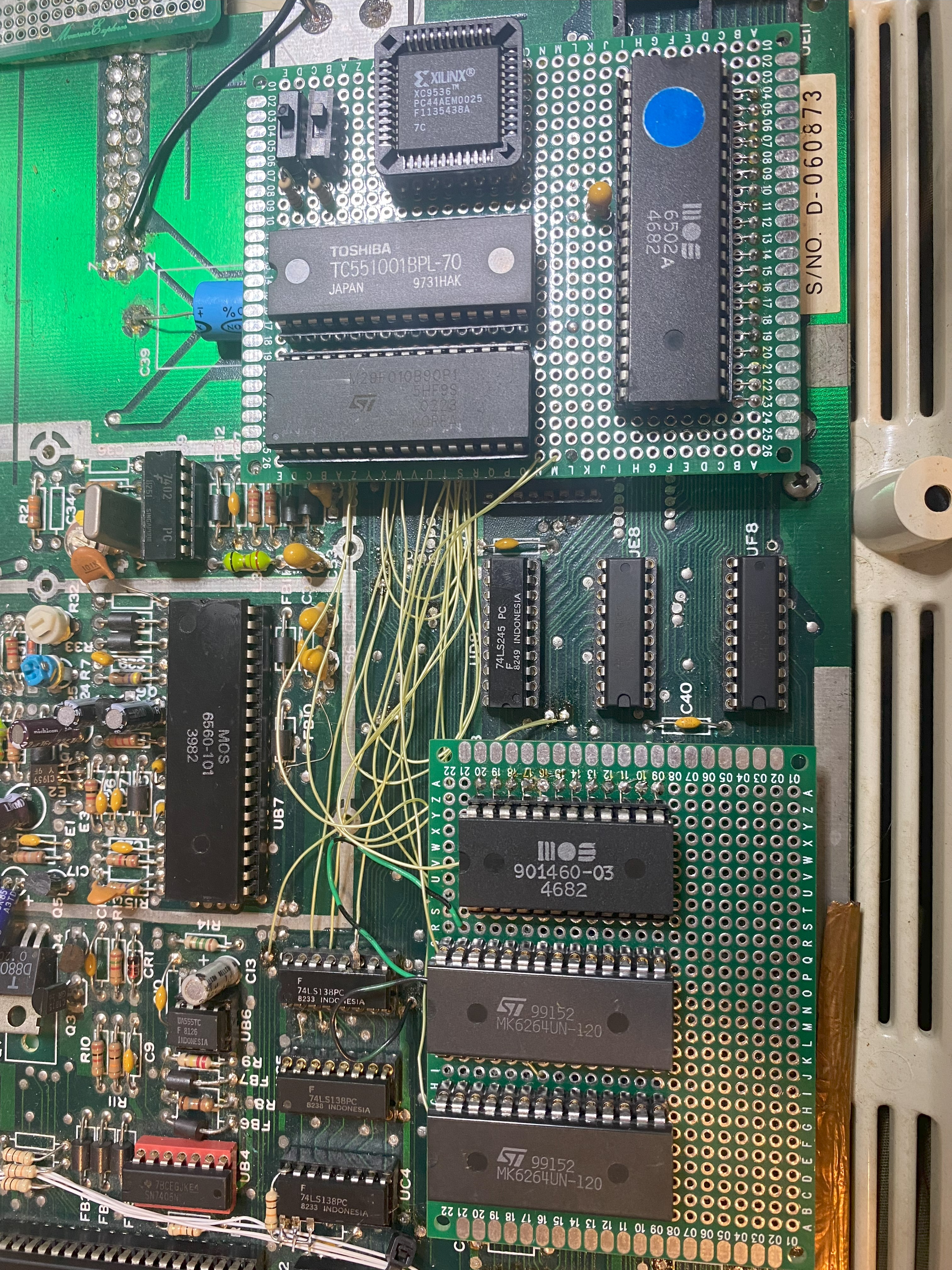

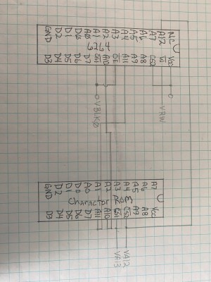

This is a basic hookup of the internal 8K ram to the character rom. VICBNK0 would drive the first 8K SRAM. Add another 8K to this board and you can use the RAM under the character ROM.

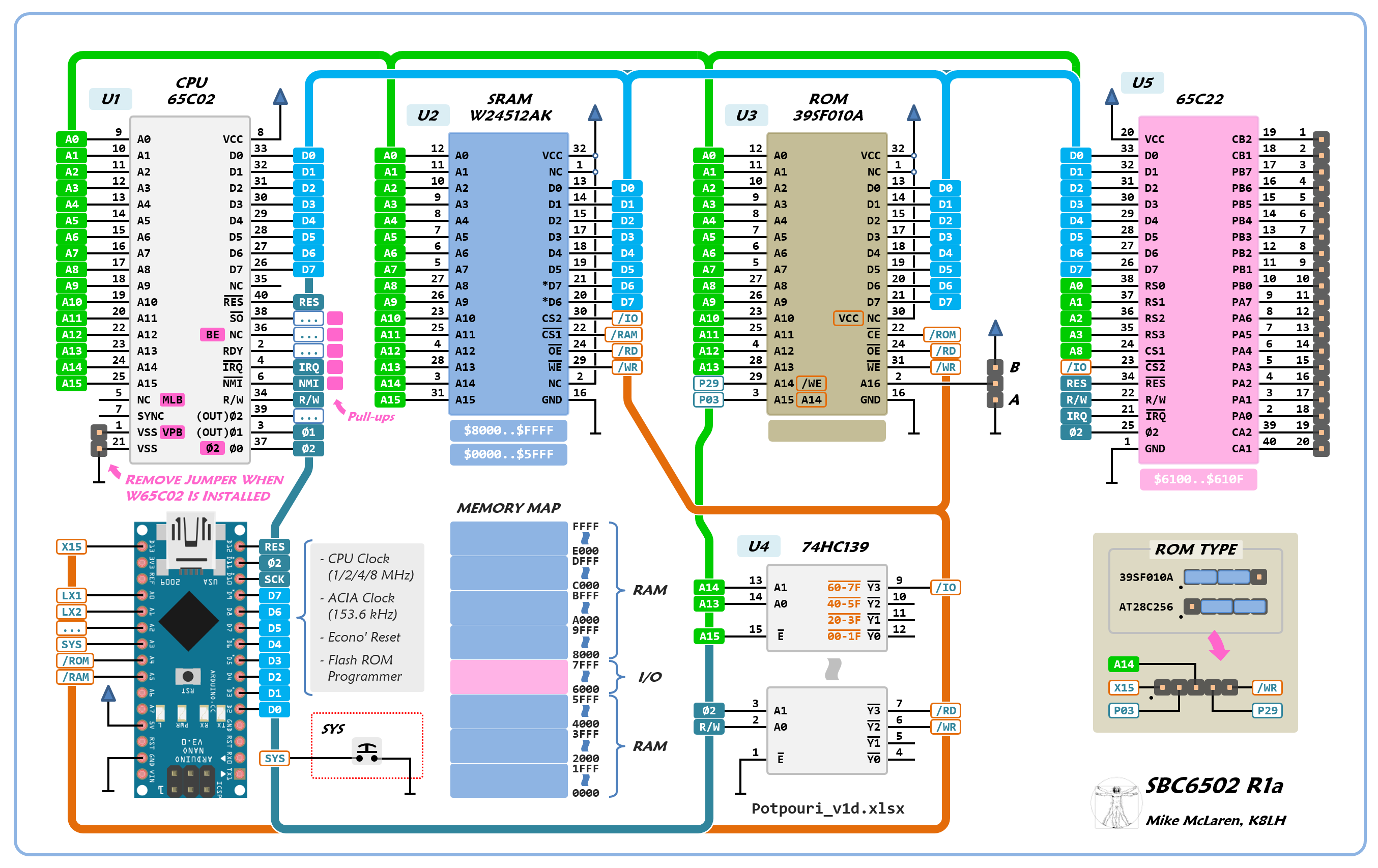

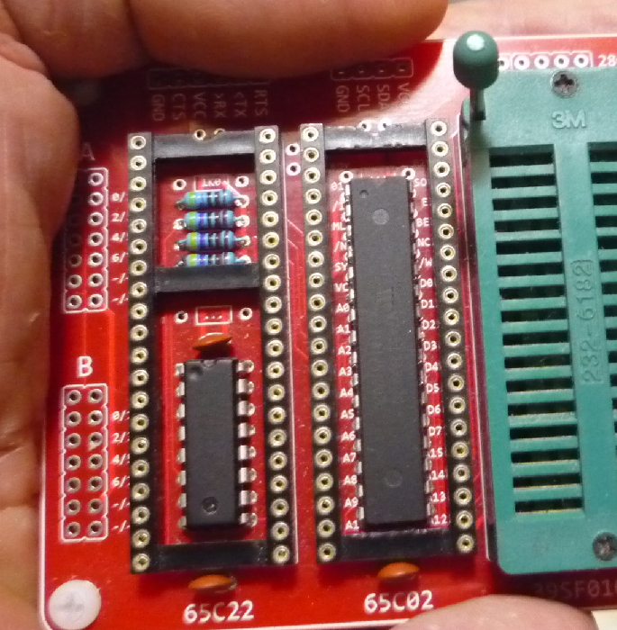

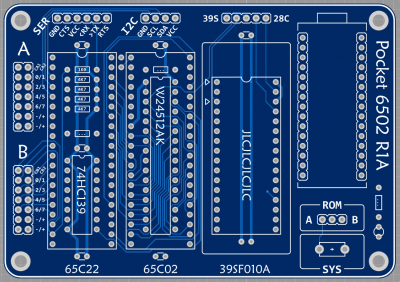

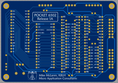

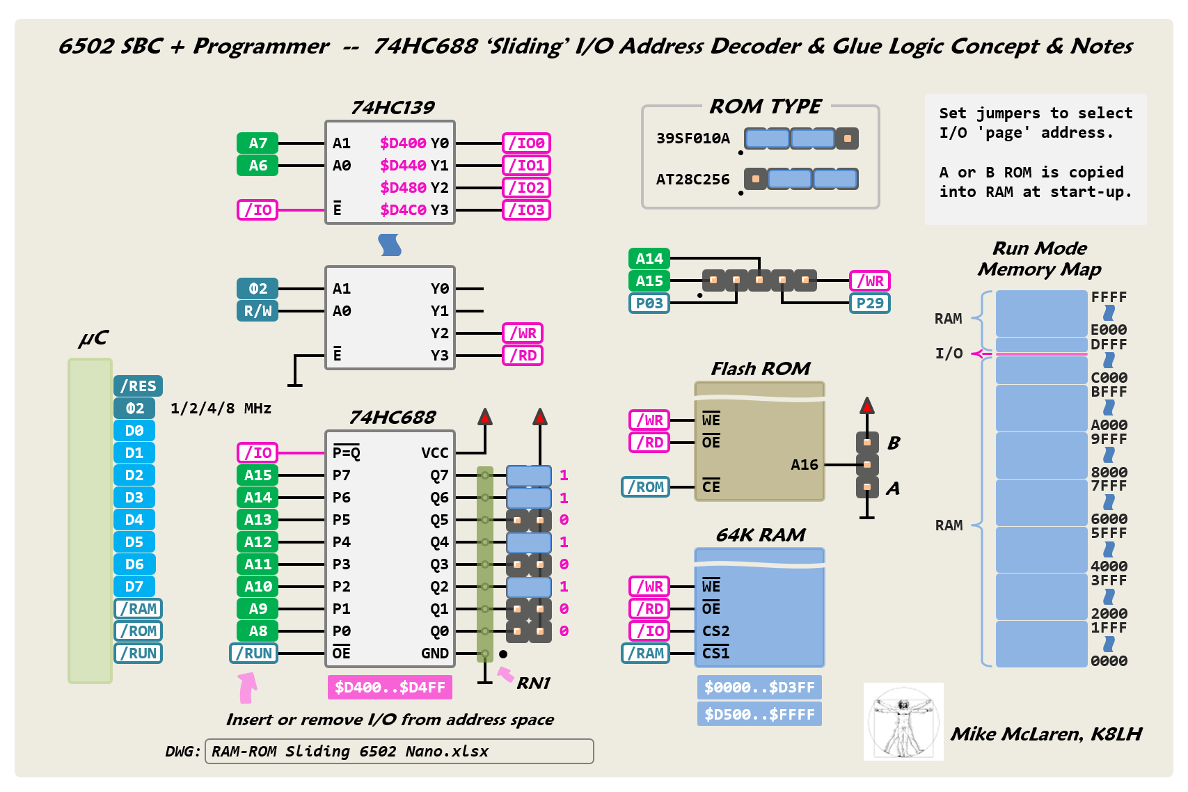

One alternative, if I may? My current SBC project reduces a normally large external microcontroller-based ROM Emulator / Programmer board to its functional essence in the form of a $2.50 Arduino Nano clone installed directly onto the SBC. The SBC is similar in function to the "whole basic computer" in Garth Wilson's "The Primer" and includes a CPU, a VIA, a 64K RAM, a 128K Flash ROM (divided into 64K 'A' and 'B' sections), and a 74HC139 for the 'glue' logic. The ROM Emulator / Programmer (Nano clone) copies the 64K 'A' or 'B' ROM into RAM during power-up or reset at a leisurely sub 1-MHz rate to support the use of slow ROMs and the SBC runs entirely from the 64K RAM with a 1, 2, 4, or 8 MHz CPU clock (supplied by the Nano). You can also load hex files from a Terminal Program on a PC through the ROM Emulator directly into RAM for iterative code testing and a 'long press' on the <SYS> push button will take the 6502 out of 'run' mode, invoke the ROM Emulator / Programmer, and program the selected 64K 'A' or 'B' ROM with the current 64K RAM image (takes about 9 seconds).
To install Nick Gammon's G-Pascal system into the 'A' ROM on my prototype I simply loaded the G-Pascal hex file into RAM and performed a 'long press' of the <SYS> push button to program the ROM with the contents of RAM.
I'm expecting the first production boards this week (see below) and I'm hoping this might be an economical entry-level 6502 SBC for newcomers. I've also attached notes for a future SBC with the '688 decoder chip like the one you're using.
Good luck on your project. Cheerful regards...

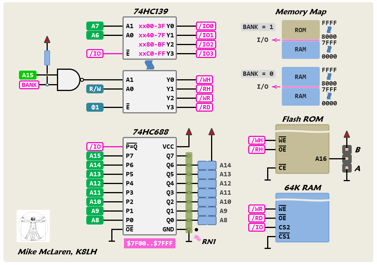

I understand. Some of our most esteemed members dis Arduinos while admitting they've never used one. I'm guessing many newcomers and electronic enthusiasts may come here looking for more economical alternatives to Ben Eater's $200+ kit package and may be less biased and perhaps already familiar with or using Arduinos (or other microcontrollers).
As I said, your method is simple, clever, and elegant and a variation might use half of the 74HC139 to provide clock qualified read and write strobes instead of RAM and ROM selects and the other half of the '139 might be used to provide I/O strobes.
Good luck and have fun...

...a variation might use half of the 74HC139 to provide clock qualified read and write strobes instead of clock qualified RAM and ROM selects and the other half of the '139 might be used to provide I/O strobes.
That is slickety-doo-dah. I love it!
