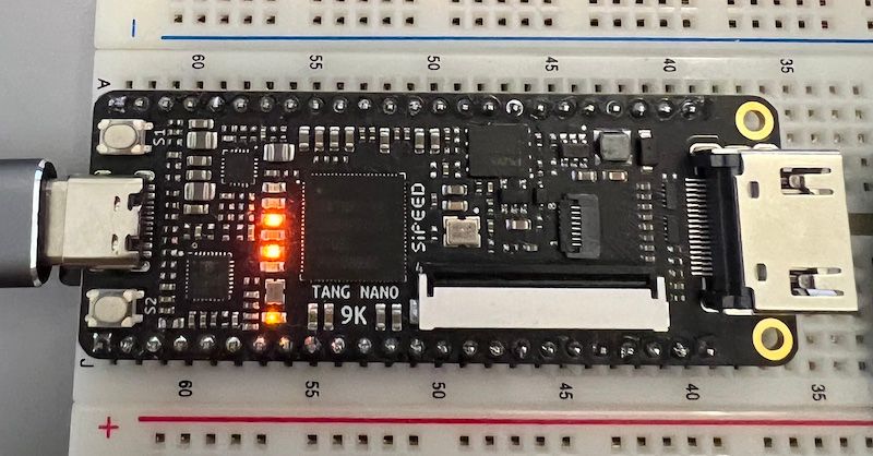

Have you considered the SiPEED Tang Nano 9K modules:
https://wiki.sipeed.com/hardware/en/tan ... no-9K.html
This module has a wide 40-pin DIP form factor, approx 9K LUT4s, 52KB of Block RAM and 76KB of User FLASH. They are also pretty cheap.
Smaller (1K/4K) devices are available, and very recently they have launched a Tang Nano 20K
https://wiki.sipeed.com/hardware/en/tan ... o-20k.html
Dave
Thanks for pointers, these links are very much appreciated. I'm very new to FPGAs, and there's so many of them!
/Andrew

I think the Tang boards are the new GODIL, in some ways. Except the GODIL had level shifters on board wheres the Tang boards are 3V3.
