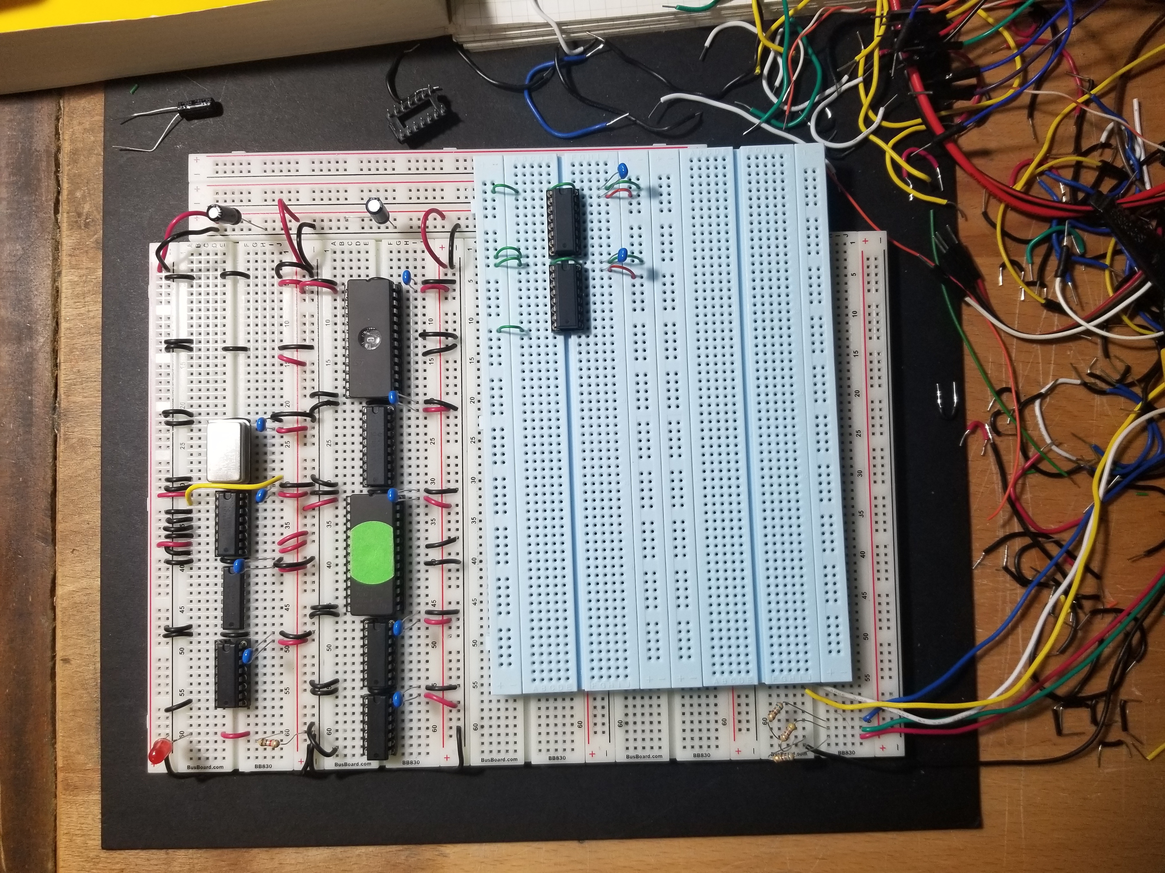

Edit: Here's a side-by-side of my older array of BusBoard breadboards, along with my newer Twin Industries ones (the blueish ones). I went ahead and paid a dollar or two more for the "high temperature" breadboards, not because I'm planning to operate at high temperatures, but because I really like the round holes. Internet articles about breadboards say that round vs. square holes is just personal preference and makes no difference in how the wires insert. I don't find that to be true; the round "dimples" tend to guide the wire to exactly the right spot over the jaws of the clip, whereas with the square ones the wires tend to get caught in the corners and on the edges of the hole. Another good feature of these boards is the actual openings of the holes themselves are much smaller - only a little bit wider than the wires. This means that even with narrower 23 AWG wire the insulation won't "fall through" and interfere with the clips. You can push the wire in until it stops, with the insulation resting on the plastic and the wire firmly seated in the jaws of the clip.

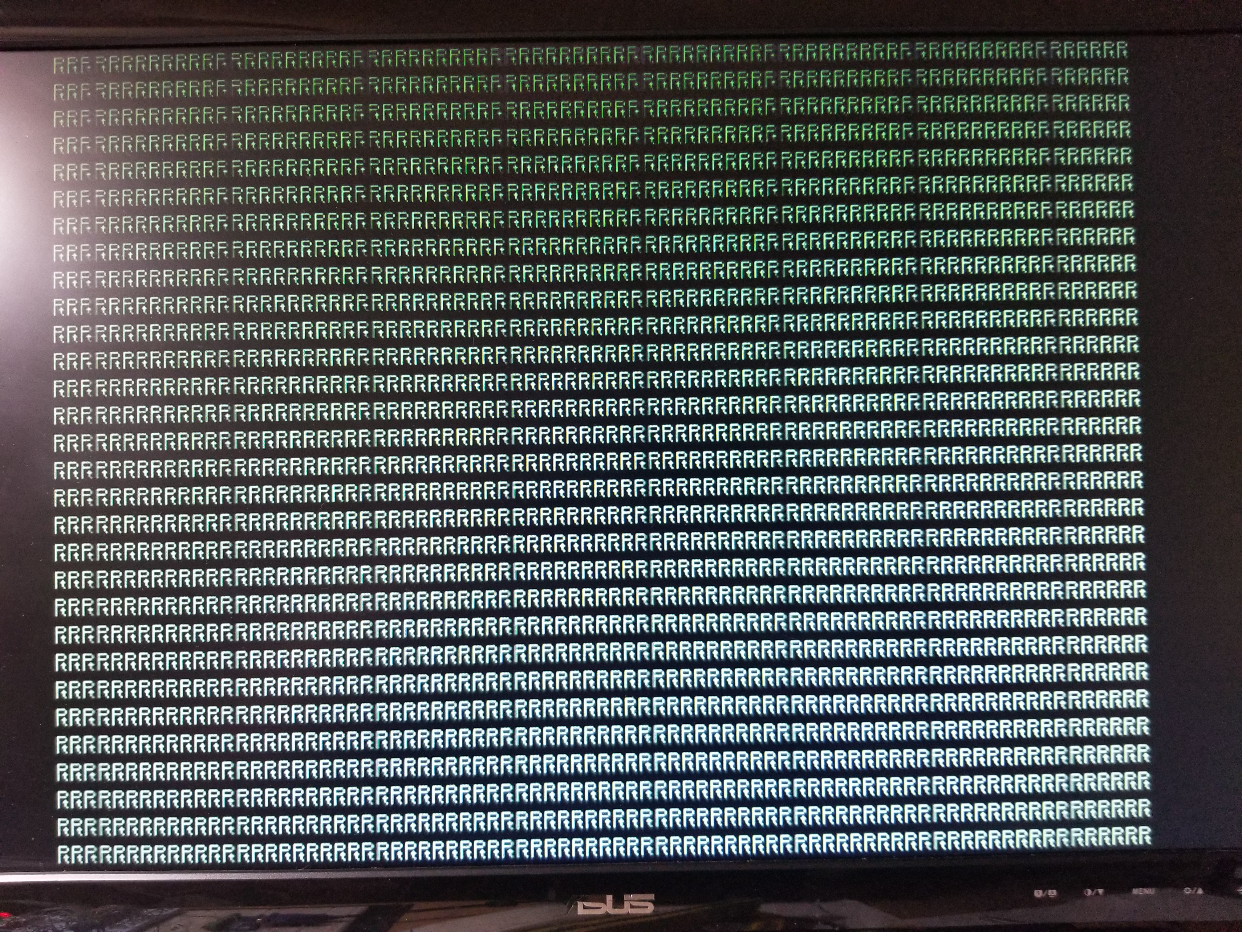

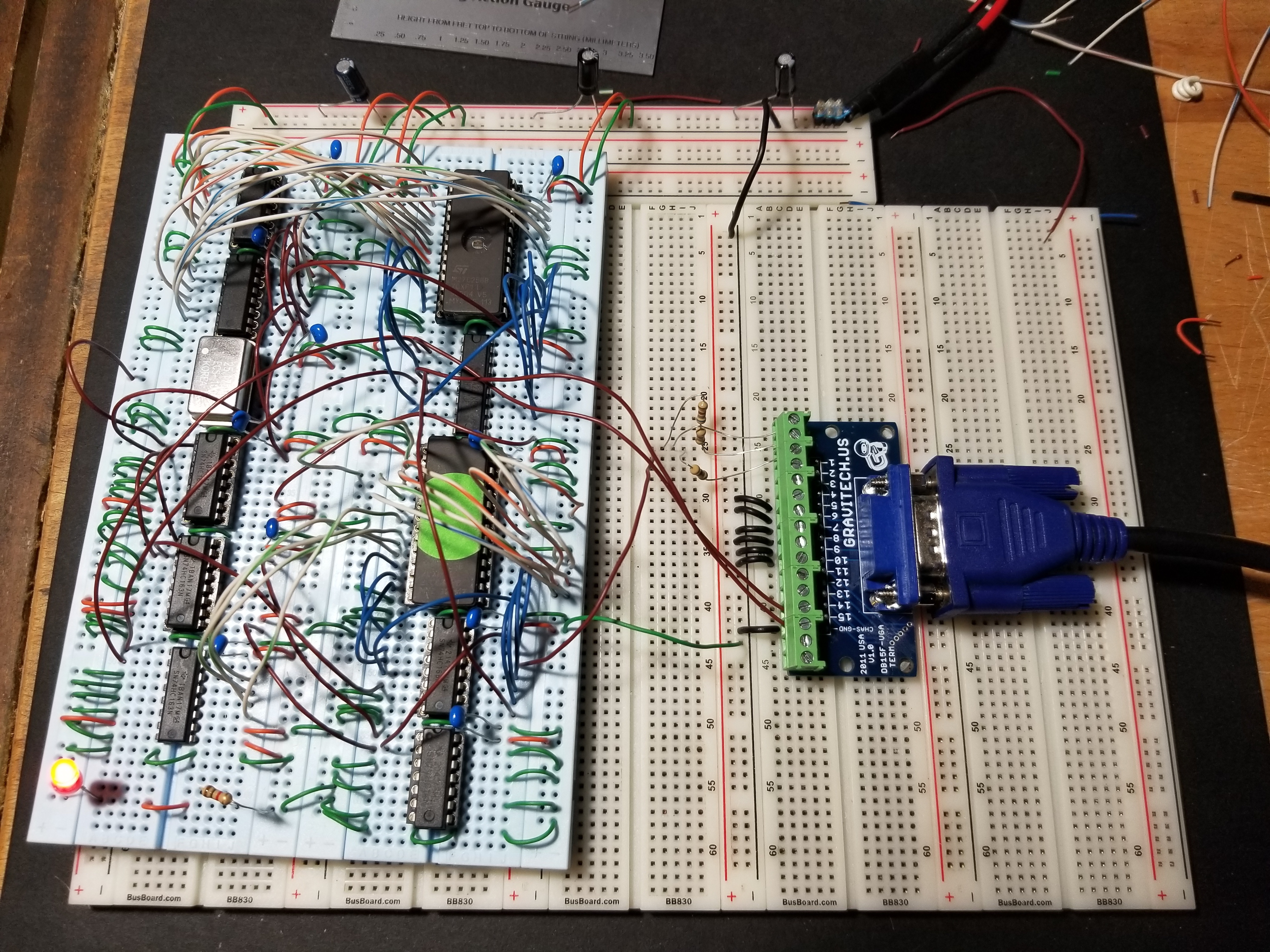

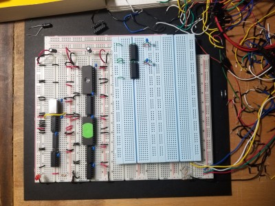

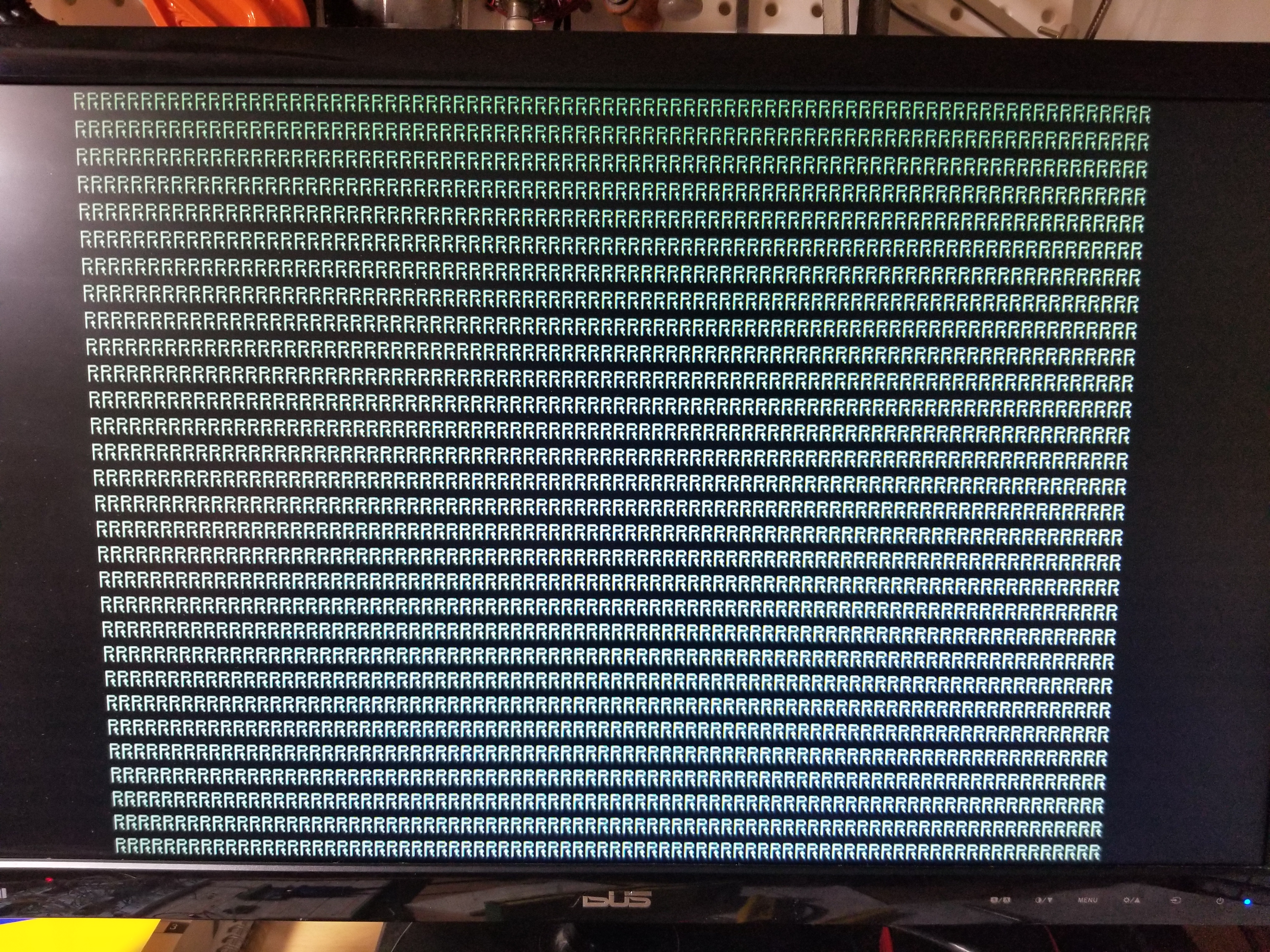

Current state of the project:
And the output:
This is the big ASUS monitor that I have nicknamed "Fussy." Last time I did all my testing on a nice old IBM monitor I have. When I thought I had everything ironed out I plugged "Fussy" in and it complained mightily. This is the first time I've had the output this clean and stable on "Fussy." However, there is one consternating problem: there are only 79 columns! What happened to the last one? I don't know... I must have made some kind of basic math error someplace. :x

Yep, I took the dual port RAM back off the breadboard once I had it working with Peanutbutter-1. I've ben rebuilding the VGA circuit from my old schematic piece by piece with it hooked up to "Fussy" so I could make improvements. I did change the wiring a little bit, but I think most of the improvement comes from using better construction techniques than I did 6 months ago: all the wires are a lot shorter (no long signals with twisted ground wires this time), the ground return network is a much finer grid (one "rung" of the ladder for each IC), and checking each signal with the scope as a go. Plus better breadboards / wire. :)
I can't find the damn missing column though. I spent all evening looking for it last night and re-did the math for the timing ROM three times. I'm using the timing from this page: http://tinyvga.com/vga-timing/640x480@60Hz divided by 16, so one byte in the ROM is 16 pixels of time:

Have you tried another monitor, just in case it's "Fussy" that's clipping the display ?

Bear in mind that on an old-fashioned monitor, there is no specific "visible region" except by convention - you can display additional data beyond that region, up to a point. LCD monitors have to take that analogue signal and try to work out where within it the nominal 640x480 region of visible pixels is, which I guess they then decode into their internal memory and display on the LCD panel via means that are quite different to an electron beam. So they crop off the overscan. If anything about your image confuses that process, it'll crop the wrong bit, and I've found it can be quite hard to work out where exactly that's happening. I have had exactly the same problem though, for sure. If your display has manual controls you might be able to adjust them to compensate, and the display's auto-calibration might work to fix it too.
This also means that the exact amount of porch isn't really too important - displays pretty much always have some form of calibration you can trigger to resolve issues.
The other possibility is that for some reason you're not ultimately sending all the data for the row to the VGA connector. Depending on the circuit it is quite easy to accidentally blank an extra character, or have your blanked period one character misaligned - so the first character of the row is displayed before the shift registers are loaded, and ends up completely black, and then when it's time for the last character the shift registers still have eight pixels to go but your blanking circuit engages. In this sort of case you can also end up with the display latching on to a region that's actually a bit too narrow - e.g. 632 pixels instead of 640 - and stretching it a little to span across the whole screen. I know personally I've sometimes gone quite a while before realising this has happened!
It's particularly important to make sure of is that any latency between the counters incrementing and the shift registers outputting the first decoded pixel is the same as the latency between the counters incrementing and the horizontal blanking signal (if any) that (presumably) clears the shift registers or otherwise cuts off their output from the VGA connector. The path for the character data is much longer and tends to have much more latency (e.g. - address bus becoming stable, RAM access time, character ROM access time, shift registers' input setup time) so it's easy to get this wrong! And you might find it's not very noticeable when this has happened because the RAM might be outputting zeros in that location, and if that character is just blank in your character set then it will just pad it on the left side in a way that's not very obvious. Ensuring the data being displayed makes it easy to identify which column of the row is which, makes it easier to tell that this is happening, as does an oscilloscope probing different bits of the circuit together!

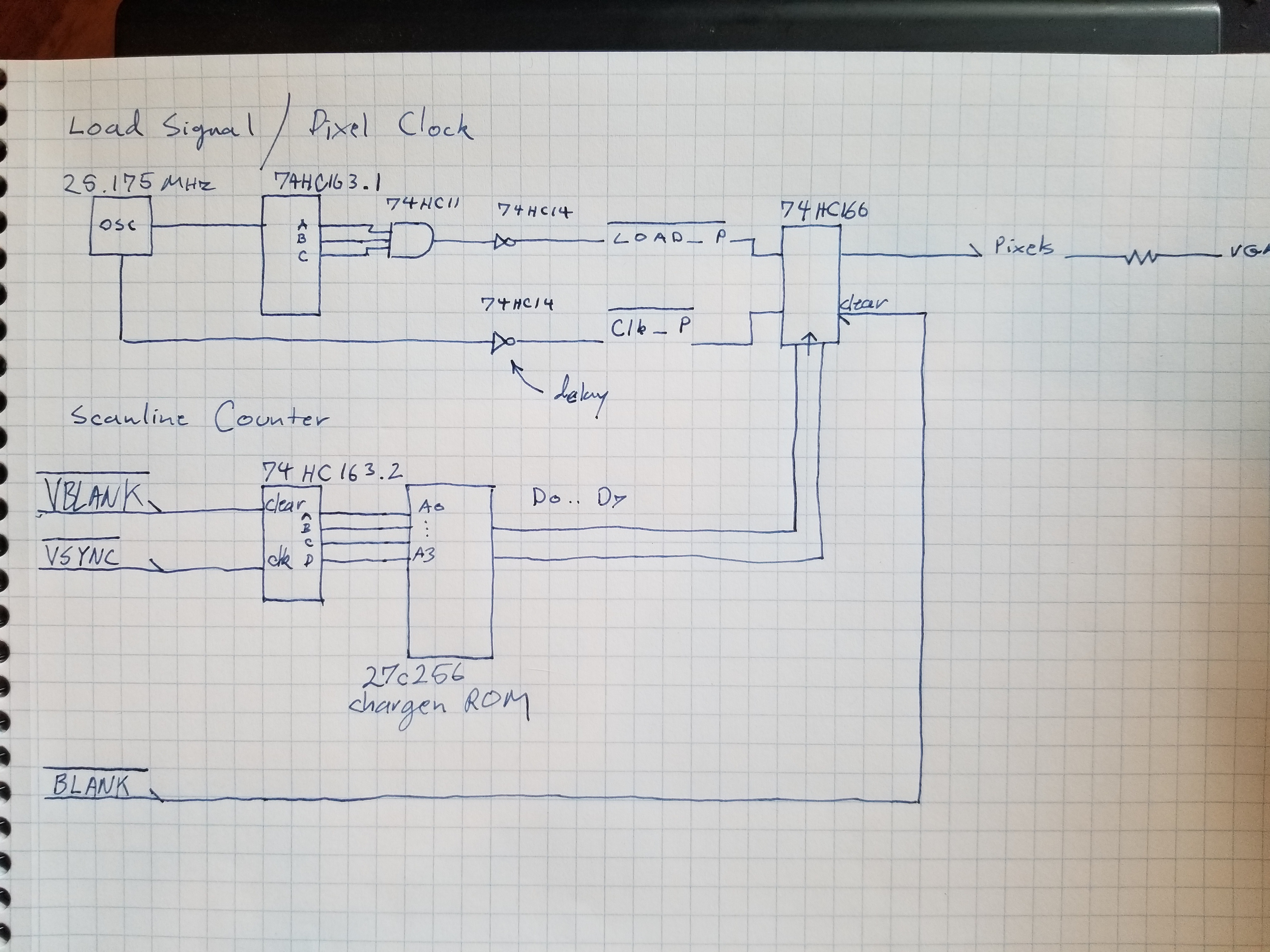

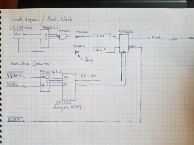

Found the missing column! Unsurprisingly, George was on the right track. I was generating my SHIFT / LOAD\ pulse with a separate`163 by inverting its Terminal Count, feeding that back into its load pin, and tying its inputs to 1000, so that it would count 8..F, generating a LOAD pulse every 8 pixels. Of course, to sync that counter up with the beginning of each scan-line I was resetting it. Which makes it count from 0. So every line there was a 16 pixel gap before the first load pulse, instead of an 8 pixel gap! Whupps.
I redid the load generator logic with a 3-input AND gate and an inverter (I don't have any 3-input NANDs) off of the master prescaler. That added a bit of propagation delay, so I clocked the shift register with the inverted dot clock. Everything is coming in rock steady now, with the right number of characters per line! 8)
Here's a not-quite schematic of the relevant connections:
This is the best result I've gotten so far, so I'm going to take this version and move on with reconnecting the dual port RAM.

I've done similar arrangements and generally found it's not necessary to actually reset the counter as the total line length is still a multiple of the period of the counter. So you can just let such a counter run freely in most resolutions.
I'm not sure why it didn't work without the inverter. I'd generally expect the shift register to load one cycle after the one where these three bits get all set. Using the inverter will bring that half a cycle earlier, i.e. about 20ns earlier, which could actually be worse as the combined propagation delay of the counter, NAND, and upper inverter could be in that ballpark.
(Incidentally, 74HC138 and 74HC139 can be fairly easily used as multi-bit comparators, at least for certain bit patterns, instead of wider gates.)
If you have a two channel oscilloscope that works above 20MHz then it could be good to check how the clock and load signals synchronise in each case (inverter or no inverter), measuring them at the pins of the shift register.
It may be a bit academic though as you'll soon care more about the propagation delay through all the memory ICs, to get a consistent set of inputs to the shift register in time!
Great to see. Where do VSYNC, VBLANK, and BLANK come from? More counters based on the shift register load signal, maybe going through logic gates to compare against key values? Is BLANK just for horizontal blanking or combined blanking?
That's a cool idea. I have some AHC `139s too that I use for Ø2 qualification. They're pretty fast.

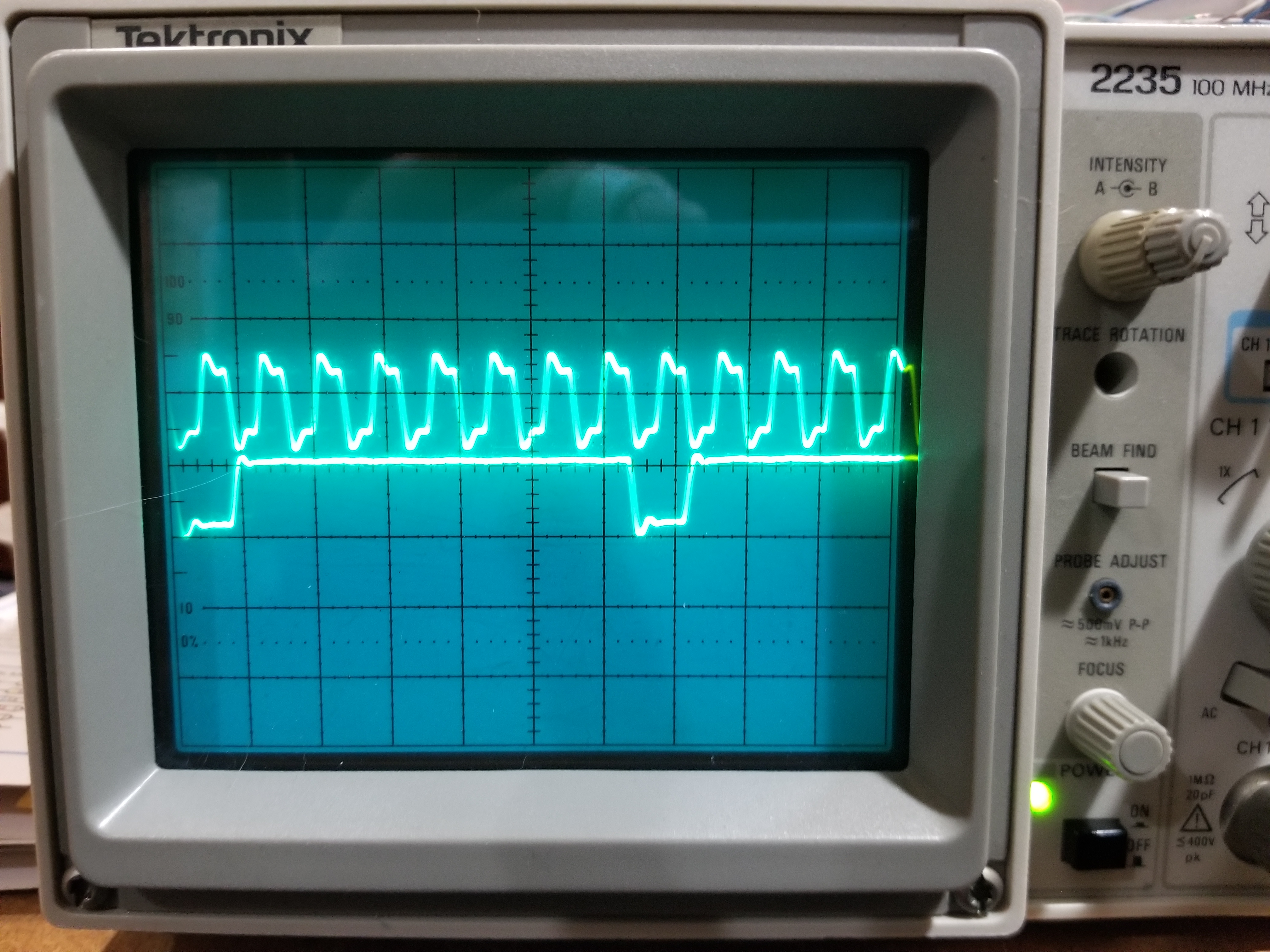

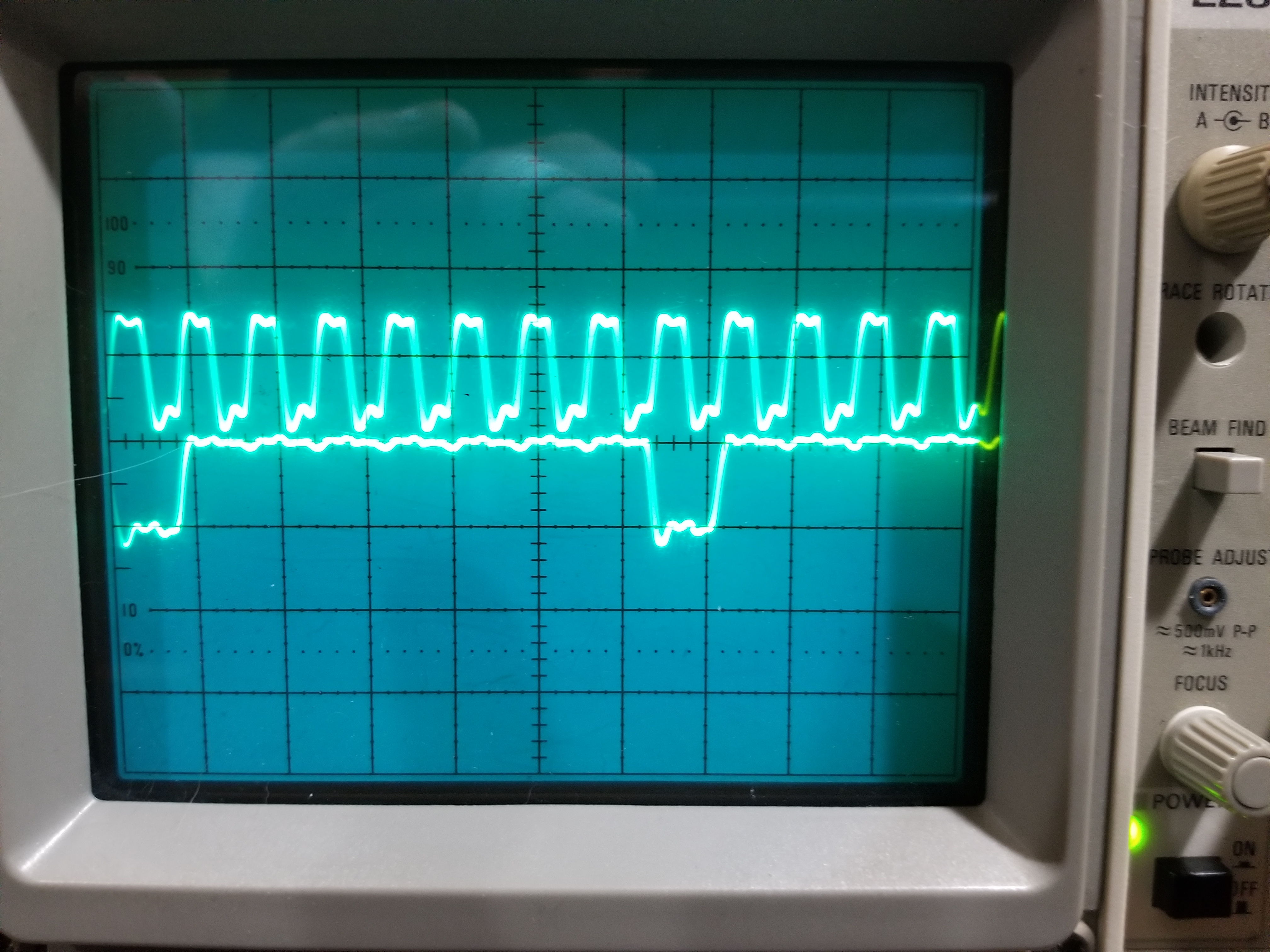

I have an old 200^H^H^H100Mhz 2-channel Tektronix analog scope. (I could have sworn it was a 200MHz one, but the evidence to the contrary is right there in the photos... :lol: ) The 25MHz dot clock is sort of just barely within its power, but it looks pretty spiky. It's not so bad that doing what you suggest wouldn't give some useful info though. I'll try to remember to do that tomorrow and take some comparison photos.
Edit: How about now instead? Dinner is taking a while...

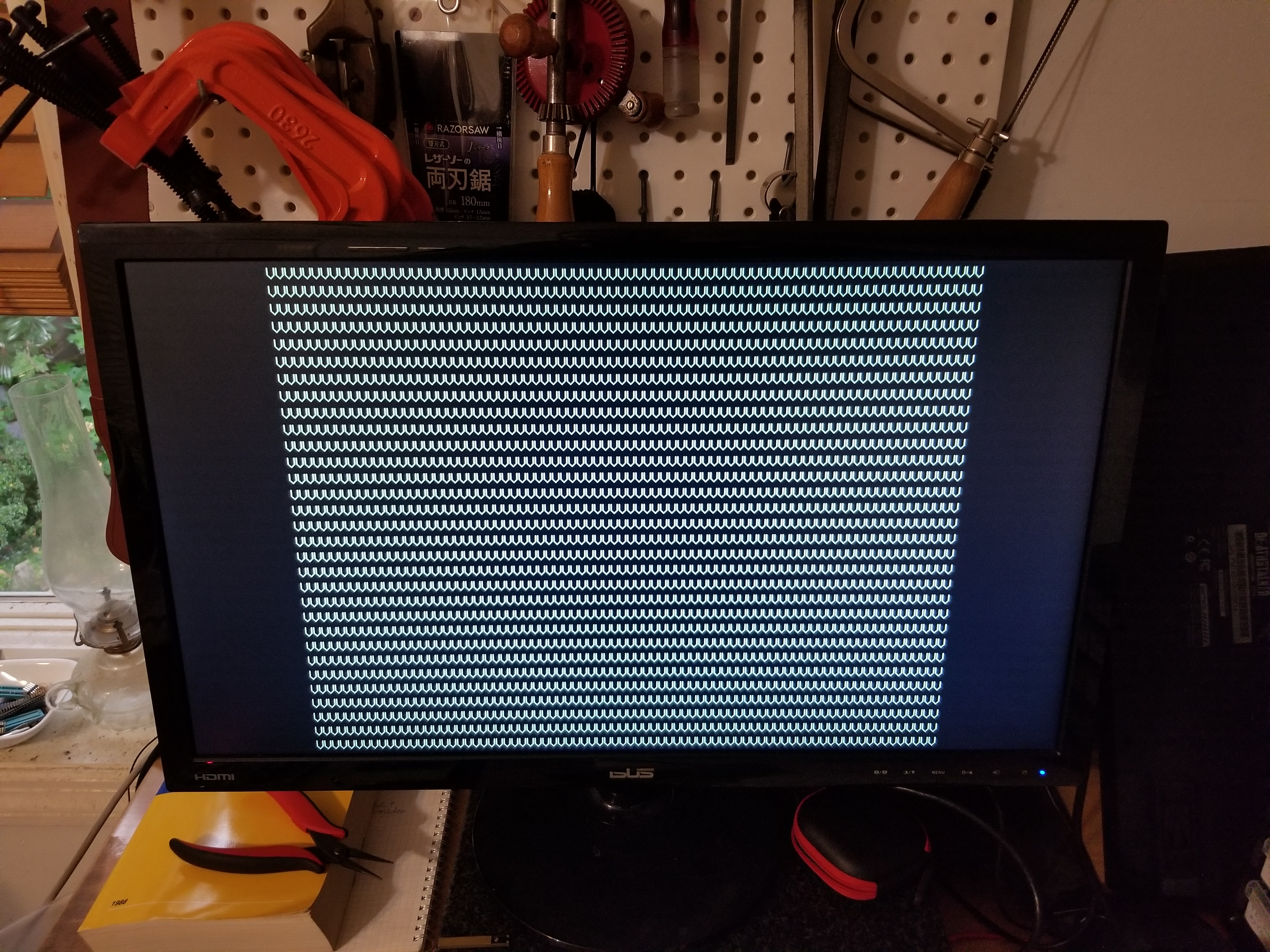

Here's the inverted dot clock compared to the load signal:
And here's what the output looks like on "Fussy:"
Here's with no inverter:
And the output with no inverter:
Initially the output was also off by a pixel at the end of each line, but after an auto-adjust that cleared up. Still has those dark vertical bars though; I think you should be able to see them in the photo.
