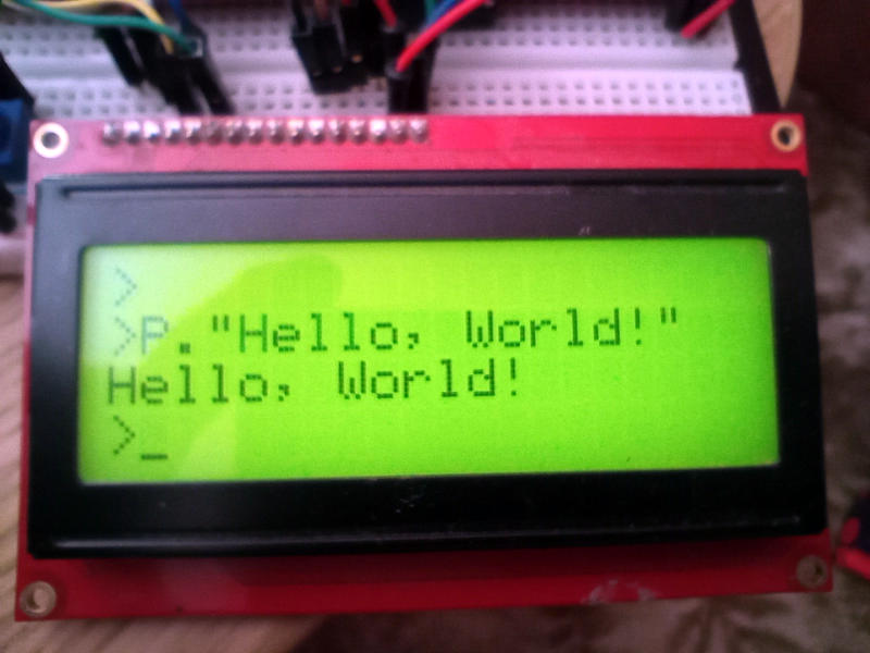

As a curiosity I've implemented an output device based on the 4x20 LCD display for my Ruby Boards. (It's connected to the VIA)
I'd already done it as a BCPL driver for the '816 system, bu this one is all in 65c02 code. I maintain a virtual framebuffer driver which is Acorn/BBC Micro compatible (as is the rest of the Ruby operating system), so I can use it under e.g. BBC Basic and cursor positioning, scrolling up/down, etc. all "just work".

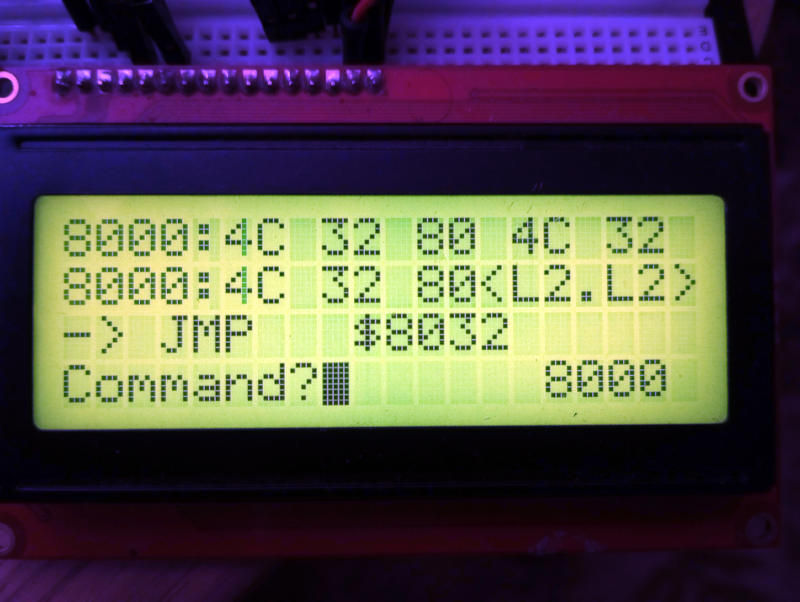

Then I started on a "monitor" for it - somewhat of a backwards step for me as I consider the Ruby system to be an operating system than a monitor but what the heck, why not. I've incorporated the usual stuff - memory display, modifications and breakpoint handler as well as a disassembler (65c02) and I'm in the process of adding a 6x4 (24 key) keypad too because I can.
Picture here:
top line is basic ram address plus 5 bytes.
2nd line is ram address plus N bytes of the disassembly, then inside <> is the ASCII of the 5 bytes
3rd line is the disassembly.
4th is command.
The monitor ROM (implemented as a "language" ROM in Acorn/BBC Micro terms, so might even work in a Beeb) has fixed-entry point routines to do things like load file into RAM and save RAM into a file. Printing to the display is the same as printing to serial so a program that works on the display will work on serial and vice versa (I can run the monitor ROM on a serial terminal if I want)
Example under BBC Basic:
Not sure where this project is going yet, but it was a nice diversion.
