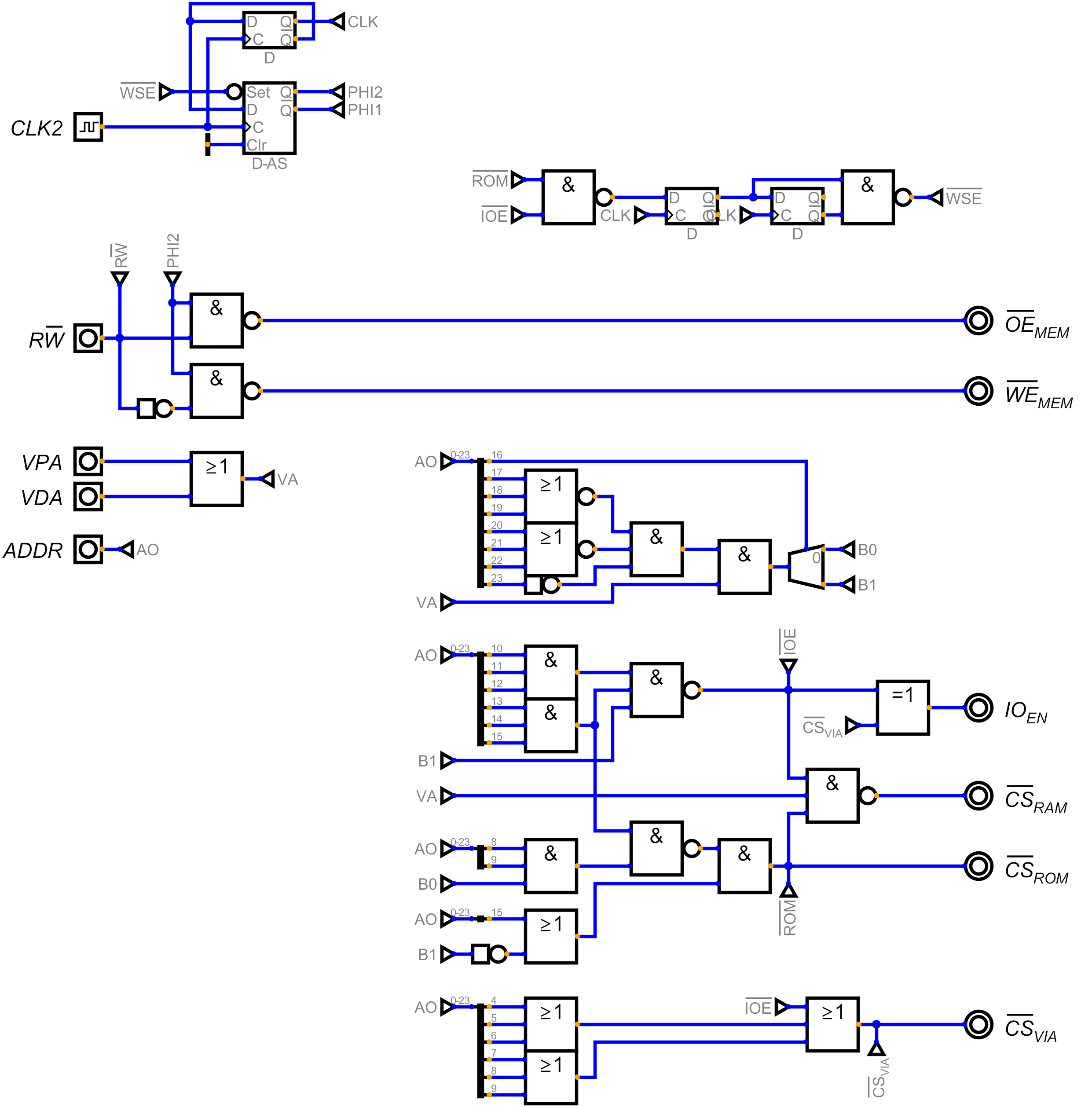

doing the whole low/high ROM split does require a bit of extra logic, but it frees up bank 0 while still allowing for the ROM to be 32k in size, which is required to be able to reprogram it at runtime.
speaking of logic, as mentioned above i wanted to try out the LVC 1G/2G/3G logic ICs instead of something programmable this time. this also allows the SoC to run at 3.0-5.5V without having to swap out any ICs besides the Flash chip.
anyways, problem is that i've never really worked with discrete logic that much. so there might be some obvious mistakes i have made in my design.
plus there might be some ways to optimize the circuit to use fewer gates or spread them out more. currently the longest chain of gates is 8. so i expect the propagation delay to not be that great, and i'd like to reach atleast 16MHz with this.

i designed the logic in Digital, tested it, then went over the design again to use only 2/3 input gates, after another round of testing i remade it in KiCad.
so i'm fairly sure the circuit will work as it did in the simulator, but again there might be some mistakes here and there (like missing pull resistors or similar).
here the logic circuit:

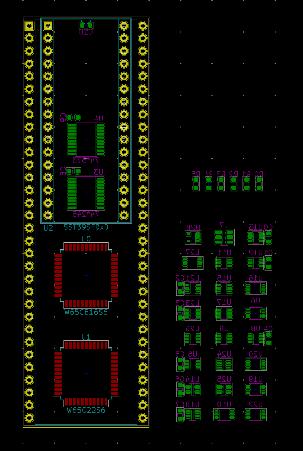

lastly, the connector J0 (which is the 64-pin DIP footprint) has the signals i want around it, but none of them are connected yet as they might move around a bit to make routing easier. due to a lack of pins i had to sacrifice some signals, specifically i removed CB1 and CB2 from the connector in favor of a second set of VCC and GND pins. it does remove some functionality from the VIA but CA1/2 are still around so it should be fine. (also i forgot to put any pull resistors on the CB1/2 pins, which direction should i pull them to if at all?)
i have already done a bit of work on the PCB itself, but i have to find a good placement for all the ICs to avoid excessive crossing of signals, plus i'd like to keep this a 2 layer PCB so i have to worry about GND and VCC as well.

At this size, a 4 layer PCB will be virtually identical in price (6€ vs 2€ per 5 units at JLC), and 4 layers gives you a lot of advantages for routing compactness and also signal integrity.

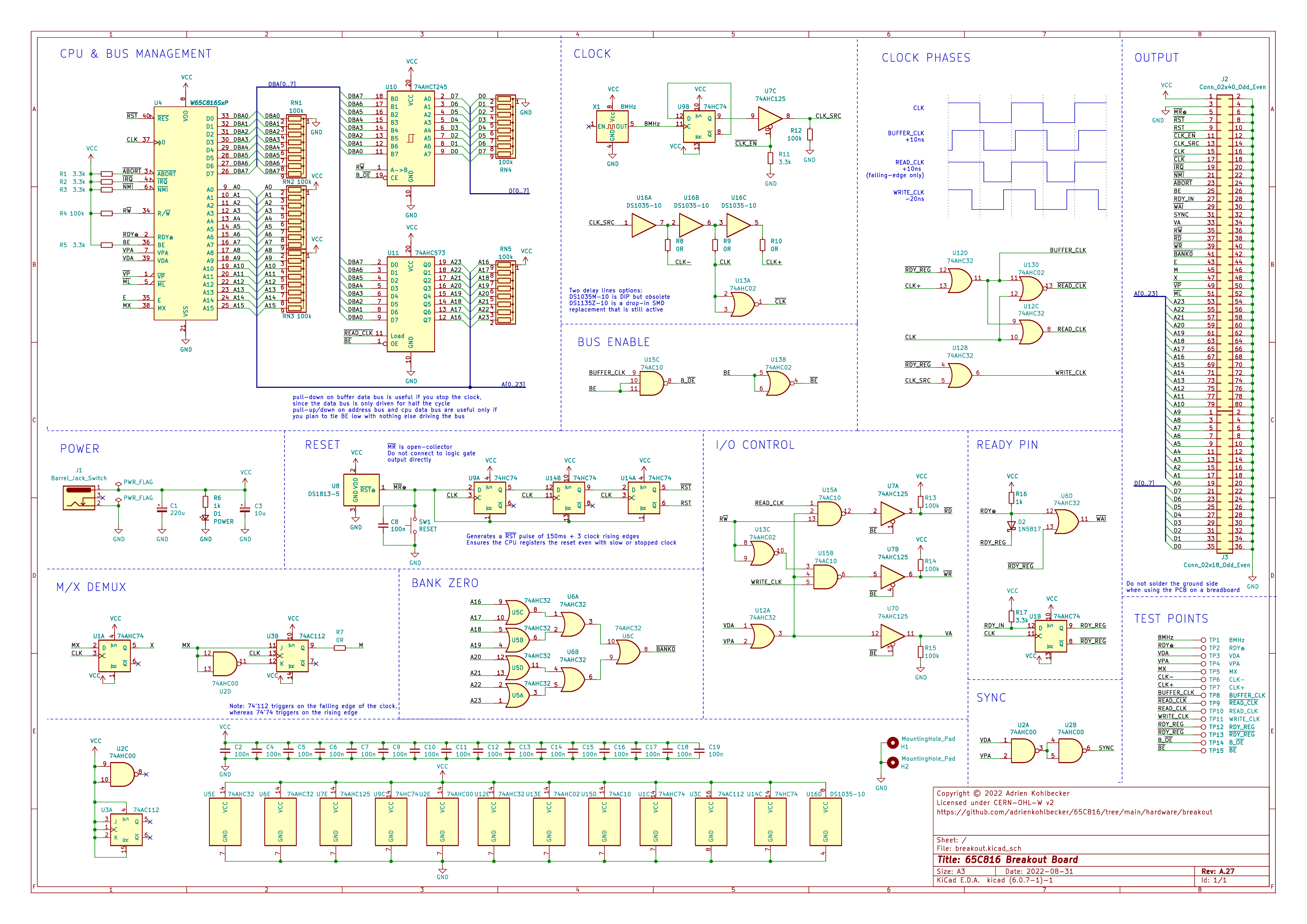

I spent a lot of time optimizing a "feature-complete" breakout board for the 65C816, which might be of interest to you (see attached).

i should've mentioned before that the main challange of this project (or an SoC like this in general) is that everything should roughly fit into the surface area of a specified chip package (in this case DIP-64).
this means the PCB cannot be much larger than an actual 64 pin DIP chip, and there cannot have more than 64 pins on it.
though i'm already questioning the concept.... oof.
hmm, i might do a test to see how much it would cost with 4 layers. i don't know if 2/4 layer PCBs have any price differences when it comes to JLC's SMT assembly (as the logic in the back is not intended to be soldered by hand).
damn that's a beautiful Schematic!
it's defenitly more complete in terms of CPU signals, but i cannot really afford any of that due to the lack of PCB space and pins.
overall you kinda got me to reconsider my whole project. the idea was to have a Microcontroller like board in a chip package where you'd just need the chip, some RAM, power, and a clock to get it running. and if needed for another project you can take the whole module out without having to rewire anything.

I see a lot of cascaded logic, which is obviously going to get in the way of performance. If it were me, I’d confine ROM and I/O to a single bank. That would help reduce decoding granularity requirements. Furthermore, you should not saddle a potential user of this device with a lot of ROM. If you must do so, your logic should allow it to be mapped out and replaced with RAM.
Also consider that if you have any plans to run this unit at double-digit clock speeds, you will likely have to wait-state ROM and I/O accesses. The WDC 65C22 can run at double-digit speeds, but most ROM can’t, and the end user may also have I/O hardware that can’t keep up.
That said, I question the practicality of doing what you’re planning to do solely with discrete logic. I foresee the required logic as cumbersome, both in terms of prop time and accounting for edge cases, e.g., when or when not to invoke a wait-state. Also, unless you are prepared to use very small SMT packages for everything, I suspect this unit’s footprint will exceed that of a DIP64 package. I’d being doing this with a Microchip ATF1504AS in a QFP package to solve both the logic density and physical space requirements.
both ROM and IO are in Bank 1, there is just a sliver of ROM in bank 0 as well so the system can boot at all. it's pretty much the same as with my current SBC.
i mean with 16MB of potential RAM, and 512kB chips in DIP package, it shouldn't be much of an issue. the main reason the ROM is so large in the first place is to allow in-system programming, as that requires having control over atleast the bottom 15 Address lines of the Flash.
i could shrink the ROM to 8k and move it and IO into Bank 0. it would eat up some valuable space in Bank 0, and no longer allow for in-system programming of the Flash, but would make the logic much simplier.
yea i already implemented that. you can see the wait state logic in the Schematic and the image. i know from my own SBC that the Flash and IO won't run that fast.
you can see the PCB i have made so far at the bottom of the post. the logic does fit, but the issue is just routing it all. and yes i plan on having JLC assemble the whole backside, so i'm using the smallest SMT packages they allow, and only have logic on the back. on the front you would still need to solder the CPU and VIA manually as they don't fit onto the back (plus LCSC, JLC's supplier, doesn't carry WDC's chips at all so they couldn't solder them anyways).
yea but i said i didn't want to use programmable logic this time because the 1G/2G/3G series looks really interesting, plus then i would need a JTAG connector somewhere, which is against the self imposed challenge of not having any other connectors on the board besides the DIP package ones on both sides.
Thanks :mrgreen:
Do you have that in monochrome?
Of course, you can find the schematic in B&W in the topic for this board viewtopic.php?f=4&t=7272

alright i got 2 more pins free and opted to bring out ABT and VPB for potential memory protection/management circuitry or similar.
RWB would've also been an option for additional VIAs as there only are seperate RD and WR pins (which are gated behind PHI2).
while i did map the address and data pins on the RAM, ROM, and Connector to mostly line up with eachother, to avoid overlapping trace paths... i haven't done as good of a job with the logic ICs. i did group related ICs together and placed them roughly where the pins to the Connector for them are as well. but my autorouter is still having issues.
I changed the default via and trace widths to help with that. i checked JLC's capabilities (which are aparently slightly different for multi-layer boards) so it should be with spec.
if this actually works, you'd have an almost complete Computer (minus power, clock, and reset circuit) in the area of a 68000 CPU. not bad!
but for sanity reasons, before i actually put out the order (if the autorouter finishes within the lifespan of the universe), i just want a few more eyes on the Schematic to check for any mistakes that might still hide in there:
65C816_SOC.pdf [161.94 KiB]
Downloaded 46 times
i personally can't see anything obvious jumping at me.

Short update, I finally got the autorouter to finish. I did change it to be a 4 layer board, but I had to sacrifice the VCC layer and make it a mixed signal/power layer for it to actually work.
And as a test I exported all nessecary files uploaded them to jlc, picked the correct parts, and went all the way to the checkout. Just to see how expensive it would be...
Result: ~100 EUR for 5 pre-assembled boards.
So that's 20 EUR per board, plus another 25-30 EUR for the flash, CPU, and VIA, making it around 50 EUR per fully assembled board.
That's pretty insane, especially if I were to sell these things pre-made and pre-programmed.
I sadly didn't look exactly at the individual part cost, but it was definitely a huge contributor to the total cost.
I'll redo the order once I'm home and get a more detailed look at it.
to see if I will actually order some or just throw the project on github and leave it for now and focus on other things, like the 65c265 board, or the plans I've been making around a tiny OS for my SBC. We'll see.
