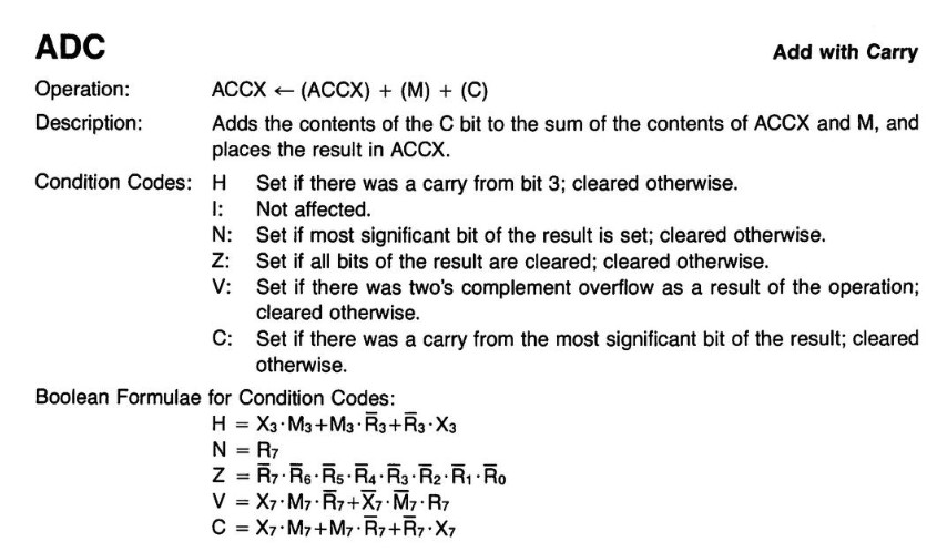

The overflow (V) flag is a somewhat tricky one and often mis-understood.
The flags in general can be quite tricky, but they all have equations you can just run. I don't know if anybody ever specified them for 6502, but Motorola did so in the manual for the 6800. For example, the first part of the page for ADC is as follows:
Thus, in my implementation (in Python), the addition code is as follows. (m is the "machine," the current state of the CPU.)

    #   The following is copied directly from PRG pages A-4 and A-5.
    m.C = x7 and m7  or  m7 and not r7  or  not r7 and x7
    m.H = x3 and m3  or  m3 and not r3  or  not r3 and x3
    m.V = x7 and m7 and not r7  or  not x7 and not m7 and r7
    return sum
As you can see, I basically just copied the equations straight out of the manual and into my code.
