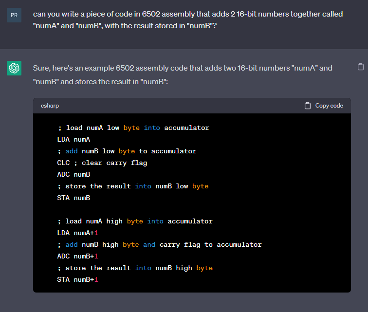

PostPosted: Mon May 01, 2023 4:41 am
Posts: 730
Location: Tokyo, Japan
The other day I asked ChatGPT 3 to give me a 6502 routine to add two 16-bit numbers together. It came up with the following (and for some reason applied SQL syntax highlighting to it):
LDA high_byte1 ; Load the high byte of the first number into the accumulator
CLC           ; Clear the carry flag
ADC high_byte2 ; Add the high byte of the second number to the accumulator
STA result_high_byte ; Store the result in the high byte of the result
LDA low_byte1  ; Load the low byte of the first number into the accumulator
ADC low_byte2  ; Add the low byte of the second number to the accumulator, carrying if necessary
STA result_low_byte ; Store the result in the low byte of the result
Given how obviously, stupidly wrong it got one of the simplest and most common things a programmer does on a 6502, no further comment should be necessary.

PostPosted: Mon May 01, 2023 11:20 am
Posts: 746
hmm, you just got unlucky it seems. i asked it the same thing and got this:
of course the highlighting is wrong, but that's just an aesthetic thing.
