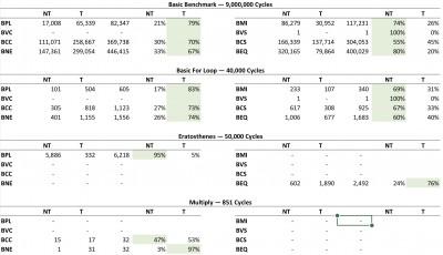

Re: Pipelining the 6502
That’s a great idea! A 6502 specific predictor can certainly skew towards particular regularities in 6502 code if they can be identified.
Let’s have a look ...These tables show the results of the Basic Benchmark, a simple FOR Loop, the Eratosthenes Sieve and the multi-byte multiply. In all but the Eratosthenes Sieve, there is a clear bias towards taking branches where the tested status flag is clear, and not taking branches where the flag is set (i.e. BNE is likely to be taken, and BEQ not taken — just as Mike observed).
I’ll want to sample more code just to be sure this holds, but it is encouraging to say the least.
Nicely done gents!
Nicely done gents!
The larger application, the Basic Benchmark, appears to provide some generalizations that may be applied to the 8 different 6502 conditional branch instructions. The Sieve of Eratosthenes seems to throw a wrench into the rule for the BEQ instruction that seems to be indicated by the Basic Benchmark and the Basic For Loop.
There are, of course, studies for other conditional branch instruction combinations that you've not yet completed, but I am thinking that, for the 6502, the simple two bit saturating counter that you originally started with appears to be able to handle the case for the BEQ instruction when presented with Basic Benchmark in one test, and the Sieve of Eratosthenes in the another. If you extend your branch predictor logic to include some heuristic regarding the branch instruction at a particular address, then you could initialize the two bit saturating branch predictor to '00' or '11' based on the measured frequency for branch taken / not taken as your spreadsheet shows. A few mis-predictions would occur, but they would quickly move to one or the other extreme of the two bit saturating branch prediction counter and provide nearly 100% correct branch prediction. Thus, the simple two bit saturating counter branch predictor should prove to be very effective for the 6502. (If I recall, you've already proven this hypothesis in some of your early work on the branch predictor logic.)
If you're committed to considering a more sophisticated branch predictor, such as the ones that you and Rob have been discussing, then I think that, in addition to constructing Pattern History Table (PHT) using the gshare (XOR) or the gselect (concatenation) methods, the branch instruction type should be used to further qualify / extend that table for conditional branch instructions individually (BPL, BMI, BVC, BVS, BNE, BEQ, BCC, BCS) or by conditional branch instruction classes (N, V, Z, C). Naturally, for the 6502, the coding for individual instructions would require 3 bits and the classes would require 2 bits in the PHT.
The likelihood that these instructions or classes would clash in the PHT when located in different parts of the program should be fairly low. Thus, extending the PHT index with the instruction or class should reduce the need to have a large number of bits from the PC to adequately hash the branches being cached. In fact, I think that you should be able to reduce the number of PC bits into something manageable like 6 bits, which will allow each PHT to be implemented in a dual-ported Xilinx LUT-based RAM (with a synchronous read/write port and an asynchronous read port, if a small FPGA option is in your design space.) If the PHT implements the two bit saturating branch predictor for a conditional branch instruction class, then I think the result wold be very satisfactory for your Pipelined 6502 project.

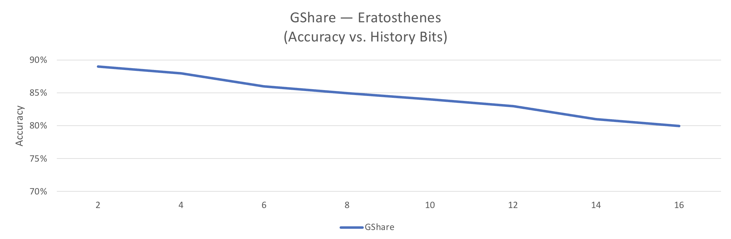

I’m sorry to report that using the branch-type to influence prediction seems to have produced rather lackluster results. I tested a couple of variations:
I’m certainly open to further experiments on this, but for now, I decided to go back to the original GShare scheme. Further tests showed that GShare in fact does quite well with a small table in many instances. It seems that the BASIC interpreter is simply a particularly difficult case (probably because of the large number of data-dependent branches and relative lack of regular looping branches). Be that as it may, it’s an important target, so a large PHT it will have to be. (In a discrete logic implementation, any reasonable size for a PHT is going to need a separate RAM IC in any case, so a large PHT is not as burdensome as it might be in a FPGA).
But there is one drawback to a large table: it makes the predictor harder to train. By way of illustration, see the graph below:This is the GShare branch predictor running on the Eratosthenes code with various widths for the Global History Register. At just 2-bits, we have a 4-entry pht, and the predictor performs much like a simple bi-modal 2-bit predictor. But performance suffers significantly as we add more history bits. While a 16k pht performs very well for the BASIC Benchmark with 9 Million cycles, a simple program like Eratosthenes is much better off with a simple bi-modal predictor. In general, it’s clear that GShare alone will struggle in situations where bi-modal will do well, and vice-versa. The obvious implication is to blend the two in a tournament predictor.

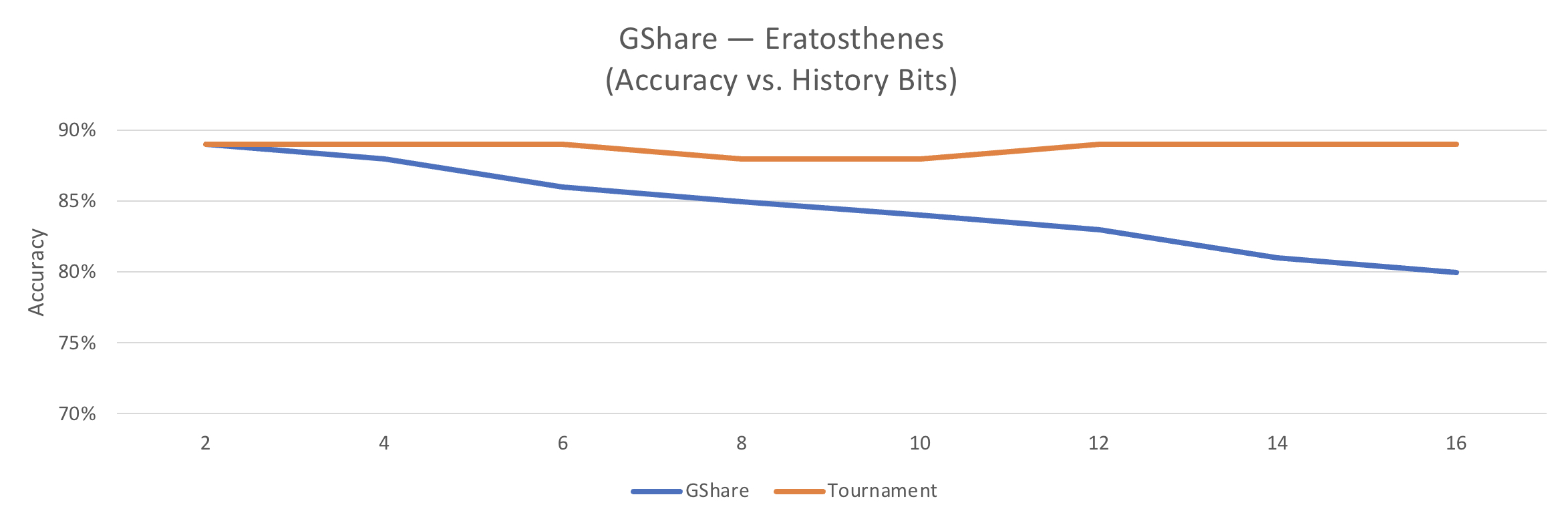

I tried a tournament predictor with a bi-modal 2-bit predictor in the btb and a GShare predictor in the pht. The simulation already has both, so the only addition was a 2-bit Selector counter for each entry in the btb. The Selector is initialized to point to the bi-modal predictor by default, and is updated at run-time based on which predictor is found to be correct for a given branch, as follows:
The graph below shows the effect of adding a tournament predictor to the Eratosthenes test above:As we can see, a much more stable performance from the smallest to the largest table.
It’s comforting to know that we have here a fairly well-rounded predictor which can be more easily tuned. The good news is that this is not much more complicated than GShare. It requires that we keep a separate Selector counter in the btb and that we use its high-order bit as input to a 2:1 MUX which selects one or the other predictor. There is additional propagation delay to contend with, but overall this seems straight forward enough and may prove feasible after all. Time will tell. Certainly, I’m glad to have tried it.
