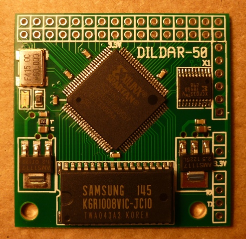

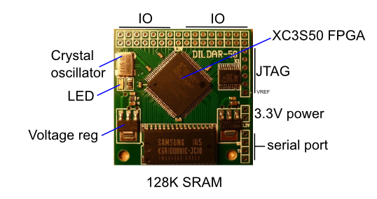

Summary: CHOCHI is a minimal XC3S50 FPGA board with 128K of fast SRAM and 31 IO pins, capable of hosting Arlet's 6502 core with up to 128K RAM with about 1/2 the resources available for custom circuitry. It is closely related to DILDAR50 viewtopic.php?f=10&t=2638- in fact the upper IO connector is identical in later boards. Final prototypes of CHOCHI even carry the DILDAR insignia.:

CHOCHI started its life as DILDAR50. The bottom IO connector was removed and IO recycled to connect the SRAM. Two remaining pins were used as a dedicated serial connector (lower right). Unlike DILDAR, the power regulators are right on top. There are no parts on the bottom, making it much easier to manufacture. The board can actually accomodate a 512K SRAM.

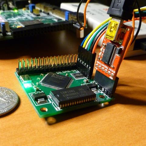

Nice looking little unit, enso! Do you have any "action" pix, showing it connected to some peripherals?

Here is a sexy action shot:
You can see the LED is on (it's running a blinky test).
The rainbow cable is the JTAG connection. An FTDI Basic USB-serial board is attached to the serial port. The pins are soldered facing up for easy testing (and wire wrapping), but may be soldered down.
I am drawing 3.3V from a nearby Digilent Spartan-3 board.

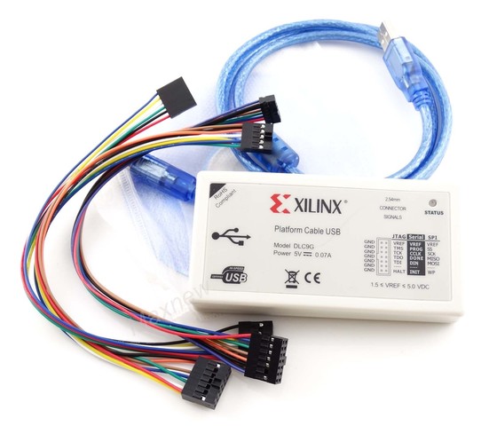

What is needed for programming this board? Or installing Arlet's 6502 core? How would one (after installing the core) then use the board, i.e. connect it to the world? As you may understand I have no experience with FPGA, except for a Z80 board I have where there's a Spartan FPGA which can be updated from an SD card via a monitor program running in the Z80.
I'm very interested in your board if I could just be able to use it! :)

What is needed for programming this board? Or installing Arlet's 6502 core? How would one (after installing the core) then use the board, i.e. connect it to the world?...
I can pre-configure the board with Arlet's core and a loader. The FPGA then boots up into a prompt and waits for code to be uploaded via serial, using a very simple binary format: the binary has a 16-bit address and a 16-bit size in front. I use Kingswood assembler to output a binary file. For instance, FIG-FORTH, based at $0800 required the following code in the beginning

The next step would be to get the free Xilinx tools and a USB cable. Search for 'Xilinx Platform Cable USB')
Once you can flash the FPGA using the IMPACT tool, you can at the very least get FPGA binaries from me or others and modify the FPGA setup.

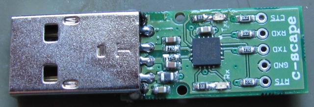

To hook these up to a PC, you need a USB-TTL serial adapter. You can get them on Ebay, but the quality isn't guaranteed. I've bought 10 that were excellent, and 2 more sets of 10 that didn't work very well.
So, instead of taking another gamble, I decided to make my own.
Let me know if you're interested, and I'll sell them at cost (edit: 5 EUR) + shipping (edit: 1 EUR worldwide by regular mail) to members of this forum. They have a FT230X chip (doesn't require crystal), red/green LEDs for Rx/Tx indication, and zener diodes on the bottom to protect against ESD and latch-up. They were made for 3.3V, I have no idea if these devices are 5V tolerant.
If there's enough interest for enso's board, I could send him a few, and he can ship them together with the boards. That should save on shipping costs.
Edit: I'll take paypal (paypal fee will be added to price), bitcoin, or SEPA payment (Europe only).

At work we have a few Xilinx Platform USB Cable II, the red ones (not sure about the quality of these things, at least one of them was labelled 'does not work', and another 'this one works'. In any case there are people working with Xilinx FPGAs here at my company, just not at the moment. I can talk to them later of course).
Would one of these work until I get one for myself? I notice the II is marked '2mm connector signals' while the white ones (the one in enso's image, and some, but not all on ebay) are marked '2.54mm connector signals'. I assume this is just about the connector on the gadget itself. It connects to that JTAG connector? (I also noticed that at work we have at least one expensively-looking Xilinx gadget called 'JTAG' something).

..At work we have a few Xilinx Platform USB Cable II, the red ones (not sure about the quality of these things, at least one of them was labelled 'does not work', and another 'this one works'...
I use a JTAG programmer cable I purchased from DigilentInc, now going to be just about 3 years old. Recently in my PVB project I need to program 2 separate boards independently, each with a FPGA and 2 FPGA PROMs. Over the past month, it has survived "hot-swapping" between 2 boards powered up, also an intermittent reverse plug-in! :lol:
Anyway, I see they have a newer (not necessarily better) HS2 cable for $5US more.

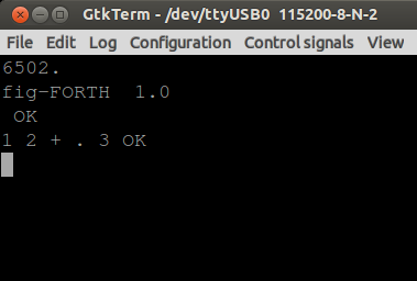

Tor, I currently configure the board so that on power-up it becomes a 6502 system with a UART. Your terminal should be configured to 115.2 KBaud, no parity, 2 stop bits.
The top 2K of RAM contain a loader that displays '6502' and waits for you to send a binary over the serial port. The first two 16-bit words sent should be load address and binary size in bytes. Data should follow. As soon as all the bytes are loaded, the code is executed (at load address).
So to get started all you need is a working serial port. With it you can load FIG-FORTH, Daryl's monitor, or any 6502 code you assemble or compile.
