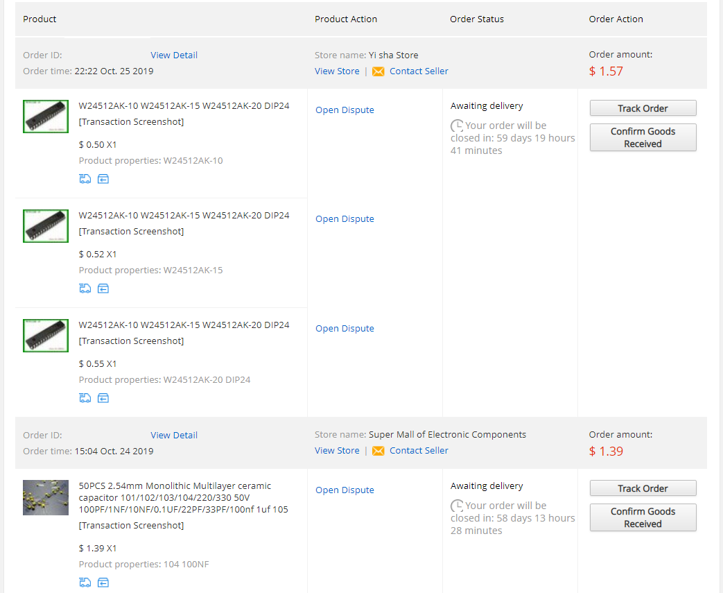

A potential 'bargain' for a single skinny 64K W24512AK-10, 15, or 20 SRAM chip at $0.50, $0.52, or $0.55, respectively, including shipping. I've not dealt with this vendor before.
Other skinny SRAM chips I've purchased before include IS61C512-15N (64K) or IS61C1024-15N (128K) at 60 cents each for quantity 5 and UM61512AK-15 (64K) quantity 5 (free).
Purchasing chips from Aliexpress vendors is somewhat "hit-or-miss" but Aliexpress has been very good at providing refunds on disputes.
Cheerful regards, Mike, K8LH

I received them last week. I had ordered one of each speed but received all -15 parts. They're "pulls" but in very nice condition. All three tested ok...

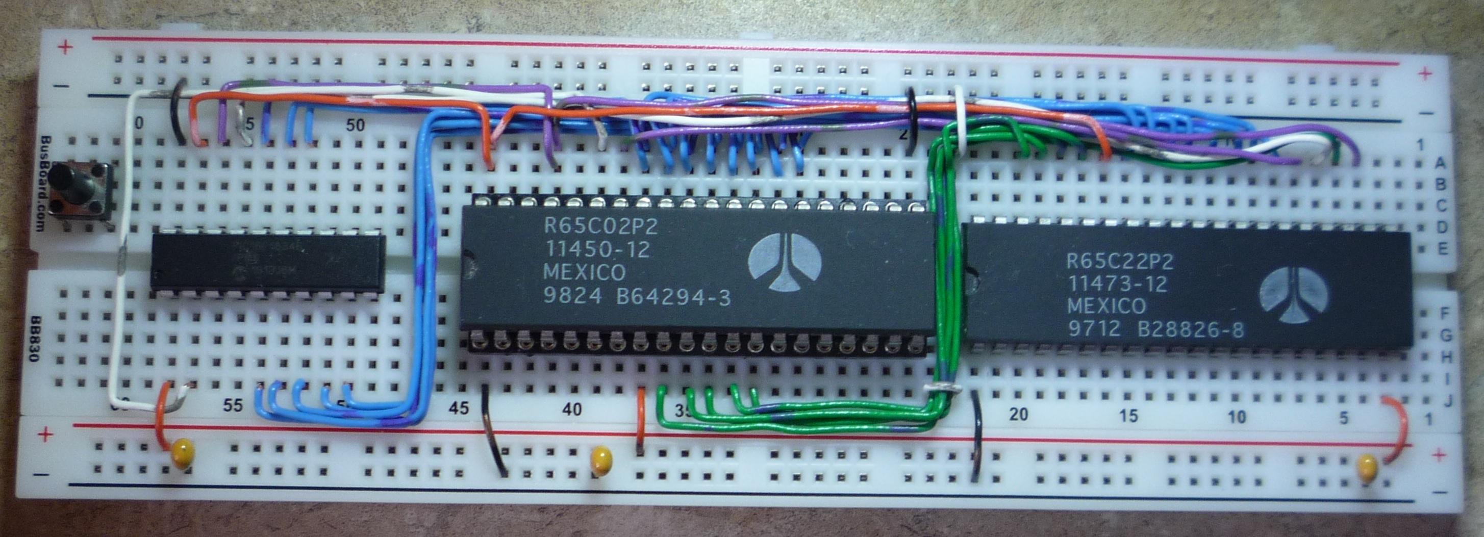

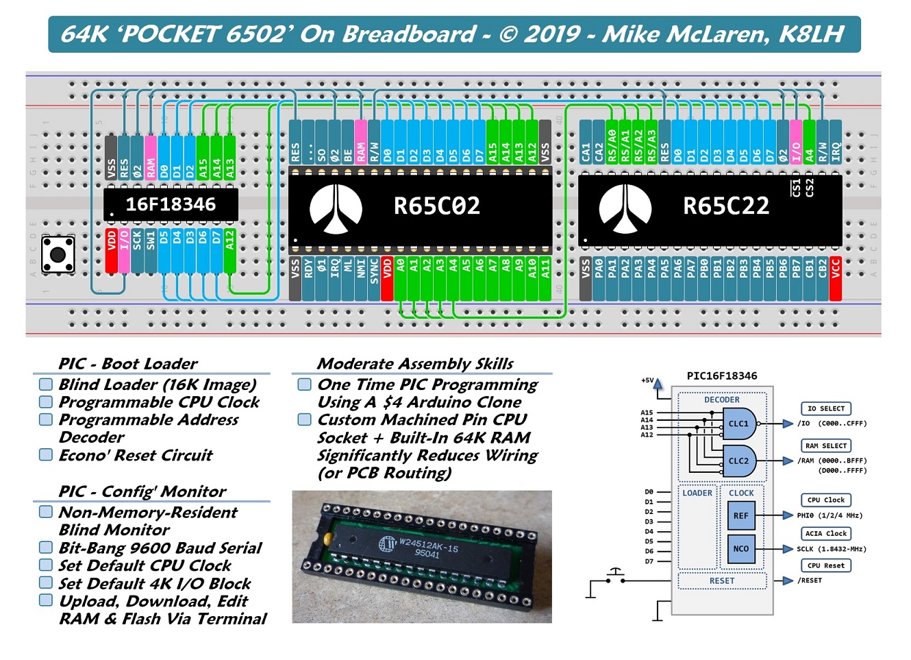

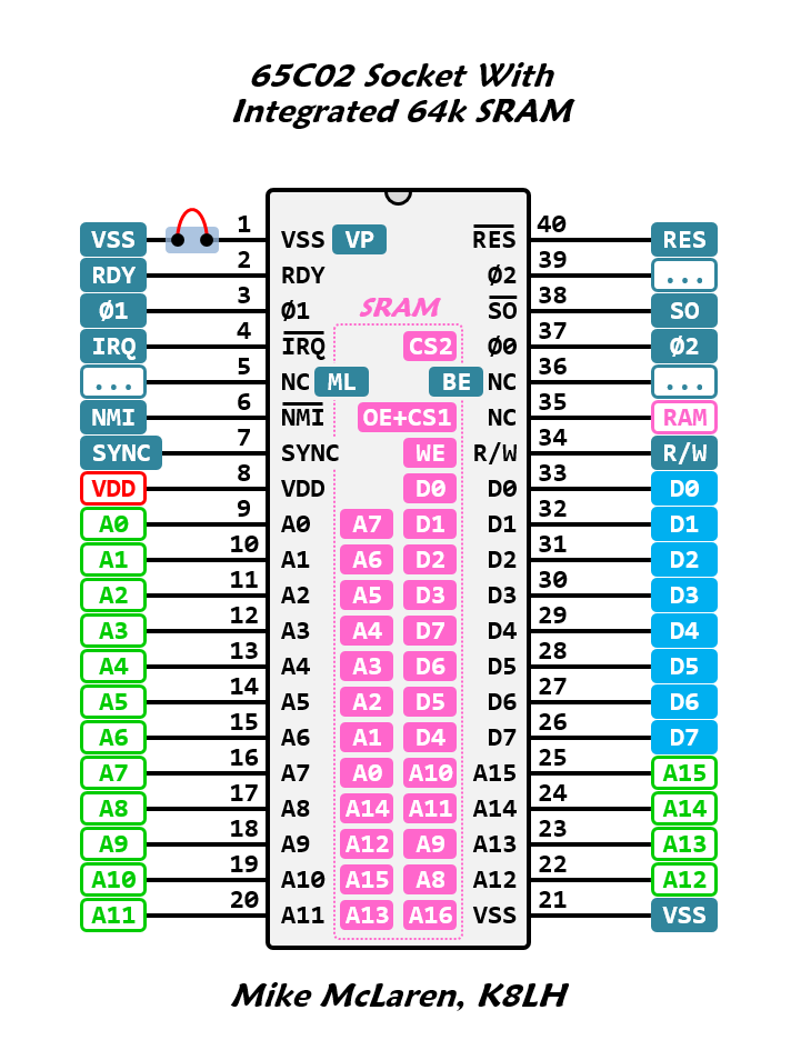

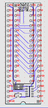

I designed a little 0.8-mm thickness PCB that is soldered onto the shoulder portion of the pins on the bottom of a 40-pin machined pin CPU socket to which a 64K RAM chip is installed (underneath the 65x02 CPU). Pin 35 which is 'unused' on the 40-pin 65x02 CPU is used to access the active lo RAM chip select and the active hi RAM chip select is connected to the PHI2 input to qualify RAM read/write operations. Just add a 20-pin PIC "ROM Emulator" and a VIA and/or an ACIA for a complete mini' system.
