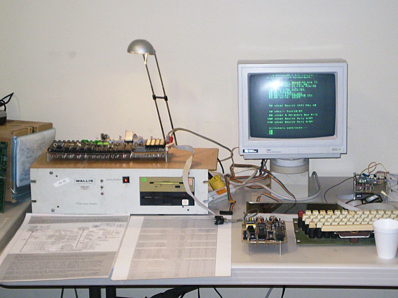

Hi everyone. Yes a 65C02 computer with hardware that accelerates Forth, including a new addressing mode and a very fast, one-byte NEXT instruction:
Not for sale, unfortunately - it's a homebuilt. But very obviously Forth related; hence the post under this topic.
I'm new to this forum and am pleased to become part of your group!
Edit: add a photo of the board. Change link to point to the one-page Short Summary
Edit2: add another photo and the register diagram. BTW, to find specific info (also the photo gallery! :) ) please refer to the Contents and Appendices links here.
KK with its keyboard, monitor and separate floppy-disk system
the KK circuit board

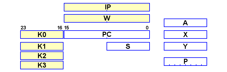

KK gives the 65C02 six new registers and 44 new instructions. Besides the 9-cycle ITC Forth NEXT, another main feature is the pointer-arithmetic-friendly extended address space.
KK Register Diagram.png (8.39 KiB) Viewed 4829 times

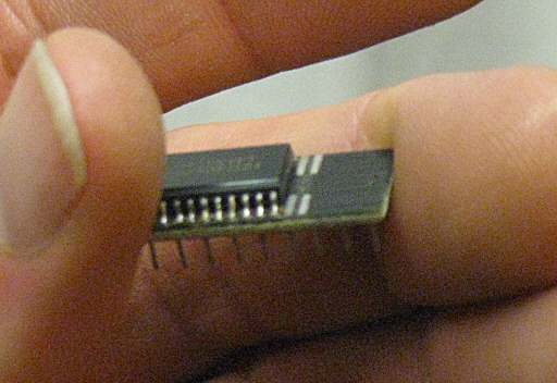

I've done well by soldering to these adapter boards by Aries Electronics (see photo) which can THEN plug into a wire-wrap socket. There are SOIC, PLCC, QFP... Still a dicey soldering job, but greatly aided by unimpeded access from all directions. [DigiKey lists them in Product Index -> Prototyping, Fabrication -> Adapters, breakout boards]
From old records, I found I got my WW PLCC sockets from Allied, and the manufacturer was MacKenzie Berg. Unfortunately Allied doesn't seem to have them anymore. I've been looking for where to buy them. I found this source: http://smt-adapter.biz/Site/Wire-wrap-sockets.htm# . [Edit, 12 years later: It's gone now, but see the archived page at https://web.archive.org/web/20060619144 ... 4-pins.htm .] The 32-pin is shown there, but if you click on "Selection-guides" underneath the 32-pin one, it will give you a .pdf file, and the 44-pin is indeed there, part number 44PL-W. It's expensive at $9.20, but it may be less than I paid quite a few years ago. Here's a picture of the 32-pin:
Broken external image link
http://aprilog.com/sites/smt-adapter.biz/illustrations/Photos/32PL-W-F.JPG
As you can see, it's not one of those monstrosities with a big PC board around the outside and all the WW pins outside the perimeter of the actual socket.
Anyway, It looks like if you want to buy some, they're available. [Edit, 1/21/13: Those are no longer available but BigEd just pointed us to a source that stocks them: http://uk.rs-online.com/web/c/?searchTe ... ra=oss&r=t ]
