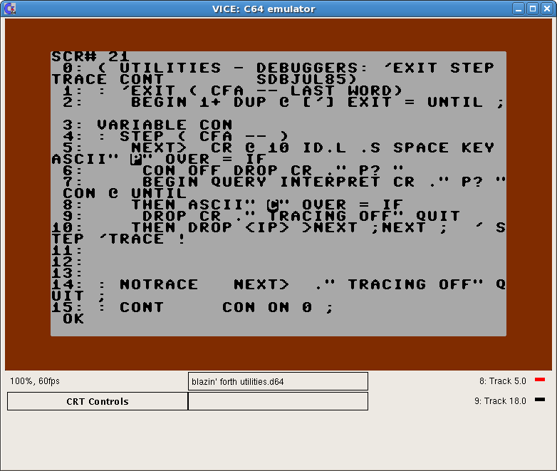

The other situation is when you suspect SOME.WORD is not working right and you want to trace it. When executing SOME.WORD with the right parameters everything works fine. you execute BAD.WORD , which calls SOME.WORD and the trace begins. You see that SOME.WORD got called with some oddball parameters. Aha! Let's trace BAD.WORD.
JimBoyd
Posts: 931
Joined: 05 May 2017
Re: CS-101 problems and their FORTH solutions.
Post by JimBoyd »
A few posts back, I showed the source code for Blazin' Forth's TRACE utility. The source was a print dump of the listing of the blocks from Blazin' Forth's system loader disk. The print dump functionality does not support the C64's quote mode and the first instance of using Blazin' Forth's word CONTROL to get the ASCII value of the control-P key combination printed nothing. The next instance to get the ASCII value of the Run/Stop key printed a dot. The original post has been edited and here is a screen shot showing the source from the disk that was modified to support Fleet Forth. It uses ASCII" instead of CONTROL .
ASCII" is more efficient:
: ASCII"
   [COMPILE] ASCII ; IMMEDIATE
and used as:
ASCII" C"
Where C is one of the C64's reverse video control characters.
Here is Blazin' Forth's CONTROL
: CONTROL  ASCII " WORD 1+ C@ STATE @
           IF [COMPILE] LITERAL THEN ; IMMEDIATE
And it's used as:
CONTROL "C"
