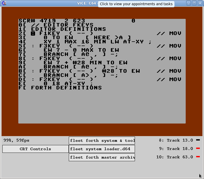

The visual appearance of text windows can be created on the C64 using reverse video. Ctrl-R on the C64 selects reverse video and Ctrl-0 ( control zero) selects normal video.
Here is were I selected a black background and white text and played around on the screen by selecting and deselecting reverse video. I typed the text with spaces to achieve the look of windows.

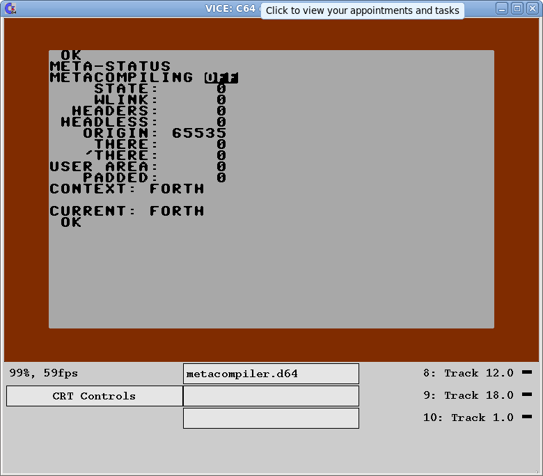

I normally use reverse video on the C64 to highlight important information.
Fleet Forth has the words RON to switch reverse video on and ROFF to switch to normal video. A carriage return also switches reverse video off.

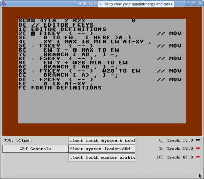

Fleet Forth's EXPECT starts at the beginning of a line on the view screen and will perform a carriage return if necessary. Setting the variable RC to 3 will cause EXPECT to move the cursor right by three.
That reversed video colon after 2[ is a snapshot of the blinking cursor. It was placed there after pressing the return key anywhere on the previous line.
Fleet Forth's EXPECT was modified to test for function keys. The function key words can be executed without the need to scroll down from the text being edited.
Some sample function key words I was trying. This is how the screen appears when listing with LISTW and EW is zero. The listings are sent to a printer, or in my case, a print.dump file.
