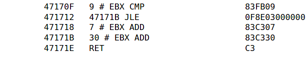

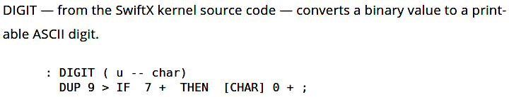

Well, the only contact I've had with Forth, Inc. is through what they've published, online, and on paper before we had the internet. I don't really have any reason to doubt them, since they've accomplished some very impressive things including what I wrote in this post and this one. I quoted a bit of Elizabeth Rather's story here, how she found Forth to be many times as productive as the other languages she had worked in, even though she was initially very biased against it.
When I came up with my Forth development system for embedded development which gives practically instant turnaround speed between writing a piece of code and compiling it into the embedded system and watching it run, which is apparently the same as what Dr Jefyll developed although he used a parallel link to the host computer instead of serial, and which does not require backgrounding or suspending the editor in DOS nor any TSRs or other special software, my old boss who had moved on to another company said they had just spent $8000 on a C development system and they did not have nearly the interactiveness and development speed that I had with my very simple system.
The SwiftForth compiler optimizer example I cited is from Forth, Inc.'s site, where they take this example:
and it compiles this machine code:
five instructions as a subroutine, four if you were to straightline it so it would not need the RET nor be called with another instruction. In my '816 Forth, it looks like it's about 26 machine-language instructions, including NEXT. There are conditional branches in there, so not all 26 get executed, and I need to shorten it now in light of this recent topic.
Am I biased? Probably, because Forth works the way my brain does, and after meeting Forth, I didn't want any more algebraic languages. I did go through the K&R C book years later, and another beginning C book, and I cannot latch onto it. I have an article about my beef with C, here. The tag-along on the title says, "(You don't have to agree.)" If someone else's brain works that way, I have no criticisms for them; but I myself am done trying.
Squeezing out an extra 5-10% of performance is a huge win if that's horsepower you can hand over to the user to do calculations with.
10% speedup is nothing unless it crosses a threshold between not being fast enough to keep up with a certain realtime demand and OTOH keeping up ok. Outside of exacting thresholds, it has been my observation that a 30% speedup is pretty insignificant to the user. 100% speedup is definitely significant, but not monumental. If we really needed maximum horsepower, there are ARMs and other processors that we can move up to. Jim Boyd obviously knows his FleetForth very, very well, although it's running on a 1MHz C64. Apparently it has the performance his uses need. For some things, I still use my 35-year-old HP-41cx calculator every day which only runs about 6300 assembly-language instructions per second (not 63,000, nor 630,000, nor 6,300,000), although it does have 56-bit registers so one instruction can do quite a bit in handling decimal operations. The longest program I've ever run on it was about 2,000 bytes, but most are under 200 bytes. It can control and take data from lots of workbench instruments at once; but it's definitely not the tool to use when I want to service tens of thousands (let alone 100,000+) interrupts per second like I can on my 5MHz 65c02 workbench computer.
It comes down to the a couple of questions, "How much speed does your intended application need?" and "Can you get there with your hardware and with your software methods?" "Software methods" will include language, but probably go much further, and in this case, forming a faster DO...LOOP for 8-bit counters.
