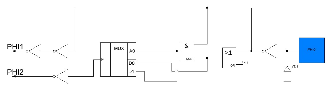

Hello everyone, long time no see )

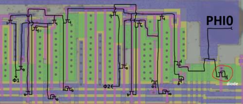

Please help me to analyse this circuit :
And logic representation :

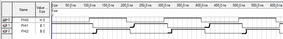

The problem is following: as you know, PHI1/PHI2 is lag a little over input PHI0. But 6502 documentation says PHI1/PHI2 also have a slighty extended low period, to ensure that PHI1 and PHI2 are never high at the same time.
Can someone simulate this circuit and check for PHI1/PHI2 timing diagram ?
It should be someting like that :

Hi Org
please check against this circuit, which looks more plausible: viewtopic.php?f=1&t=2412#p24074

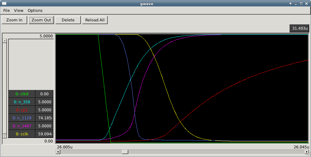

I followed the instructions at viewtopic.php?p=13550#p13550 and was able to capture these images of a simulation of the 6502 netlist (as found in Peter Monta's github project):
The nodenames & numbers are from the visual6502 netlist.

My friend, more enlightened in the hardware stuff said it is "asymmetric cascade inverter", which delays the rising edge, so it seems that the lower level of PHI1/PHI2 is longer than the upper.
This mean Balazs clock envelopes are slighty incorrect.

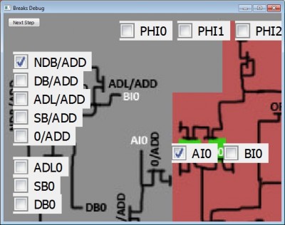

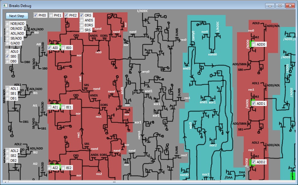

Revised approach to the device debugger. Now its made in the form of a scalable circuit image layout with controls located on top of it and also scaled along with a picture.
Simulated module passing list of "triggers" to the core, which can be controlled through debug interface.
Going to make it as tabbed interface for different parts, when I get rid with Qt :)
Execution simply made by pressing "Next Step" button, which execute "Step" procedure of simulated ciruit and toggles input clock.

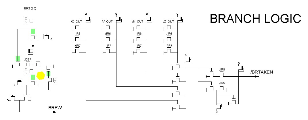

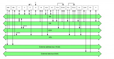

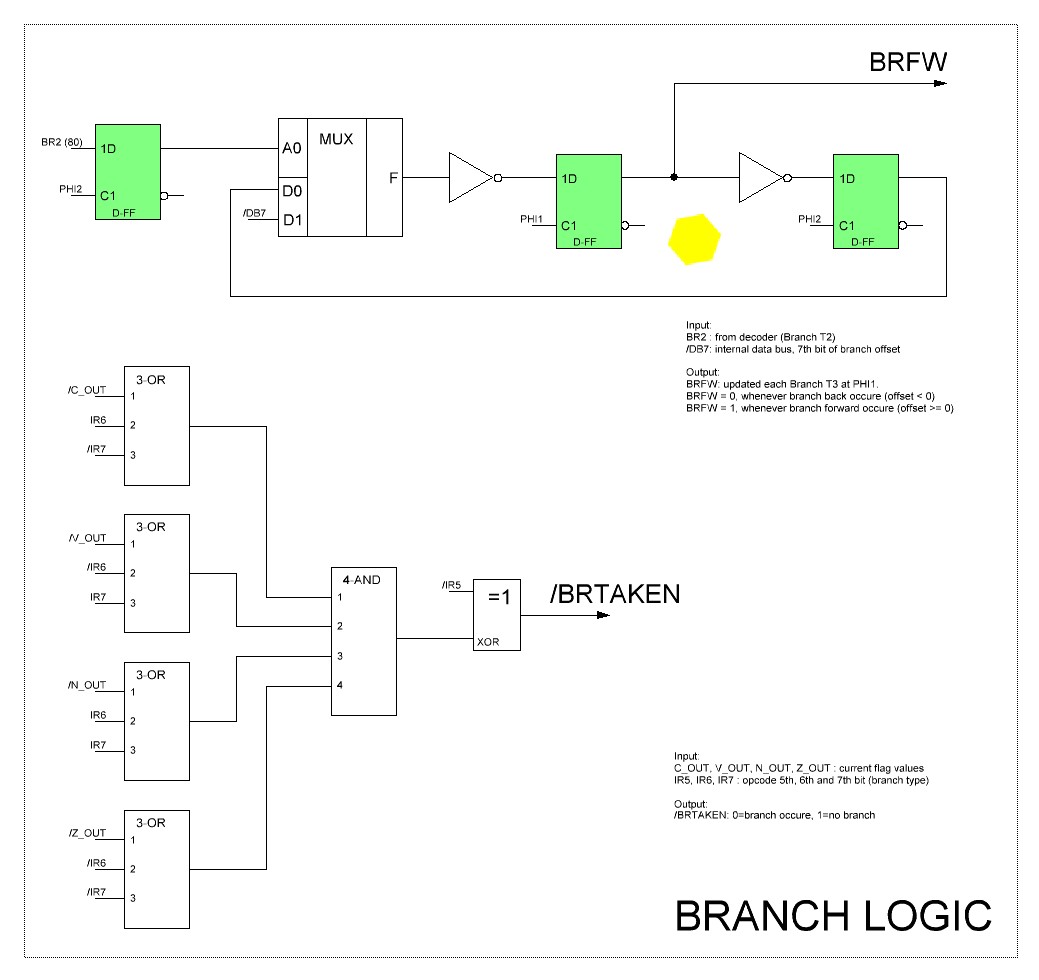

Hi :) I put my latest circuits here

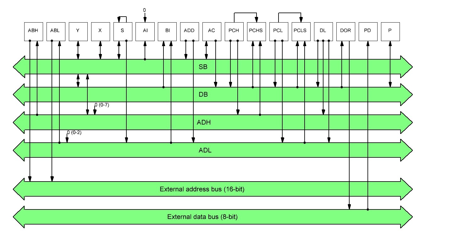

PostPosted: Wed Sep 25, 2013 6:22 pm
Posts: 10793
Hanson's diagram shows SB also connecting to ADH through pass gates...
PostPosted: Thu Sep 26, 2013 5:03 am
Posts: 201
It exist :
6502 addict
PostPosted: Thu Sep 26, 2013 6:43 pm
Posts: 10793
Oh! I didn't see it...

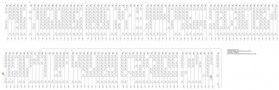

Nice decoder circuit.

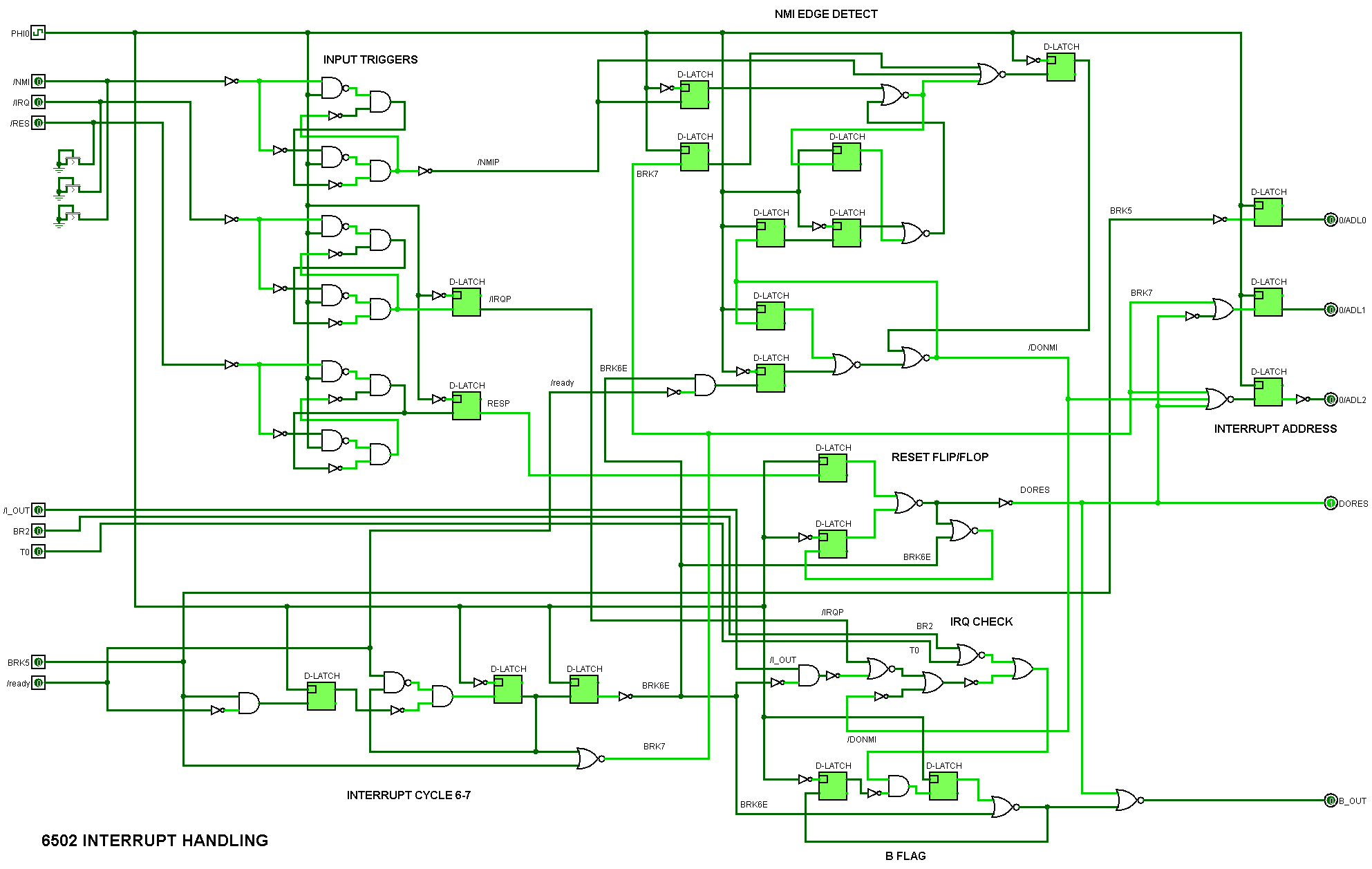

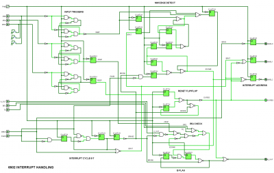

Complete 6502 interrupt processing circuit.
And short description.
Input pads /NMI, /IRQ, /RES are saved in input triggers.
Interrupt generation circuit additionally requires 6 and 7 cycles (since they do not arrive from decoder) (control signals BRK6E and BRK7). Control signal BRK6E begins during the PHI2 of 6th cycle and ends during PHI1 of 7th cycle (overlap 6 and 7 cycle). This is done in order to determine the edge of the signal /NMI. Edge detection of /NMI based on classic edge detect circuit (two cross-coupled RS-triggers).
The signal /RES is further saved on the RESET FLIP/FLOP, as it is required for other random logic circuits (in particular for a special control of R/W pad during reset).
The fact of the arrival of any interrupt reflected on B-flag, the output of which (B_OUT) forces the processor to execute BRK instruction (opcode 0x00). Thus developers unified processing of all interrupts.
Last small circuit generates an interrupt address (or vector) (control lines 0/ADL0, 0/ADL1 and 0/ADL2), which is reflected on 3 bits of the address bus.
The interesting thing is affection of BR2 (Branch T2) and T0 (Execute Cycle 0) control lines on interrupt detection (IRQ CHECK).
In case you wish to play with it in Logisim, you can grab it from SVN:
https://code.google.com/p/breaks/source ... 2/INT.circ
PS. All D-latches are level-triggered. Those one with invertor are PHI1 driven (and in turn PHI2 driven without it).

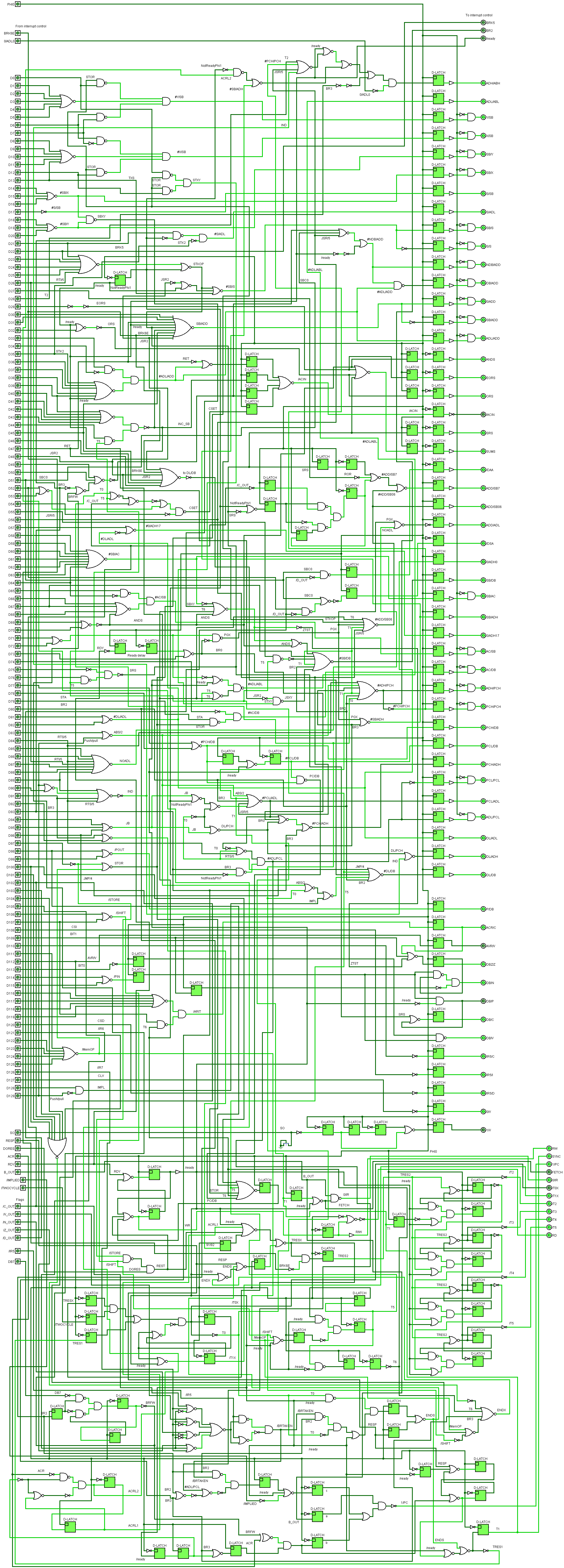

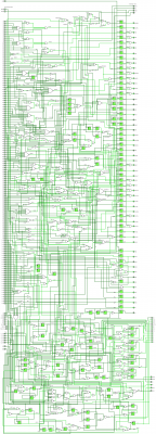

Posts: 201
Here we go !

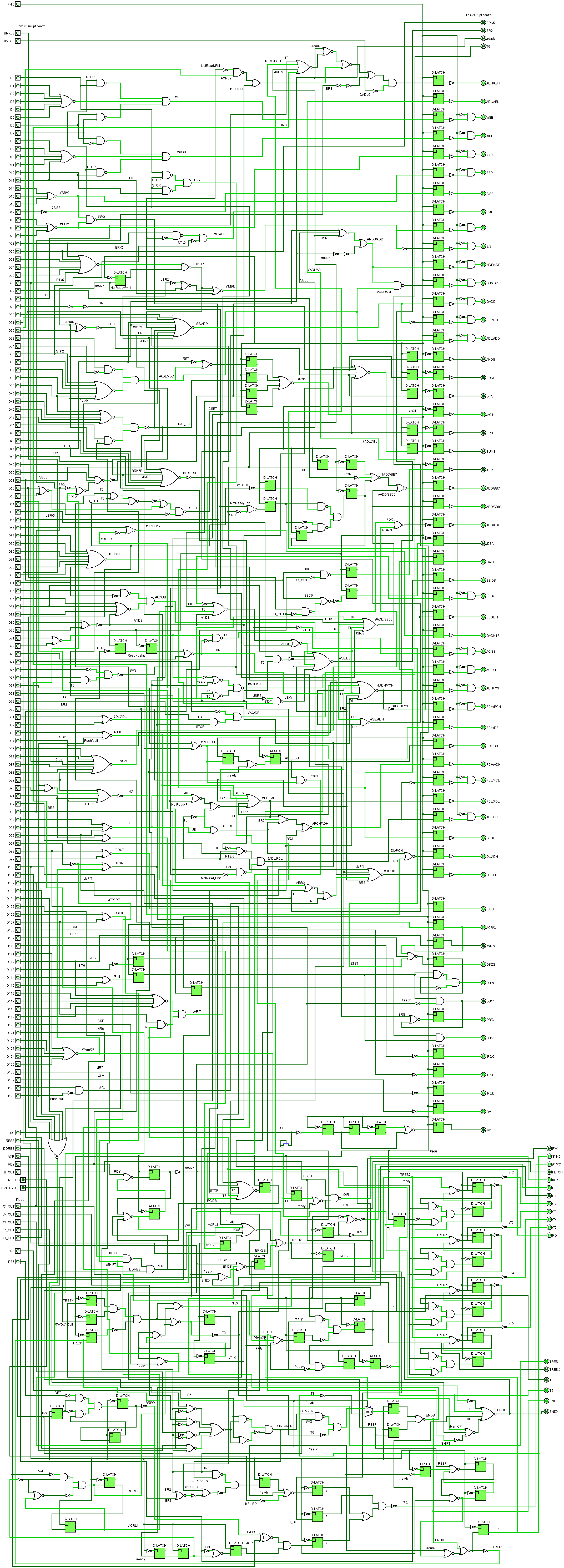

Complete top part 6502 simulation in discrete logic elements!
https://code.google.com/p/breaks/source ... ANDOM.circ
Enjoy :mrgreen:
Sadly its impossible to simulate full 6502 in Logisim, since it doesn't support bidirectional wires and I have no clue how to implement bus-to-bus connections there.
I'm going to implement it in Verilog, check on CPLD and rewrite on C, for my emulator project.
PS. I fixed some bugs in random logic, check updated version in attach.
