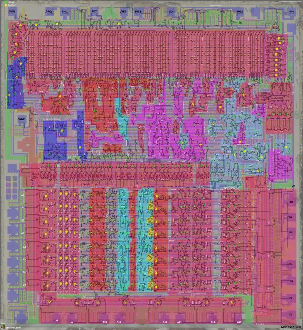

I continued my investigation of 6502 CPU and started to stream it live daily (on russian :D ) :
http://www.youtube.com/watch?v=--etCODbhto
(you can see other videos on my youtube channel : http://www.youtube.com/user/Andorianin )
As result I improved 6502 circuit and studied meaning of some random logic parts :
Purple areas : branch / flow
Red areas : ALU
Blue areas : interrupt-related processing
Cyan : BCD-correction related things
And bright areas are flags (except small blue area on top-right corner near PLA 96 line). Other areas with same bright-red color are just separated between each other.

PostPosted: Sun Jan 27, 2013 3:21 pm
Nice! I don't quite see which areas you mean with "same bright-red color"
I think the dull light blue at middle right is the area you mean to highlight as holding the 6 bits of the status register.
I didn't quite understand what you mean by 'bright areas' - do you mean more than these 6?
PostPosted: Sun Jan 27, 2013 5:58 pm
Posts: 201
For example instruction register or secondary cycle counter (T2-T5) are the "same bright-red color" areas)
"Bright areas" are 6 bits of status register + its set/clear logic.
6502 addict
PostPosted: Sun Jan 27, 2013 6:20 pm
Ah, I see. By 'bright' you mean 'less saturated' perhaps? The red looks faded. But I see the area you mean now.
PostPosted: Fri Feb 01, 2013 9:57 pm

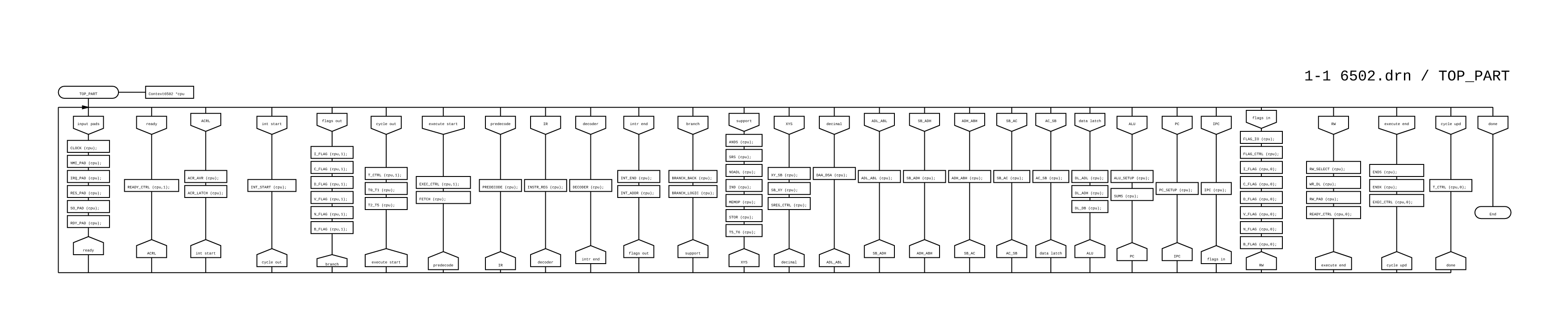

Started to implement 6502 in DRAGON:
6502 addict
PostPosted: Mon Feb 25, 2013 7:28 pm
Hmm - is that http://en.wikipedia.org/wiki/DRAKON ?

I'm using http://drakon-editor.sourceforge.net/ for flowcharts and generate C, as output.
You can get latest drakon-chart on SVN: /breaks/Breaks6502/drakon/

Top part ready :D

Polished circuit again and fixed small errors :
6502 addict
PostPosted: Mon Mar 11, 2013 12:28 pm
Very nice! What's the state of play with the simulation? Have you reached the difficulty of the bidirectional pass gates in the datapath yet?
