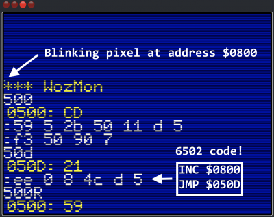

The proof of concept works. All of the addressing modes are implemented, and a fair amount of instructions as well. The v6502 interpreter runs in place of the standard 16-bits application vCPU. Switching between the two is a matter of modifying a zero page variable, so very fast.

I have half of the instructions implemented now, and can more run a bit more complex programs. VGA timing seems to be ok. 8-bits Gigatron code is always a nice cycle puzzle. The hardest nut to crack is the overflow flag from ADC/SBC. Probably it's safe to ignore this as well, but oh well, it is in there now.
I did a more technical write-up on the Gigatron forum: https://forum.gigatron.io/viewtopic.php?f=4&t=128
