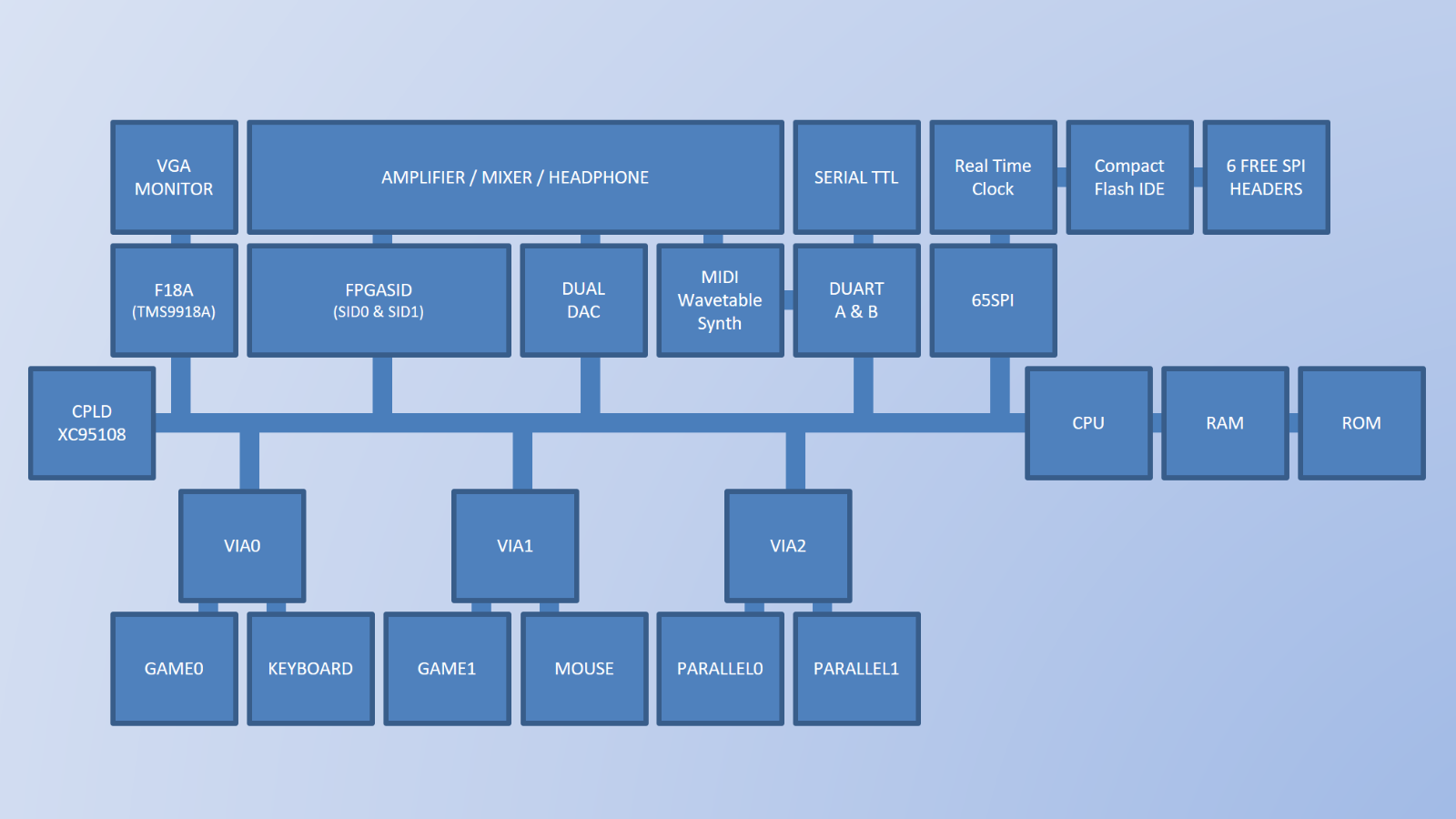

Here is the block diagram for MARC-3 S:

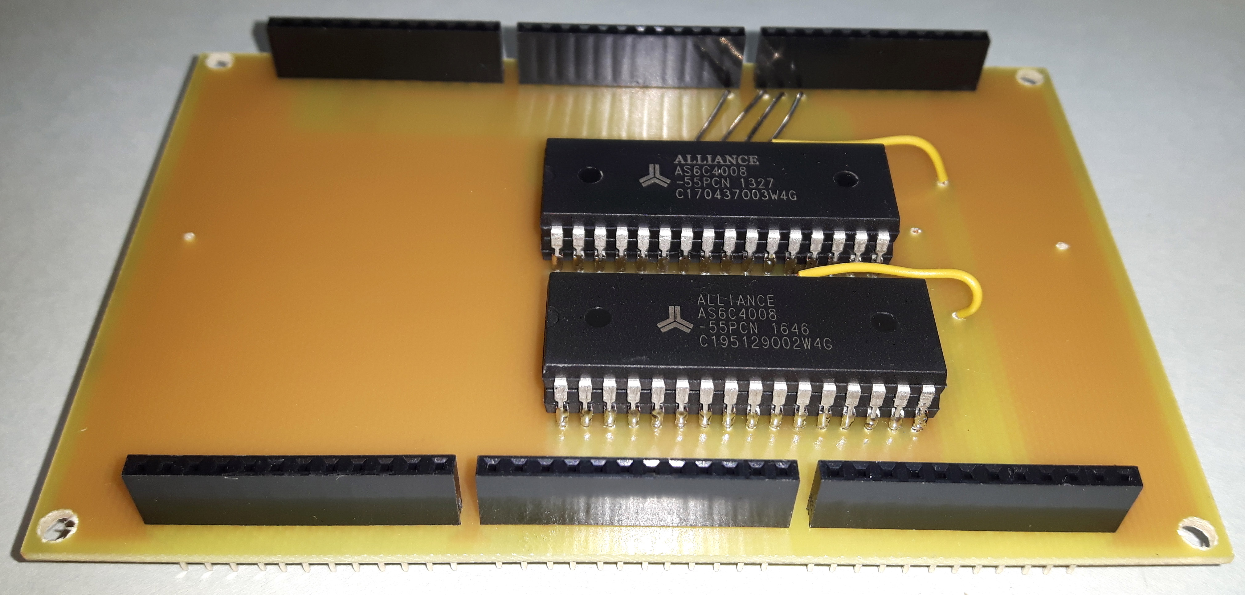

For about 65% of the above mentioned devices / modules I have finished the schematics and PCB layouts, these include the CPU-, CPLD-, RAM-, ROM- and DUART-board. These will be stackable and the basic design for MARC-3 S.

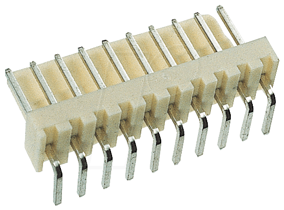

I bought a bunch of 12-pin Arduino headers and 120 x 80 mm single sided copper clads: the build can begin!
Next I’m going to present the CPU-board.

Something I'd be cautious about is the single-sided boards -- which generally are okay, but are NOT great where mechanical stress is present. I'm thinking about the headers you mentioned. These will probably be subjected to a fair amount of wiggling during the insertions and removals that can be expected.
Ideally what you want is for the header pins to be soldered into plate-through holes -- as with the Arduino. Unfortunately, foil only (ie: no plate-through) is much less robust. If plate-through holes are out of the question then at least consider using dual-row headers, not single-row, because the two rows buttress one another to some extent.
Great project! Have fun, and keep us posted!

I didn’t think of the mechanical stress. These special stackable pin headers come only in 12 x 1 or smaller, and I bought quite a few of them as I need six per board, and for the bare minimum computer I need five boards. So another option isn’t feasible. However, being aware of this, I can take some precautions, like lubricate them with contact spray before inserting them. I also could consider not inserting them all the way through, leaving one mm space. OTOH, I guess inserting them will push the copper onto the board, but pulling them out will probably put a lot more stress on the pads.

I would put the socket side of the stackable headers on the non-copper side, and make sure the connector was seated right up against the board, leaving very little room for movement.
 Post subject: Re: MARC-3 S
PostPosted: Wed Jan 24, 2018 11:19 am
Posts: 207
Location: The Netherlands
Indeed, I think that would be best.

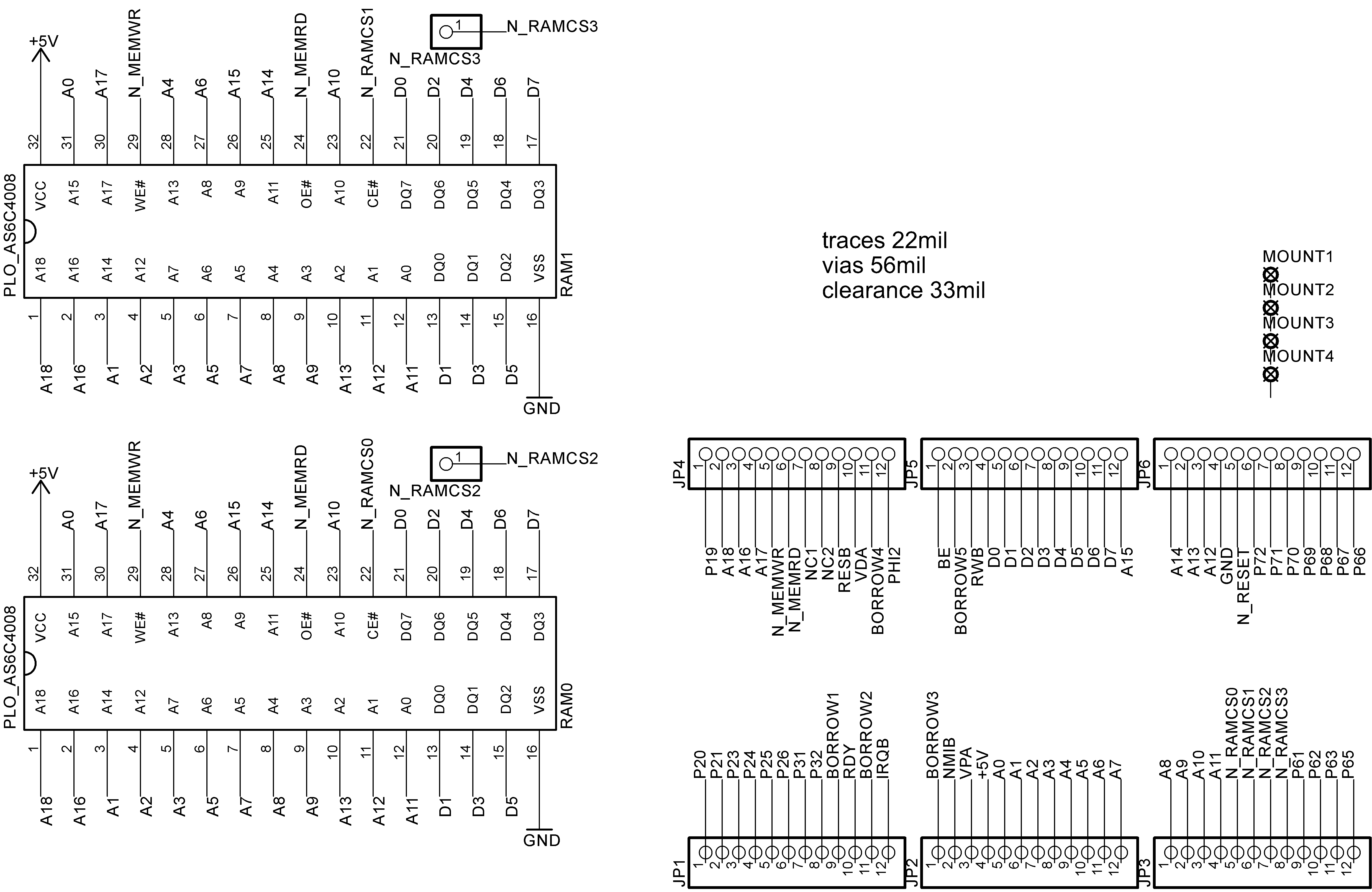

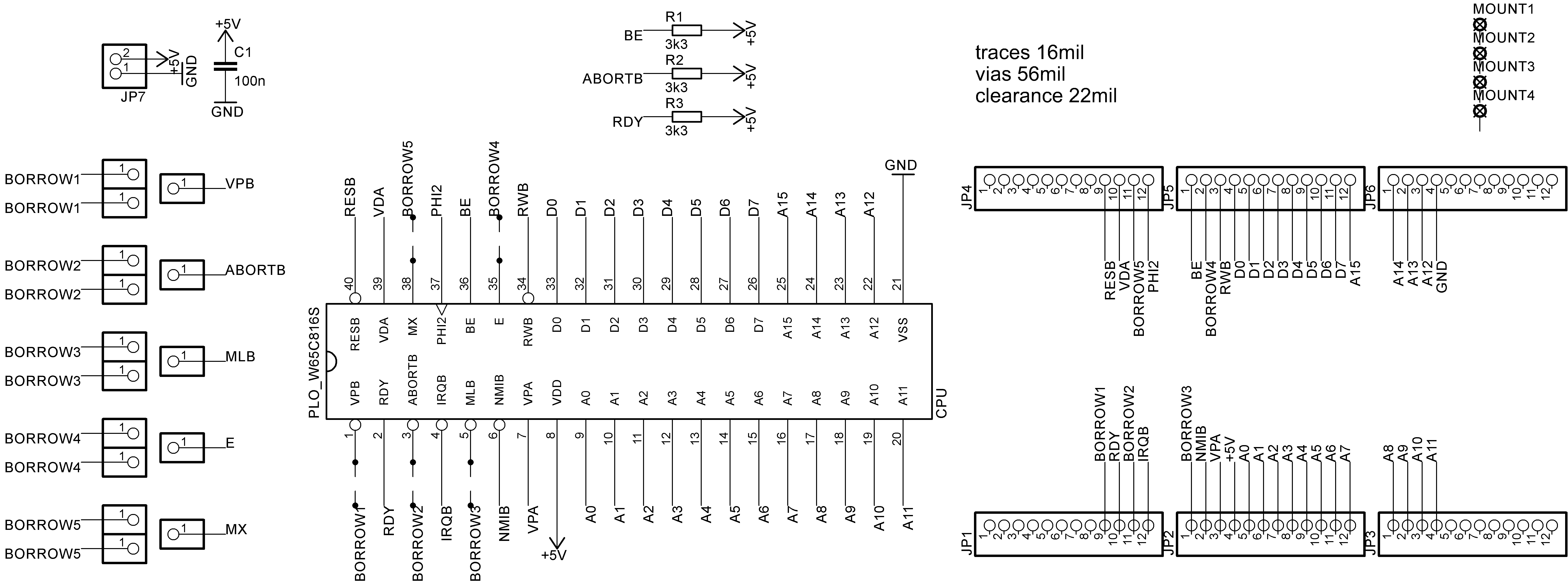

The CPU board:
In the schematic you can see how the headers are organized by the physical layout of the CPU. Most boards won’t need more than a few jumper wires, so that they can be single sided.
I’ve treated the 65816 mystery pins according to this post and Garth’s primer.
However, from the several designs I’ve seen, they all treat them different.
VPB, ABORTB, MLB, E and MX will not (yet) be used. They are all outputs, except for ABORTB, which has a 3k3 pull-up. By means of a jumper, I could tie them to the headers, if needed. Otherwise I could use those header pins for other things, as a last resort if I’d run out of I/O pins on the CPLD.
[edit]
BE, NMIB, RDY, IRQB will initially be pulled high with a weak ‘1’ by the CPLD.
Actually, BE and RDY have external pull-ups.
NMIB and IRQB are set high while not in use.
[/edit]

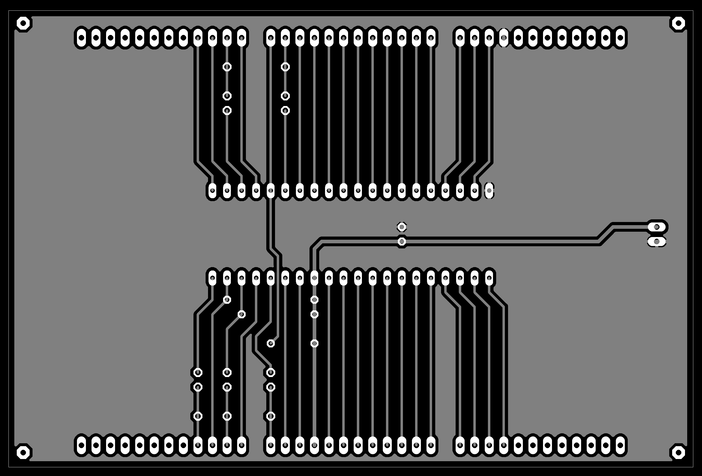

Here’s the first PCB, simple and without jumper wires.
The filled copper polygon is connected to ground, I think that would improve performance?
Marco

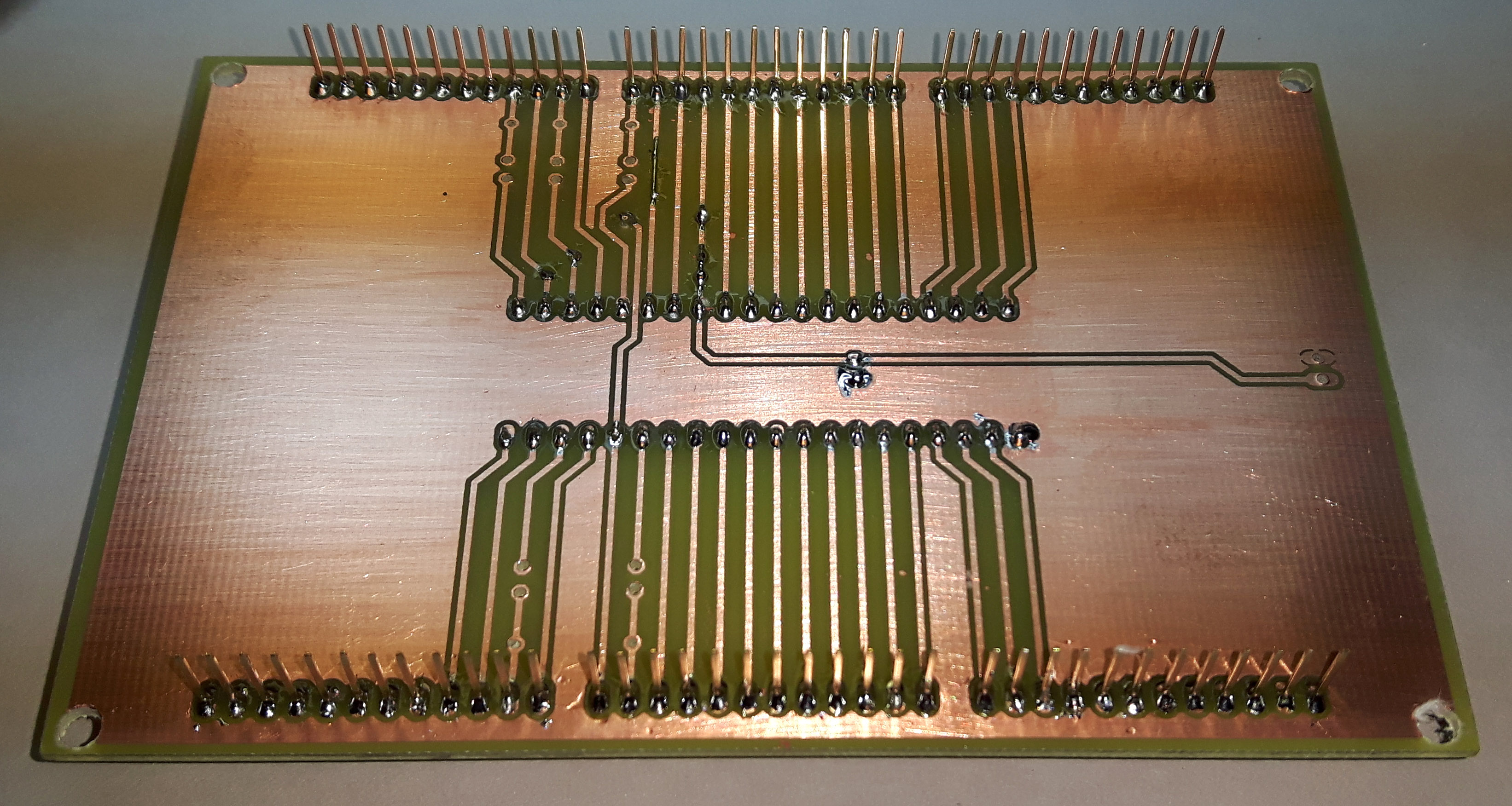

PostPosted: Fri Jan 26, 2018 8:19 pm
Posts: 207
After over etching the first board, the second turned out fine.

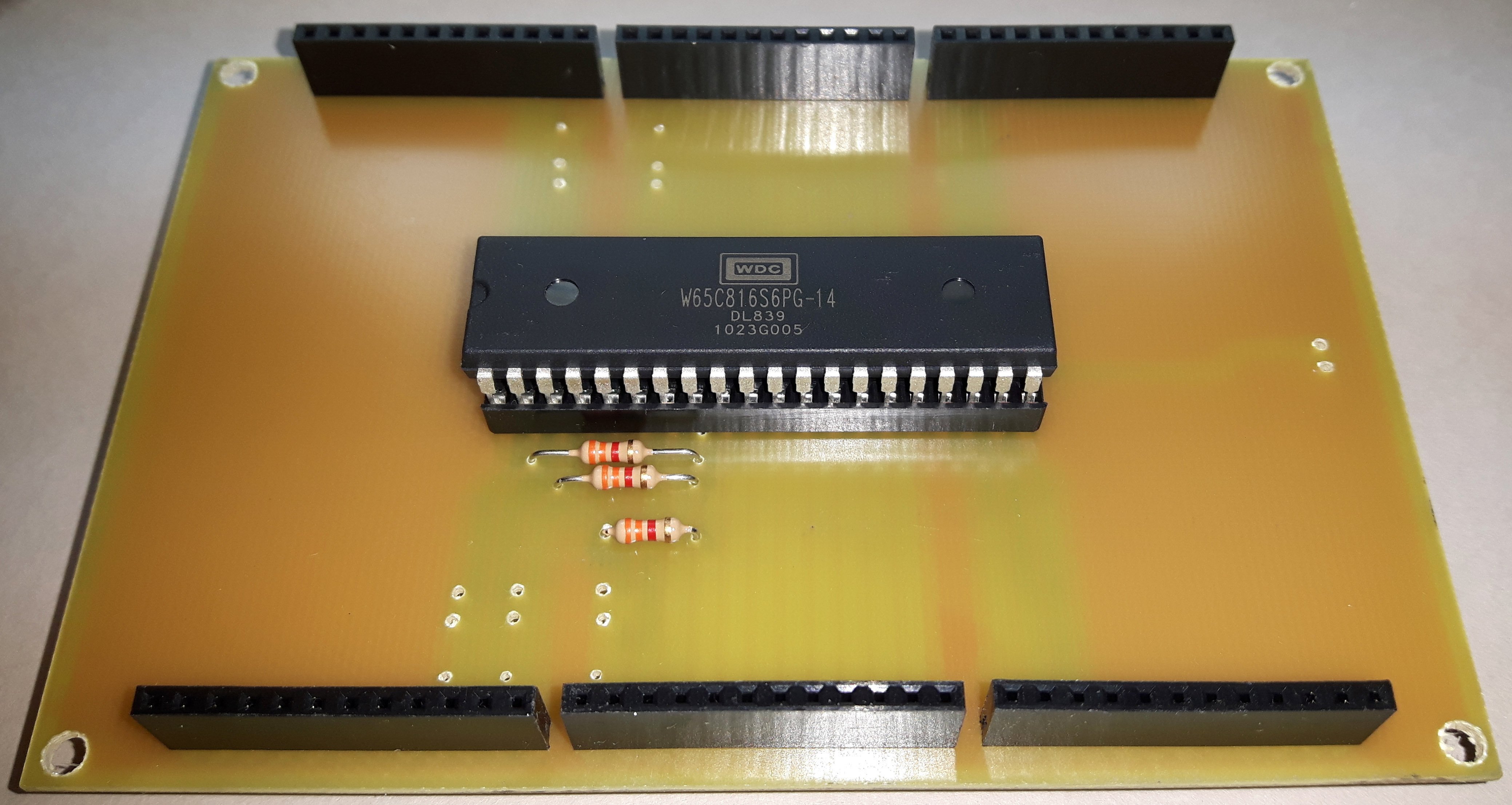

Here's a virgin 65816! :P

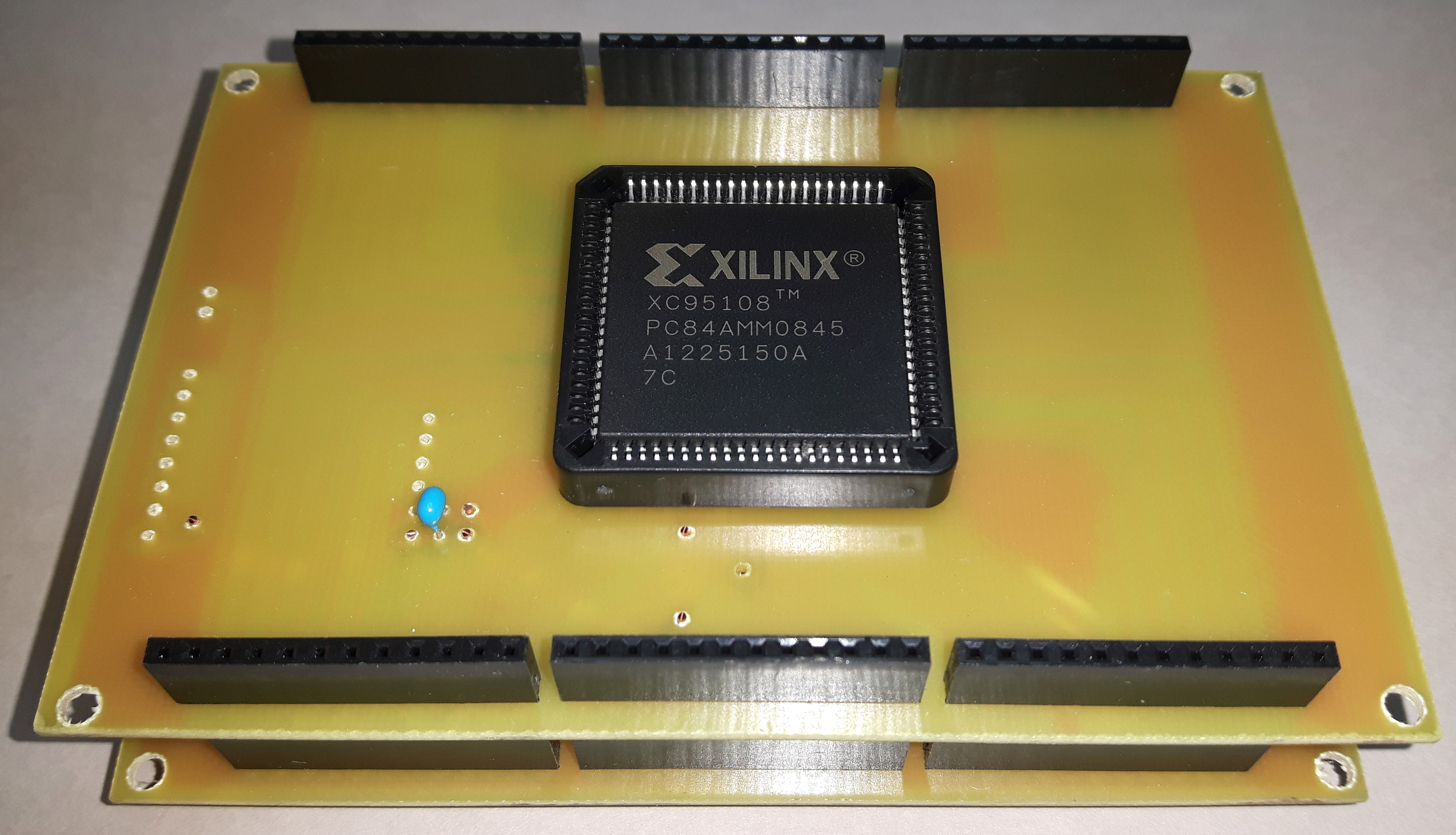

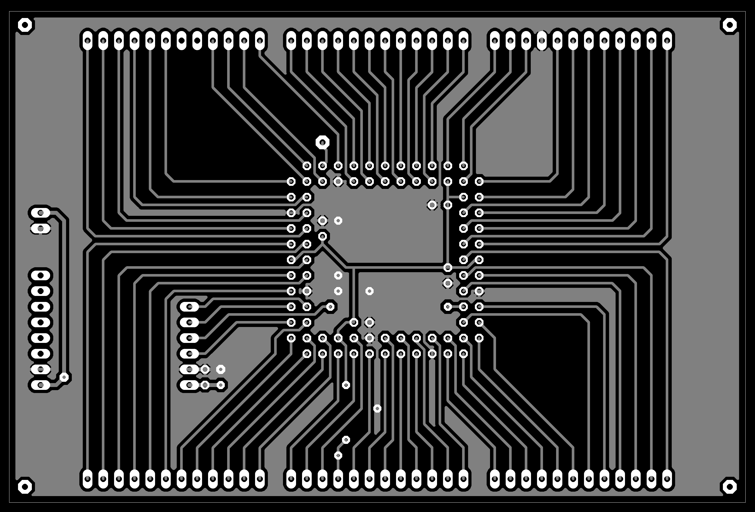

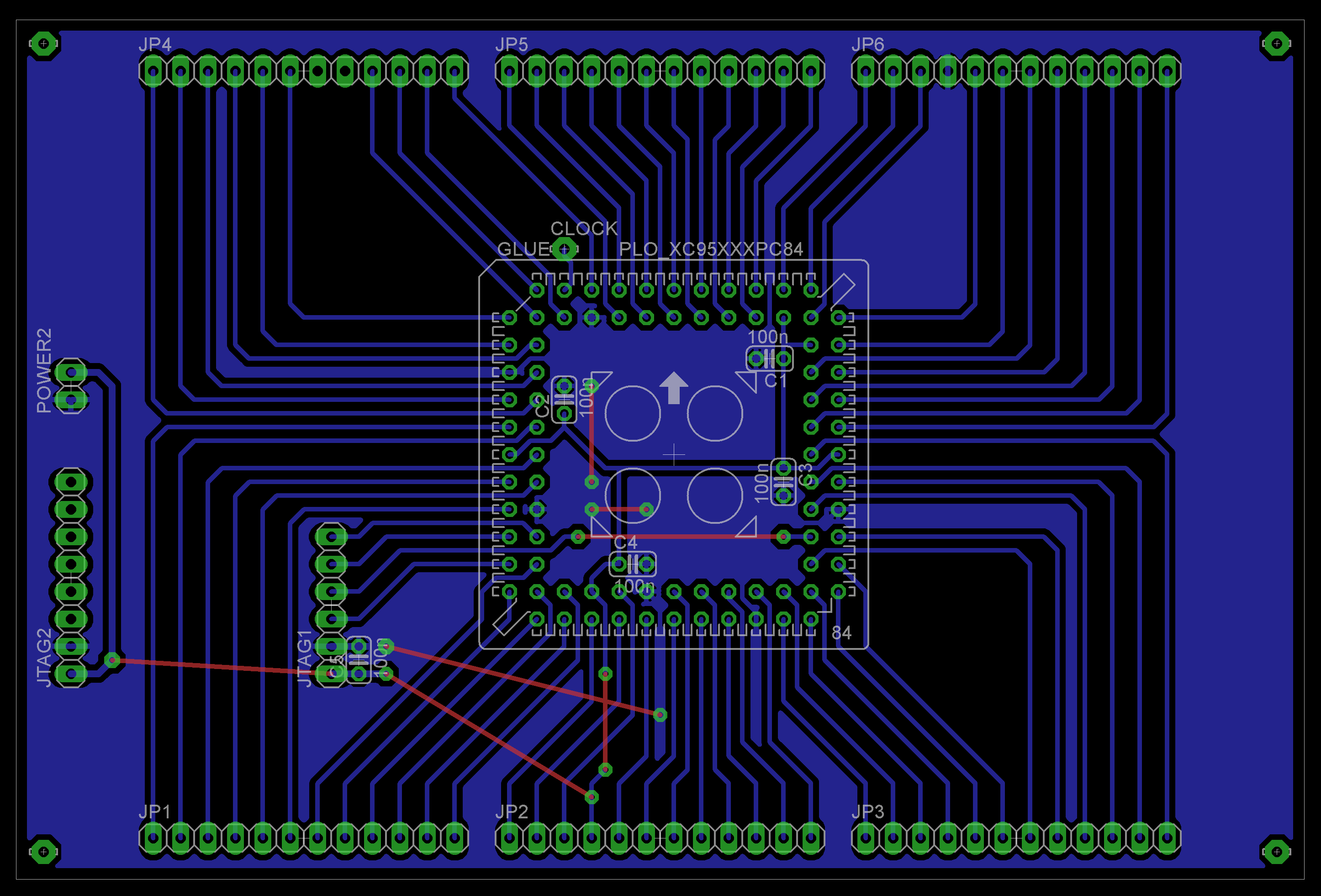

The CPLD board:
As glue logic I’m going to use the XC9572 PLCC84 or the XC95108 PLCC84 if I need more resources. This board is also very straight forward, all I/O pins of the CPLD are connected to the headers, except for the 16MHz clock input, which will come from another source. There are 72 pins in total on the headers, 68 of them are I/O. Two pins are N.C. and the remaining two are +5V and GND. By the way, each board will be connected with a separate power connector, which will provide a more evenly power distribution. A de-bounced reset signal N_RESET, also coming from another source, is added to the headers.
This board is going to provide quite some tasks:
• System clock divider to provide a strong 50% duty cycle PHI2
• SPI External Clock generator
• Reset circuit
• Tri-state various pins during RESET
• UPPER address latch for the ‘816
• Memory read/write qualified with PHI2
• VDA VPA address qualification
• RAM chip selects
• I/O chip selects
• Set 65816 Inputs to defined states
• IRQ handler
• NMI handler
This board needs a few jumper wires for +5V and GND. I had to bring the JTAG connector to the side because of the tight space between the boards. I'll be ordering this kind of connecors.
I've tested the boards for shorts and open circuits, everything seems OK so far.
Next I'm going to test them with a slow clock seperately, and then together...
Marco

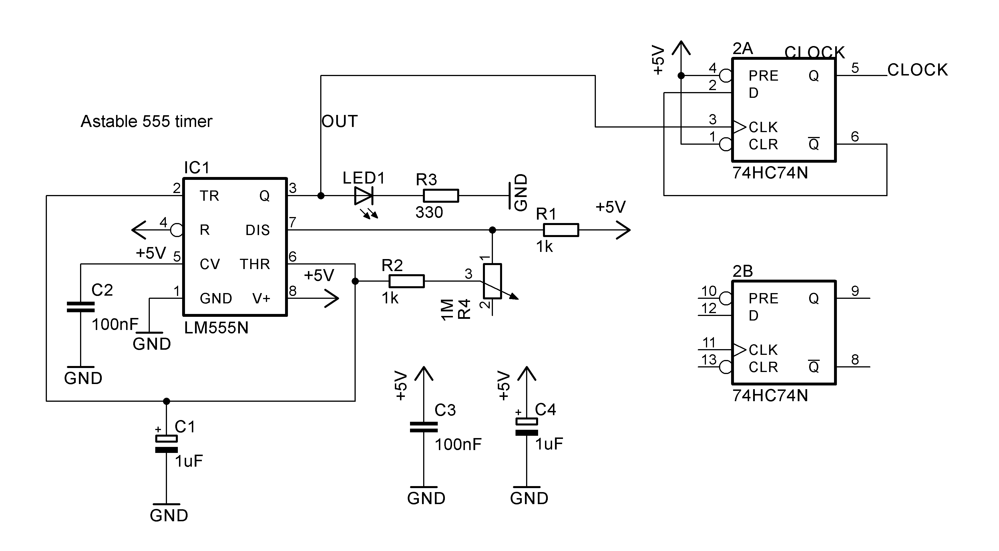

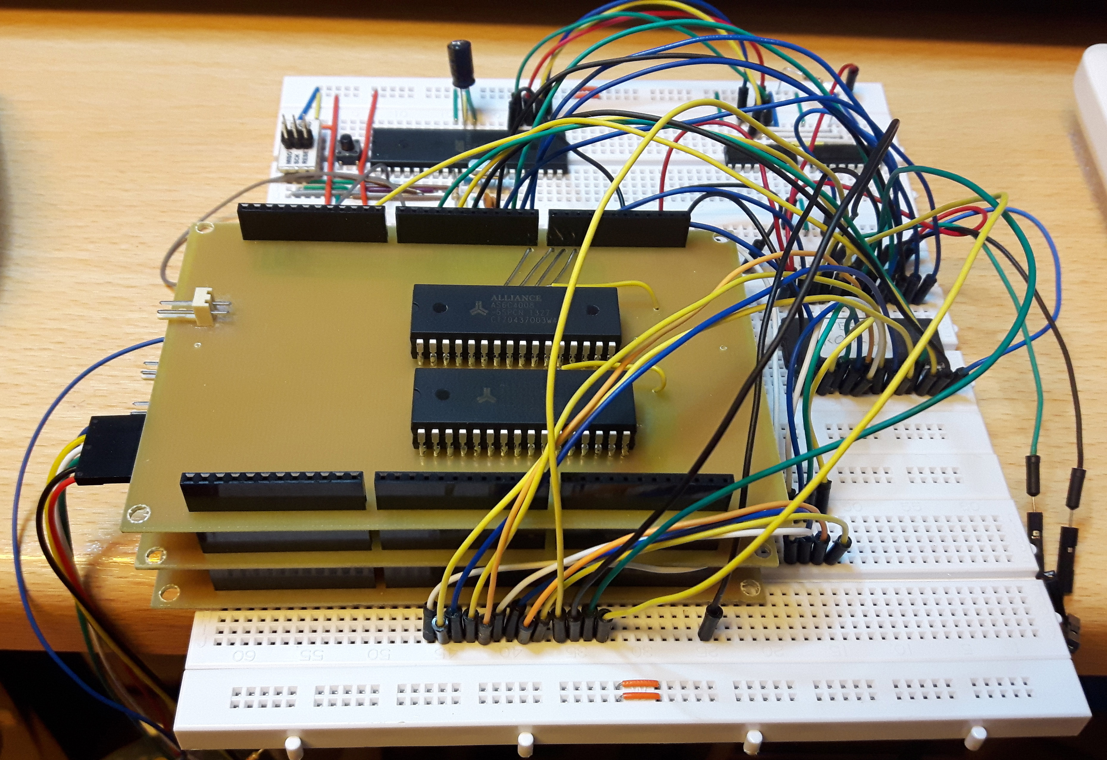

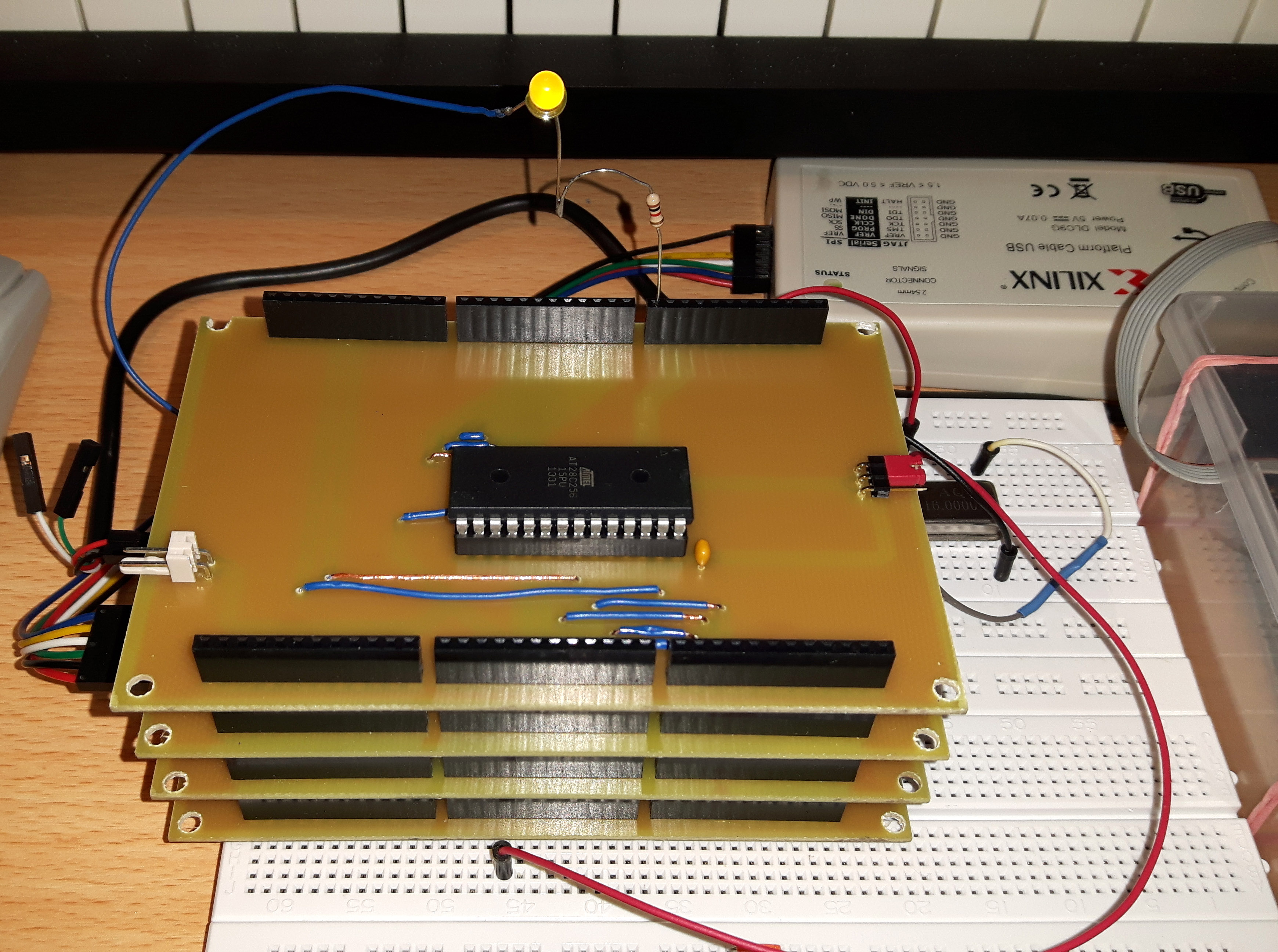

I’ve tested the CPU and CPLD board for shorts and open connections. I’ve also tested the CPU with a free run by setting the data bus to $EA using 10k Ohm resistors. I used a VERY slow clock of about 1 Hz and cranked it up to several kHz and watched the address lines behave like they should.
The clock that I use is an 555 timer astable circuit, eventually I had to add a 74HC74 to get a strong enough clock to make the circuits work perfectly stable. I find this variable slow clock very handy to test the circuit, at least now in the beginning.
For testing the CPLD board, I connected the clock to the first global CPLD clock input and tested all 68 I/O lines individually with a probe. I noticed that the CPLD is even more sensitive for getting a proper clock despite of setting the slew rate of all pins to slow.
Now I stacked the two boards together and want to perform a free run using the CPLD.

The RAM board has two stacks of two 512KiB SRAM’s, making a total of 2MiB.
RAM and EPROM chip select are working fine. Because I have no I/O devices connected to my computer at all, I used a program to test ROM and RAM functionality by checking the address lines going low and high.
; ROM test
; at 1 mhz, the address lines toggle at about 2 second intervals
; program counter will jump from to
; $c000 = %1100 0000 0000 0000
; $ff00 = %1111 1111 0000 0000
; check A8, A9, A10, A11, A12 and A13 for toggling
*   =   $c000
start1      lda #$6
loop0      ldy #$ff
loop1      ldx #$ff
loop2      dex
      bne loop2
      dey
      bne loop1
      sec
      sbc #1
      bne loop0
      jmp start2
*   =   $ff00
start2      lda #$6
loop3      ldy #$ff
loop4      ldx #$ff
loop5      dex
      bne loop5
      dey
      bne loop4
      sec
      sbc #1
      bne loop3
      jmp start1
*   =   $fffa
!word      $d000      ; nmi vector
!word      $c000      ; reset vector
!word      $d000      ; irq vector
; RAM test
; $1000 = %0001 0000 0000 0000
; check A12, A14 and A15 for toggling
*   =   $c000
init      ldx #0
-      lda start2,x
      beq start1
      sta $1000,x
      inx
      bne -
start1      lda #$6
loop0      ldy #$ff
loop1      ldx #$ff
loop2      dex
      bne loop2
      dey
      bne loop1
      sec
      sbc #1
      bne loop0
      jmp $1000
start2      lda #$6
loop3      ldy #$ff
loop4      ldx #$ff
loop5      dex
      bne loop5
      dey
      bne loop4
      sec
      sbc #1
      bne loop3
      jmp start1
      !byte 0
*   =   $fffa
At the far end on the bread board there are an ATmega1284P and two 74HC595’s. These are for the ROM emulator, clock and reset. I have prototyped them and the ROM board is in the making.
I guess it's not really a ROM emulator, but more like a RAM programmer. :)

Finally, I’ve got a working system!
The fourth board became a “simple” EEPROM AT28C256 board.
I only decoded it to 0C000-0FFFF.
The CPLD logic does not yet:
• Decodes addresses A16..A18, they are just set to “000”
• Decodes the four SRAM chip selects, they are just set to “1110”
• Do anything with IRQ or NMI, they are both set to “1”
So that’s something to do, but it’s working so far.
I plan on copying the EEPROM’s contents to RAM during RESET and turn the it off for more speed. The AT28C256 is only 150ns, so that should be good for 6,67 MHz, but the contraption above actually runs at 8 MHz, however that’s without any I/O devices.

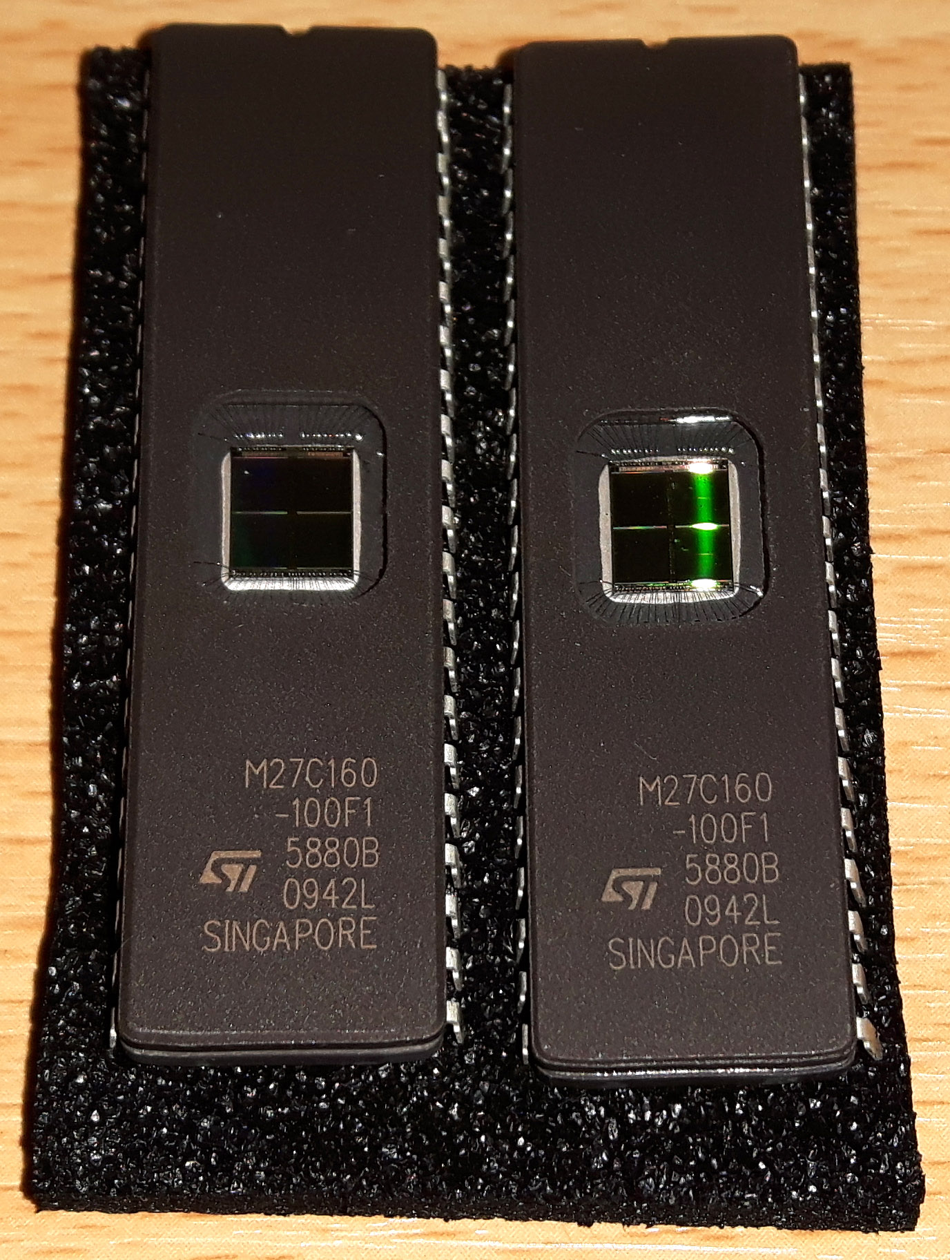

Besides the EEPROM I also have two of these puppy’s lying around:
They are 2MiB, 100ns, that’s good for 10 MHz. I could use them for permanent math tables, graphics or sound samples etc. I don’t expect my computer to run at more than a maximum of 8 to 10 MHz.
I’m not planning to implement DMA or a co-processor because at a max of 8 to 10 MHz and the 24 bit address and 16 bit data capabilities of the 65816, I don’t really need that. I do plan my software to run in a 60Hz interrupt loop, that is, the F18A is generating a VBLANC signal. That means that graphic updates are performed at each new frame. In those 16,66ms, the CPU can do a lot more things than a C64 for instance.
