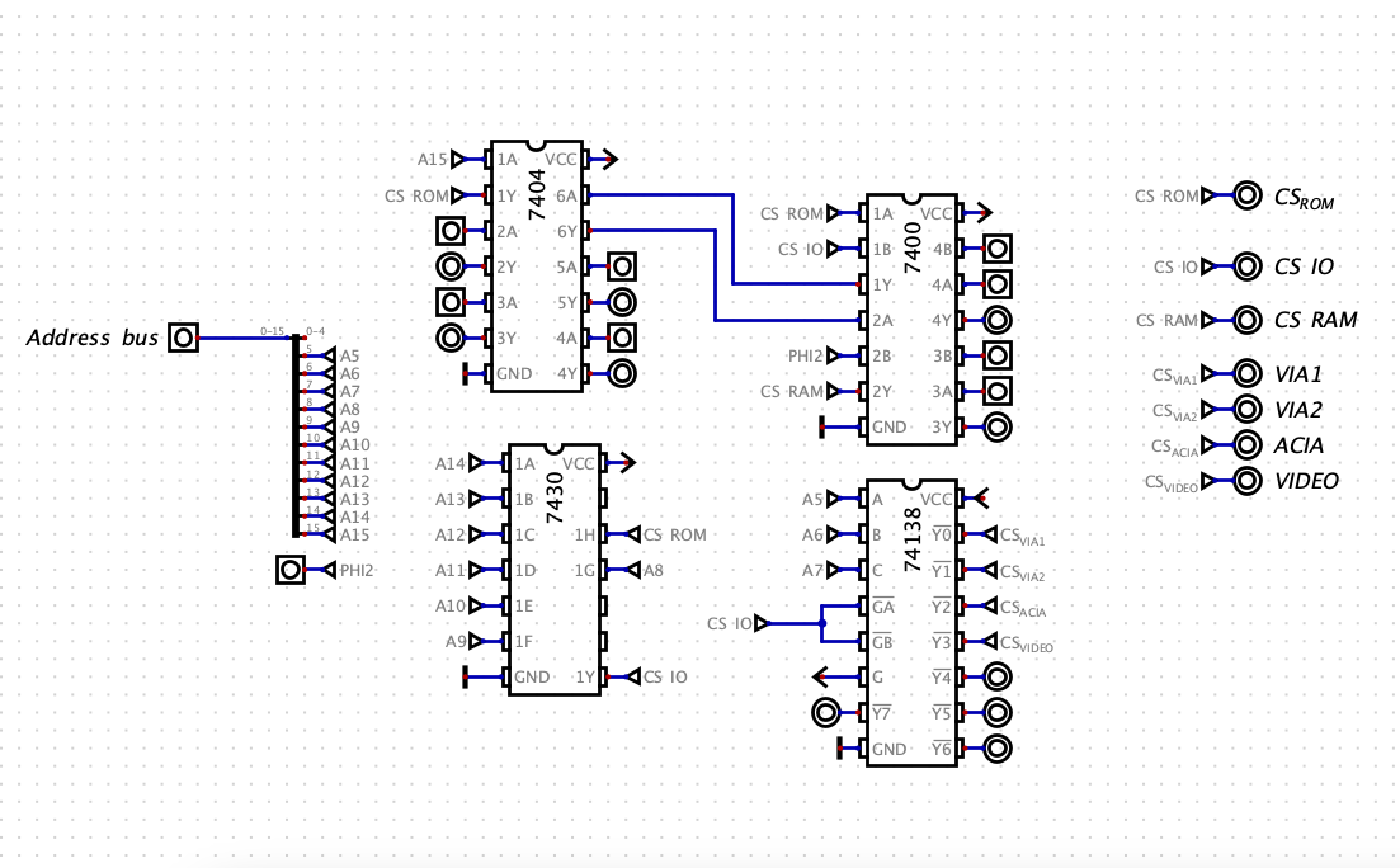

I would like to build a 6502 based computer. I'm not very experienced so it wil be quite an ambitious project. I wanted to share my plans with you all so you have an idea about what it is I want to achieve. I have a lot of loose ends that I need to solve I will need to make a lot of choices but I have a general idea. So here is my plan.
I want to build a computer that is a bit like the early home computers from the 70's and early 80's. I want it to be in a 3D printed case with a build in parallel ascii keyboard. I want it to have two controller/joystick ports (Sub-D 9). I want to be able to control the computer via a terminal from a modern laptop. And I want it to have some kind of storage to store programs. And it also should have color video output of some kind. And also I want it to have an audio output. I want to use this computer for game development as well as os development so that is why I want to have video/audio output. I'm from 1980 so I'm a bit spoiled I just like color better than only grayscale.
Now I already did a lot of research but there are many options so here are some options I consider and ideas of what I want to achieve.
Clock
I want to use a 10.738635MHz clock that I want to divide by 3 as a system clock. I need the 10.738635MHz clock for my video chip which I will discus later. By diving it by 3 it can also be used for the sound chip I would like to use. This way I would have a 3.579545MHz system clock.
The memory map
I want to build something similar as Dirk Grappendorf did with his 6502 home computer https://www.grappendorf.net/projects/65 ... f-contents. I have a 28c256 ROM chip and 62256 SRAM chip that I want to use. I want to use the same memory map:
$0000 - $00FF RAM - Zero page
$0100 - $01FF RAM - Stack
$0200 - $7EFF RAM
$7F00 - $7F1F VIA 1
$7F20 - $7F1F VIA 1
$7F40 - $7F5F ACIA
$7F60 - $7F7F Video
$8000 - $FFFF ROM
But I want to add a second 65C22 and a 65C51 chip. Here is a screenshot simulation made in Digital:

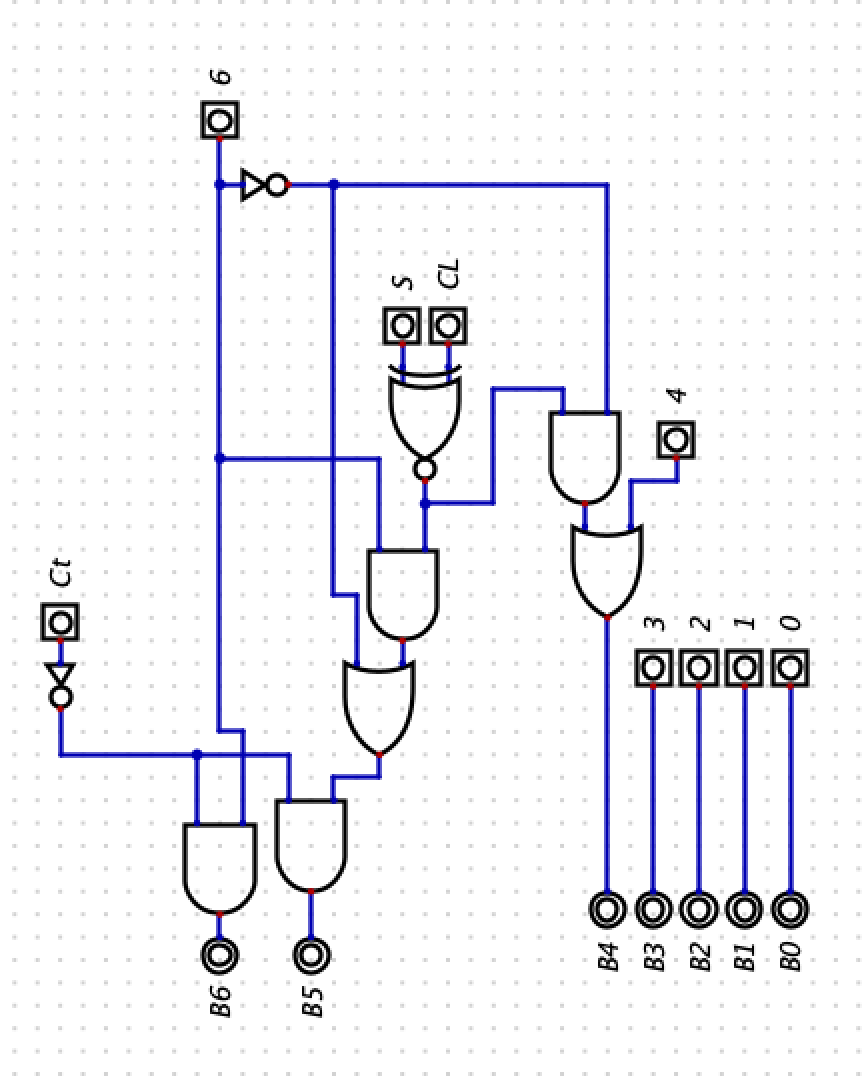

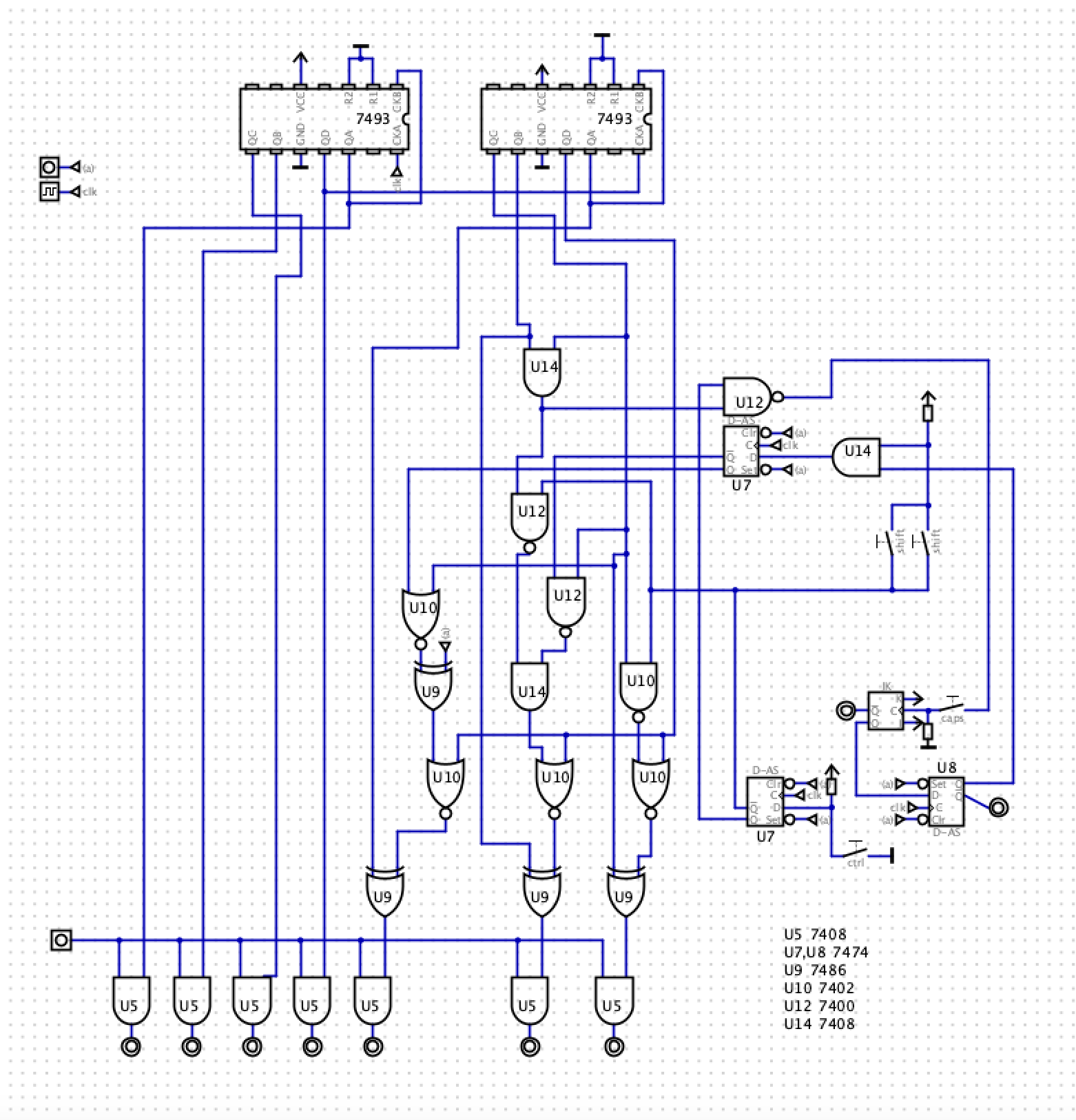

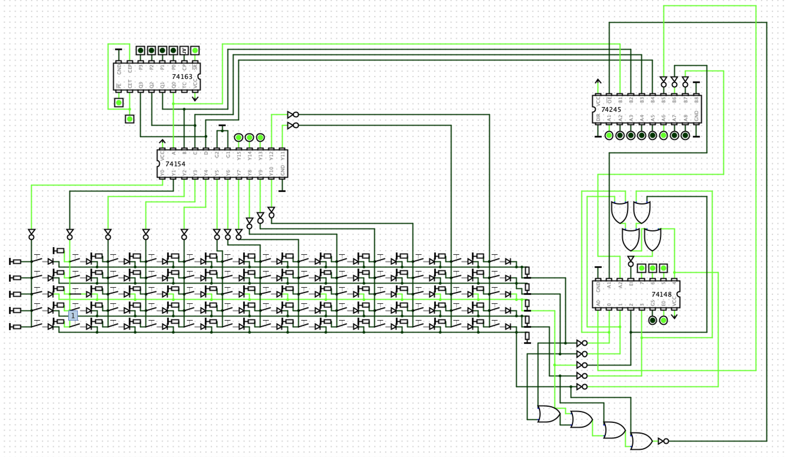

The parallel ASCII keyboard
I want to build the keyboard from logic chips and Cherry MX style switches. The idea is to create a keyboard that outputs 7-bit ASCII codes that I want to connect up to a 6522 via. I have found an old schematic in an old Brochure of the Cherry B70 Pro keyboard on bitsavers http://bitsavers.trailing-edge.com/comp ... ochure.pdf. This keyboard is quite complex and it has a lot of optional parts that I'm not interested in. I want to try to create something similar but a lot simpler. I like the combination of the 4-bit counters and the 74150 (16-line to 1-line data selector/multiplexer) and 74154 (4-to-16 line decoder/demultiplexer, inverting outputs) to scan a keyboard matrix. But the logic for the shift/Caps Lock (Alpha Lock in the schematic) is quite complex and I don't really understand what is going on. I did an attempt to replicate the circuit in Digital here is the result:
But unfortunately it does not work. I added an extra flip-flop to for keeping the caps lock on after clicking the key once and turn it of when clicking a second time. Unfortunately Cherry does not make alternate action switches any more since 2015 https://deskthority.net/wiki/Cherry_MX_Lock.
As I could not figure out how the logic of the Cherry B70 Pro works I tried to get something working myself. The theory is quite simple. I found the article Things Every Hacker Once Knew http://www.catb.org/esr/faqs/things-eve ... ew/#_ascii there is a explanation about the workings of ASCII together with the Wikipedia page about the Control key https://en.wikipedia.org/wiki/Control_key I found out how this could work. The Caps lock/Shift key toggles bit 32 or bit 16 dependent on the key you clicked (for 0-9 and keys : ; < = > ? bit 16 is toggled and for keys a-z and ` { | } ~ DEL bit 32 is toggled). The control key could be implemented by doing a bitwise AND on the key value with 0x1F.
I have a working simulation made in Digital but it doesn't take bit-5 into account yet and the clock circuit is not there yet I wanted to keep it as simple as possible and just focus on the shift/caps lock and control logic. Here is an screenshot taken from the simulation. It has tests and they all pass but the implementation is not correct. Perhaps someone has some tips or suggestions.
The keyboard will be on a separate PCB.

I also found keyboards with a ROM chip as a lookup table. Don Lancaster's TV Typewriter also uses a ROM chip the 2513 character generator https://amigan.yatho.com/2513.pdf. So my first attempt could also still be an option.
I still think it would be more rewarding for me at least to have an ASCII keyboard made of logic chips. I first thought about using a modern keyboard layout but that would be a pain as the layout has some differences.
Re: My 6502 computer
I note that this https://www.digikey.de/en/products/deta ... 4JYgC6AvkA is still available, if you happen to want twenty
I could just program an eeprom to do something like that. In my simple keyboard something like that would be possible.
There the 4-bit counter indicates the column selected. I have 4 rows in my design. When you press a switch and the column is active it would output the clock in the first 4 bits of the 74245 and then the column number in the following 3 bits. In this example column number 1 (counting from zero) and row 2 are selected:
I could hook the output of the 74245 up to an eeprom together with the shift/caps-lock and control keys to the address pins of the eeprom and have the eeprom programmed with the right ASCII code at that address. The 74148 and the logic gates there are to encode the selected row.
In my design I used only 7 out of 8 bits as output. I could add another row or column to make use of that last bit.
viridi wrote:
I'm presuming the goal of the 245 is a connection to the 6502 databus. You'll likely want to drive that OE pin with the 6502 and not when someone presses a key. (Otherwise you'll be sending signals down the databus when other devices are trying to use it.)
I'd likely use that logic to toggle a flop to signal an interrupt on the 6502 that a key is ready to be read.
When I was looking into to doing this with a PIC, I planned to use some of the onboard memory of the PIC as a ring buffer for the keys pressed. That way the key strokes could be read by the 6502 when it was ready.
Something similar could be done in hardware, but I haven't been able to find any memory ICs with a reasonably small queue. (Most are phenomenally huge these days, at least for a simple keyboard buffer)
Edit:
Here's what I'm thinking with simplifying this: (Edit/Edit, fixed a minor logic flaw I saw)
why not just use one of the VIAs directly?
assuming you don't use the VIA's handshaking feature you can use the CA/CB pins as free I/O.
so a 74HC163 with it's clock and reset inputs hooked up the VIA's CA2 and CB2 pins (with some pull ups or pull downs). the output of the counter goes to a 74HC154 which then goes to the keyboard matrix. the other side of the matrix is then simply hooked into the VIA's regular IO pins (however many are required, though even just 8 inputs give you 128 keys).
so to scan the keyboard (assuming 74HC163 clk = CA2, reset = CB2, matrix input on Port A) once you:
1. reset the counter by pulsing CB2
2. read the value from Port A and store it into memory
3. pulse CA2
4. repeat 2 and 3 a total of 16 times
5. now either leave the raw keyboard data in memory for non-ISR code to handle or directly convert it to a bit/bytemap of which keys are being pressed at the moment.
sure it's a lot more software overhead and based on polling (i recommend some form of timer interrupt anyways), but it keeps the IC count low and makes hardware less complex.
which is good because fixing software mistakes is a lot easier and requires fewer cuts and botch wires than fixing hardware mistakes!
plus you still have one of the ports free which you could use for some software SPI for some cheap expansion (SD Card, RTC, various sensors, tiny displays, etc).
3. pulse CA2
Yuri wrote:
Lot of inverters there that appear to be changing the signal multiple times. Might be able to strip a few of those out.
