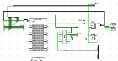

This is part of my investigations into the various ways one might generate vga signals as simply as possible but without using programmable logic devices. This uses an eprom/eeprom/flash so it comes close... inspired by this video by Dr Matt Regan: https://www.youtube.com/watch?v=qO1dNRKHeb4
The approach he uses doesn't quite work for a number of reasons for VGA, not least of which is the increased memory width required, so I did some thinking.
State machines
A state machine can be easily built using a prom and a latch of its outputs, with the latched outputs fed back to the address inputs of the prom. On each clock pulse, the latch will read the current output and deliver it back to the input; the next clock pulse will latch the data at this new address.
An incrementing counter is probably the most simple: it requires only that each memory location contains the address of the next location.
An arbitrary sequence can be generated in this way, for example the count required for a video output can be implemented at any length just by letting the last address refer back to the start address of the line: 01→02→03→04→00 (that’s a very short line!).
This approach can be used for both the character position in the line and the line count through the video field. The syncs and blanking can be encoded using higher bits in the address to enable their extraction without external logic.
Ideally, to save circuit board real estate, one would want to use a single prom. Commonly available parts are 8- or 16-bits wide.

Re: Eprom state machine for vga address, syncs, and blanking
On this basis, our state machine contents look like this (in hex):

This works, with each line in memory 0x50 bytes further in memory, but there are some issues: first, this is only going to work for a graphical interface, not a mapped character interface (though of course you can plot characters at will) because different memory is read for each line. Secondly, we need to output 525 lines. At one hundred character per line, that’s a total of 52,500 memory addresses – requiring sixteen bits to address and with the addition of the control signal, nineteen. So we’re looking at two or three proms, not to mention the vram requirement. Even reducing the references to only the 80 bytes per actually displayed line doesn’t help a lot; we’re still looking at 42,000 addresses.
To keep the address space manageable we need to restrict ourselves to character cells. In those terms, the visible space is now only 2400 bytes (80 * 30) and the total space including blanking is 100 * 34 = 3400 bytes (actually a little less, but we’ll see).
However, we need a way to repeat lines and yet somehow move between cells. Unfortunately this needs more hardware. Suppose we use a counter such as a ‘163 to count lines. We need to count on a low-going edge at the end of each line, so an inverter is required. Now the prom doesn’t generate an in-character line count; instead, we use the output from the ‘163. Each block of sixteen lines is now represented with two sets of data: one in which the last line entry points to the start of the current character line, and one which points to the next line.
0001 0002 … 004f 2050 2051 a052 a053 … a05d 205e … 2063 0000 ← points back to same line
0081 0082 … 00cf 20d0 20d1 a0d2 a0d3 … a0dd 20de … 20d3 0100 ← points to next line
We increase the bytes per line to 128, even though we only use a hundred of them, so that we can remove the bit 7 from the address feedback and replace it with the terminal count output from the ‘166. That occurs only on line 15, so the sequence repeats the first line of addresses fifteen times, then the second line just once. We ignore bit 7 in the vram address, so both of these refer the same video ram data. From there it goes to the second video line address starting at 0x0100.
When we have output thirty lines of characters, our last visible line started at address 0x1d00 and ended at 0x1dd0.
Field timing
But things get interesting at vertical blanking, which starts at line 480. We have ten lines of front porch, two lines of field sync, and the remainder – thirty-three lines – are also blanking. Each of these lines also requires horizontal blanking and syncs.
On top of that, we’re about to run out of prom: we can’t use any address higher than 0x2000 or we’ll interfere with existing blanking data. We can’t use a character address greater than 0x..40 or the ‘166 will be clocked, and we don’t want that because the field syncs and end of field don’t fall on tidy boundaries…
But: all the previous uses of the 0x2000 blanking area have all been with low addresses over 0x..4f or 0x..df, so we can use the rest of the space. And if we only use the ranges 0x2.00 to 2.3f then the ‘166 will never be clocked. The addresses output will not have any useful relationship to video ram, but as they are in blanking we don’t care.
Simplicity!
So now, for simplicity, the last character position takes us to 0x2000. From there, we use partial lines to avoid clocking the ‘166:
2001 2002 … 203e 203f 2080 ... a082 a083 … a091 2092 … 2100 ← blanked line with sync
repeated ten times, then two field syncs:
6a01 6a02 … 6a3e 6a3f 6a80 ... ea82 ea83 … ea91 6a2 … 6b00
6b01 6b02 … 6b3e 6b3f 6b80 ... eb82 eb83 … eb91 6b92 … 6c00
And after that, the remaining blanked lines as from 2000… simple!
The only remaining detail is that the syncs and blanking are, as shown here, inverted. We need them the other way up, which moves the whole data around in the prom (which is of course mostly empty). Since they’ll be programmatically generated, that’s not an issue, but if we keep them as they are, they’re perhaps a little easier to follow. We’ve had to use one inverter, so we will probably have another five units handy in an ‘04 part which we can use.
So the entire video addressing, blanking, and separate sync circuit can be fitted in just five chips: one 64k x 16 prom, one ‘163 counter, two ‘574 latches, and one ‘04 inverter. The complete video circuit will require other parts, of course: another ‘163 to divide the dot clock down and generate a latching signal, a character rom, another ‘574 to latch the data from the video ram, and a ‘166 to serialise it.
ironically, a PROM could technically be counted as "programmable logic" if you use it like a LUT (Lookup Table) to build a state machine
For testing VGA circuits i'd recommend Digital as it has a pretty accurate built-in VGA component and 74' logic chips as well so you could build and test the whole circuit in the simulator before making it reality.
on another note, what PROMs are you planning on using that are fast enough to run at 25MHz (40ns)? even ST's Flash chips only go down to 55ns.
and you do need it to update the state machine once per clock cycle to do the sync signals properly as even just running them at 12.5MHz would offset the Horizontal Sync signal by exactly 1 25MHz clock cycle.
but if you could somehow use those Flash chips, you can save space by using the PLCC versions, 2 of which take up around the same PCB space as a single DIP Flash/PROM. and using 3 of those you could (i think) completely avoid the need for the '163. unless i misread something.
with 3x SST39SF040's you have a LUT with 19 inputs and 24 output.
It doesn't need such a high speed prom: it's clocked at character rate, not pixel rate. First thought is something like an SST39VF801C / SST39VF802C / SST39LF801C / SST39LF802C so anything faster than about 300nS would be quick enough. The hsync pulse happens to fall exactly on a character boundary, so there's no worry there.
Even running it as a monochrome graphics output doesn't need to be any quicker (and takes fewer parts - no external line counter) but of course requires a lot more video ram.
The need for the external line counter 163 is (a) because I want to include the control signals in the prom output and there are three bits taken up there and (b) because of the issue of moving from one character line to the next while accessing the same video memory location. It kills two stones with one bird.
It fails my usual complaint of course, of needing a programmer (I don't have one for 16 bit flash so I'll have to knock something up, but at least the zip sockets are cheap enough - about three euros on the bay)
First attempt. A number of issues including wrong prom type, signals with different names at each end, and it needs a way to latch the control signals, but it gives the idea.
then again, if it works it works. speaking of which have you already tried to build this in Digital or similar to see if it works?

I've tested the basic idea in Logisim with a much smaller prom, just to see if the 'scan 15 then 1' approach works. I need to look into Digital one of these days; it looks like it might solve some of the issues I have with Logisim. When I've got a program to generate the prom, I'll feed that into a bigger model and see how it looks.

Just had a thought: it may be possible to fit all the necessary states into a somewhat smaller state prom. At the moment it's hopping around to other mostly empty chunks of prom as the various control signals become active, but if they're not fed back as an address to the prom then those bits are irrelevant to the state machine.
At 256 bytes for each character row, I'm looking at just under 8k of actual addresses, so there isn't room after them for the next 45 lines but maybe I can squeeze them in in the twenty otherwise unused bytes. Don't know yet, need to think about it. It'll simplify the software if I can.

An excellent point that I should have thought of; I was looking at the other end of the binary word. But doing it this way means you don't get the A0 bit generated by the state machine, so you need to pull it out elsewhere...
Even clocking at two-character cell intervals, it still needs slightly too much data to fit in 8k, so the control bits aren't isolated and it needs to hop around. But that's 640 by 480... 640 by 400 has a convenient 25 x 8 character cell, and only 499 lines (400 active). So reserving 64 bytes per line - only fifty are needed but the alignment works better this way - needs only 0x7cc0 bytes. So that'll fit into a 64k by 16 without having to play with the external line counter... the low bit is the clock itself. Oh, except it will probably need to be inverted. Minor detail.

So, after much swearing and changing my mind... I finally have a schema that should generate the addressing counts for a VGA 800x400 display (to be expressed as an 80x25 character cell of 8x16). It also outputs with no extra logic the line sync (negative going), field sync (positive going) and an active line/blanking signal (high when active).
It requires an 8k by 16 prom, a '163 counter, two '374 latches, half a '74, and a single inverter. Which is about eight chips fewer than my discrete counter version... seems to check out ok on Logisim.
I suspect that I shall use the Infineon S29AL008J which is an 8Mb chip, so way larger than I require, but are under two bucks each at Digikey. Add about the same for a zip socket all the way from China and it's a no-brainer if you don't fancy soldering tsop-48. The zip sockets are larger than the part, obviously, but not massively so, and I'm going to need two or three anyway, depending how I boot the processor. For the first attempt, likely one prom for the video addressing, one for the character set, and one for the software - so for at least two of those it'd be handy to be able to have a second go at programming them.
The code is a bit of a dog's breakfast, because to fit everything in I had to use a mix of compressed lines (which run the first line of a doublet fifteen times and then the '163 forces the address bit to run the second line) and uncompressed lines which can't extend past 0x20 to avoid clocking the '163 by accident.
A very dodgy bit of C to generate the values. Error checking? We've heard of that...
